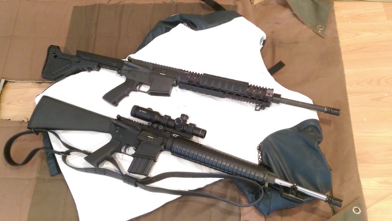

I'll see if I can get some pics of mine up. One looks like a flat top A2, the other has a Magpul UBR and a YHM tube.

Thank you. The bottom rifle is almost exactly what I was looking at building. You answered main questions if I can run the flash hider with a 20in barrel. So if I decided to use a quad rail design it has to have all the rails on it so keymod and stuff like that are not allowed?
