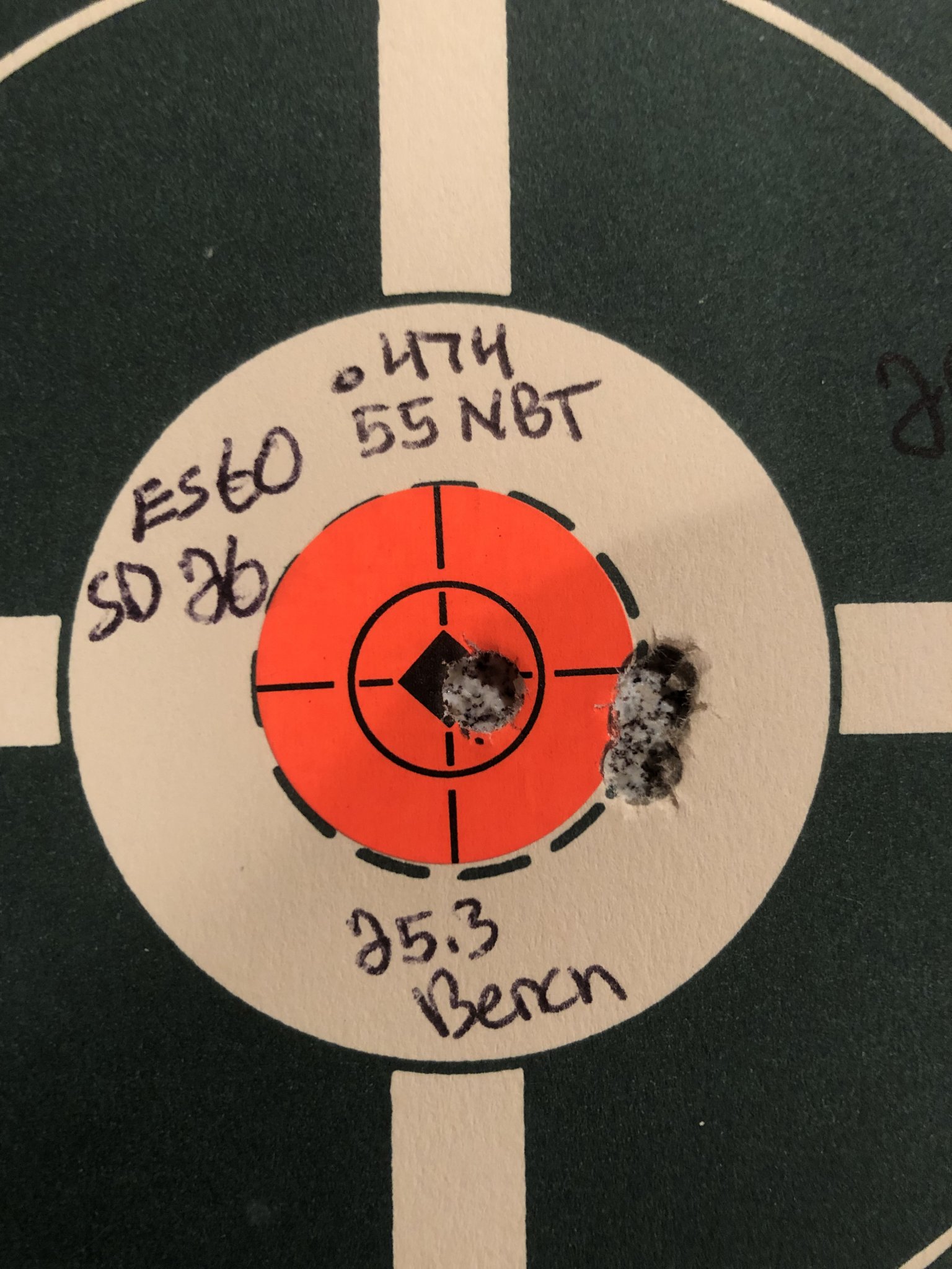

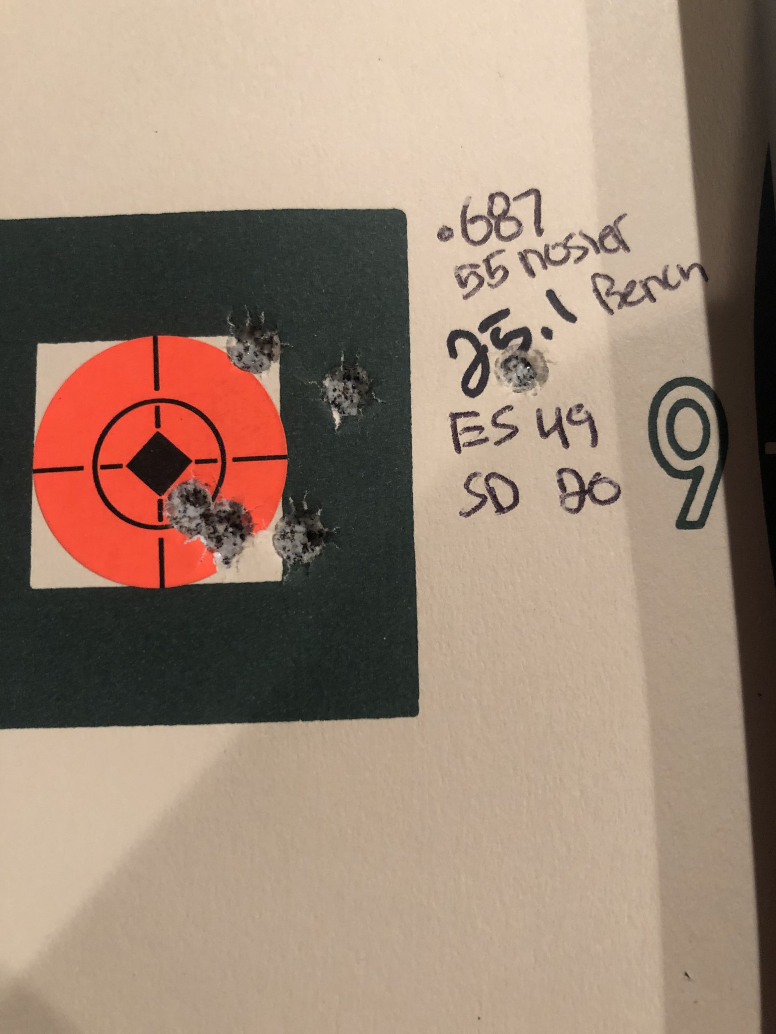

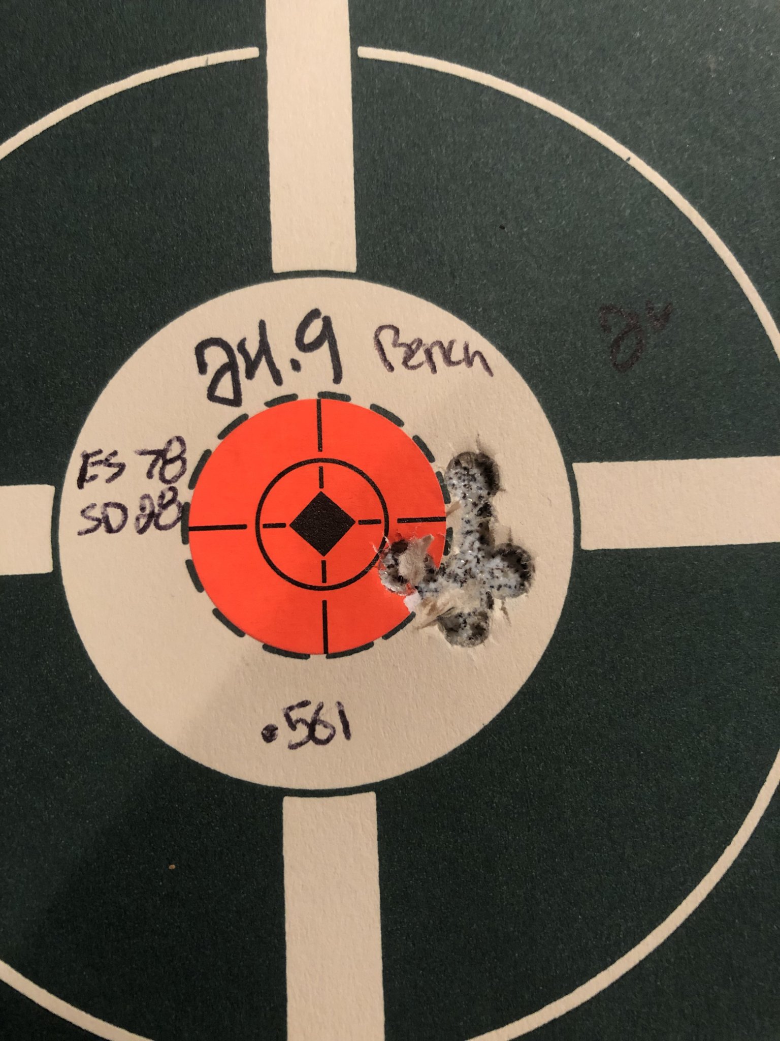

I have a 16”. Craddock barrel and found an accurate load of benchmark and 55gr Nosler BT but it has horrible deviations .... like SD’s In The mid 20’s to 30’s. This same barrel shoots 75 grr BTHP extremely well .5-.7 5x5 with SD’s in the low teens but I am using 8208 for the 75’s. Is there a better powder you guys have found that works for the 55’s that give accuracy and good deviations ? I’m using 13 LC brass and BR4 primers, this rig is primarily for predator use and would like to find a varmint bullet that shoots well. I have shot 50, 53, 55 and 60 gr bullets in Hornady , Sierra and Nosler. The Nosler 55’s have shown the most promise.
Try magnum primers (CCI 450's/Wolf/Tula). For 223, they tend to provide more consistent ignition with extruded powders like Benchmark, XBR, Varget, etc. The Wolf/Tula primers seem to get the lowest ES/SD for some reason.
Are the loads compressed or near compressed?
Reactions: NVScout
This... Tula/Wolf and cci450 primers are very good for consistent, accurate loads. Rem 7 1/2 are okay if you can't find the above.
Haven't seen the Tula or Wolf available for a couple/few years now though...
Reactions: NVScout
Not even close to being compressed.

It’s a 16” mid length rock creek 8 twist. They are the 55 BT’s not the varmegedons. I’m using a JP silent capture and don’t recall how I have it setup spring wise. I do know I went heavy on the spring due to going into battery problems.
Normally I shoot more of the varmageddons since im a cheap ass and the BTips have become a lil expensive. But for example with the varmageddons Im experiencing SD's in the teens and I would expect the same or better with the BT. I would bump up your charge a few tenths provided you havent seen any pressure signs yet and seat them as long as you can in the mag. With benchmark and my 16" RRA I'm running 3000 fps. . Im where your at and go up to 25.5 grains. IMO a magnum primer is not needed and dont crimp, that increased my SD's in a test.
I went higher but it started to open up at 25.3 . I’m going to run a depth test Next time out and will go from there. I was just mainly curious if other powders might have a better outcome

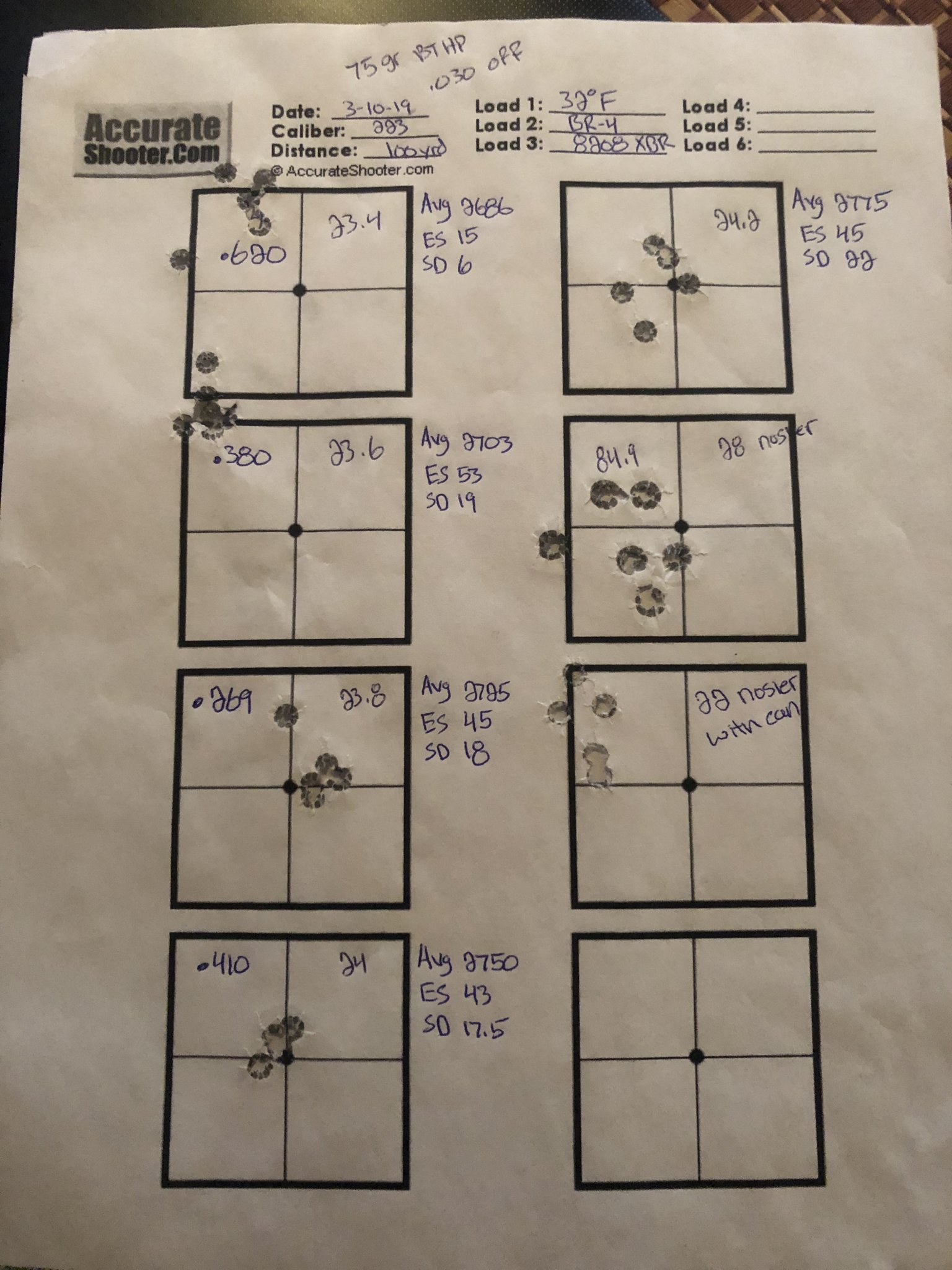

BR-4's and 9fps SD's in a string of 5 shots. LC or NT (Lapua) brass. The powder meters really well...
It's a warm load, but performed well in the summer heat of the prairie dog towns, without any flattened primers or other pressure signs.

I ended up doing a primer test with 205AR, 205M, BR-4 and 450’s. The BR-4 was the winner but still poor spreads and inconsistent accuracy with the 55’s. I went back to the 75’s and decided that they just work to well not to use.....
