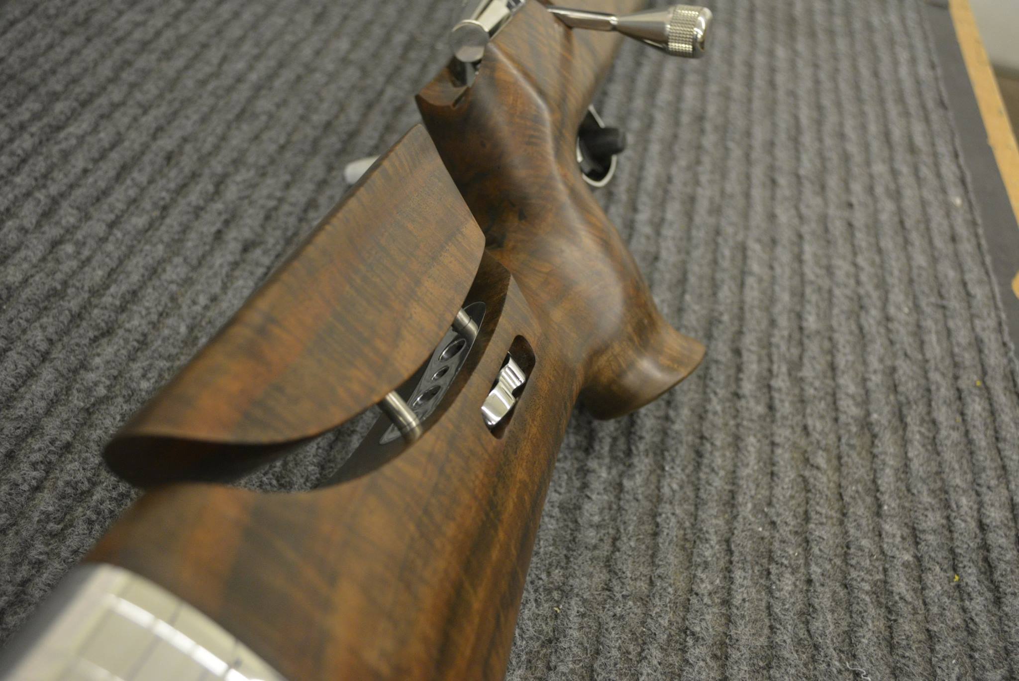

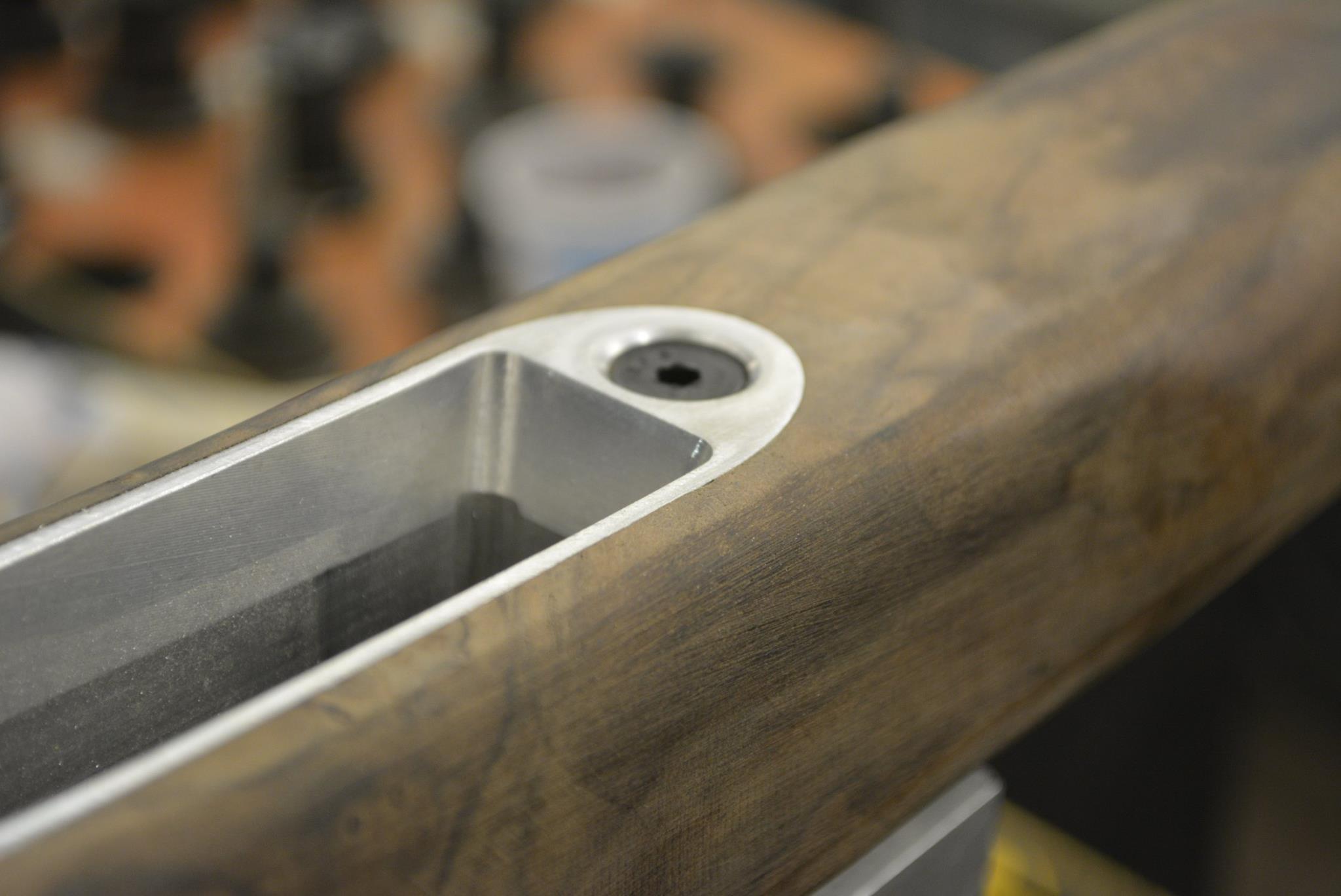

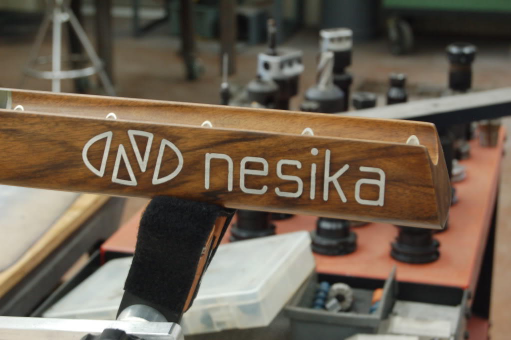

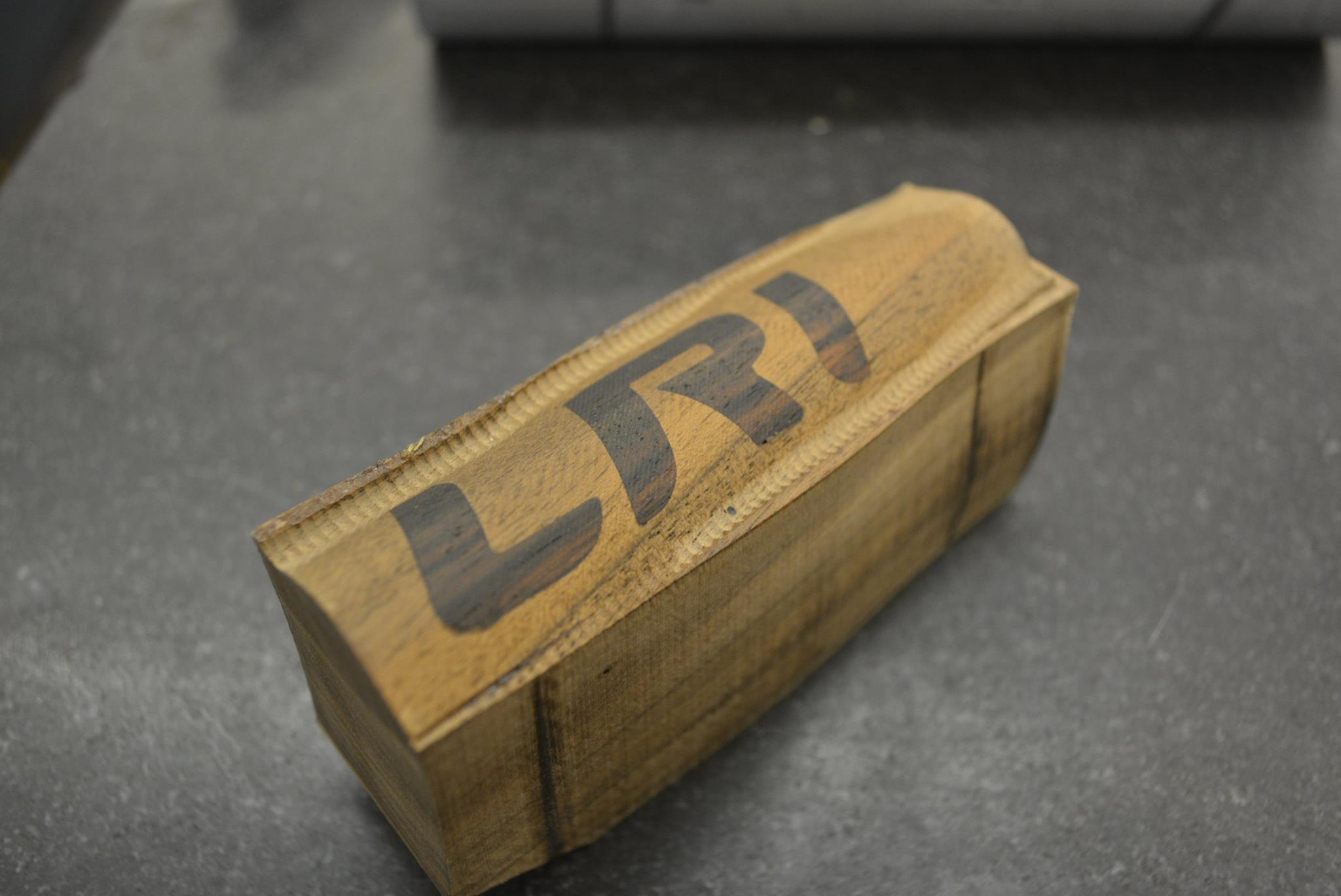

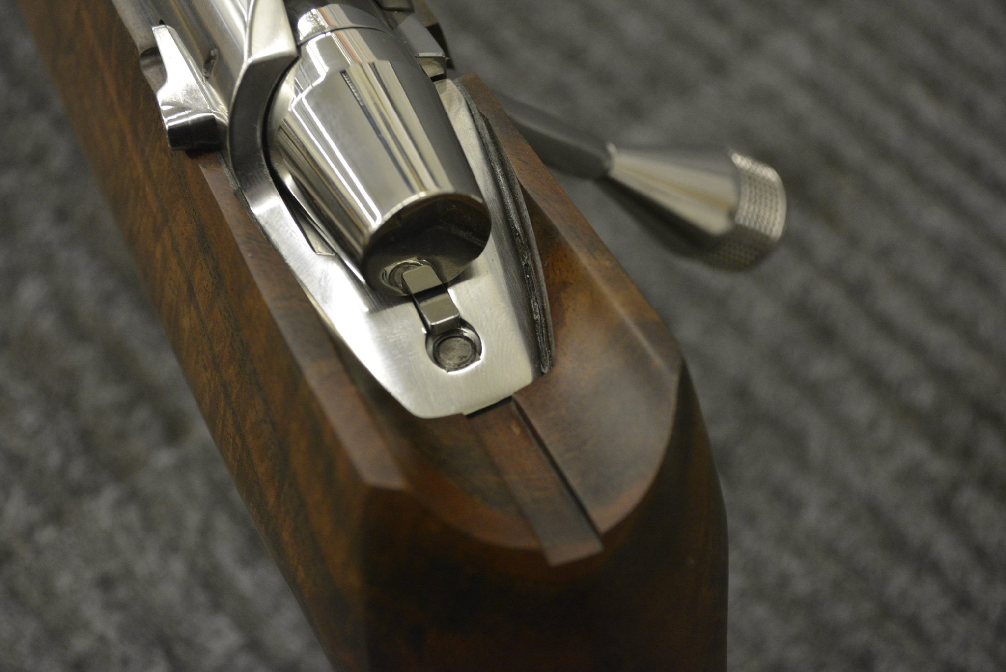

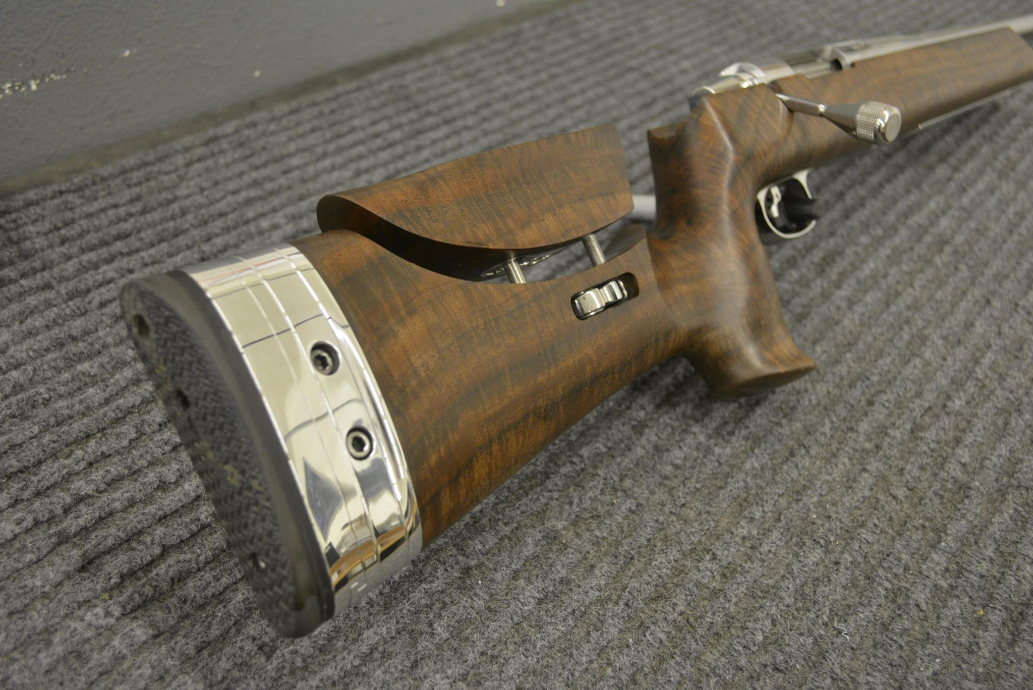

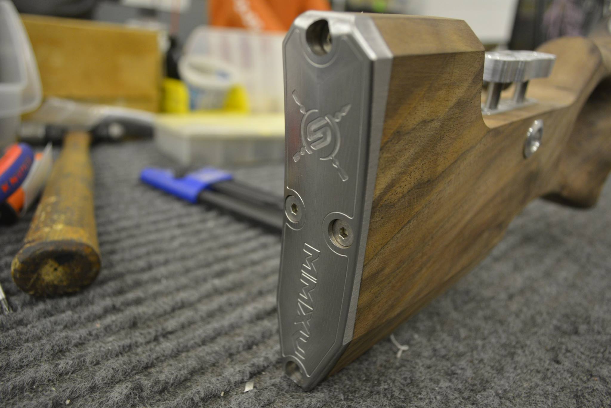

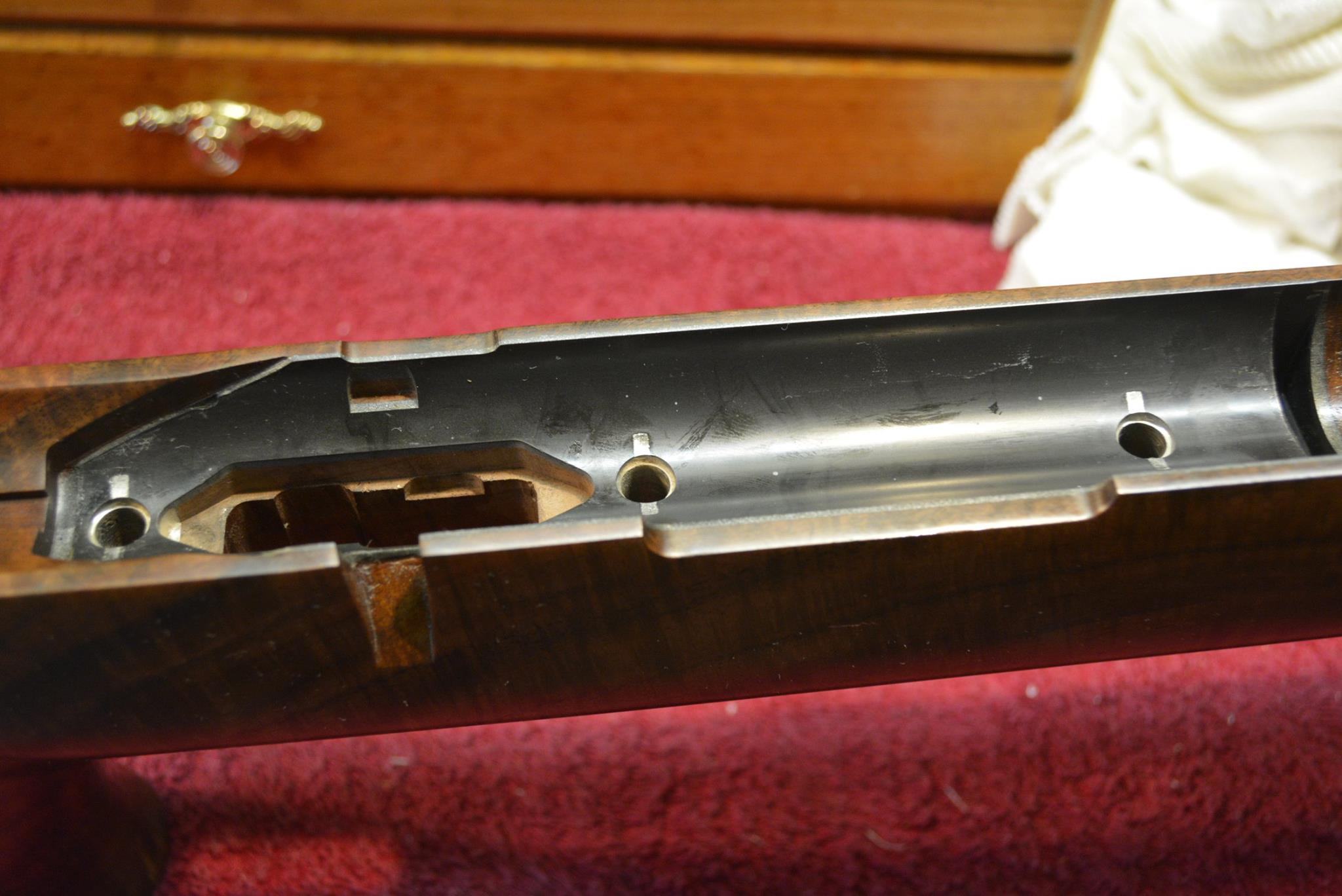

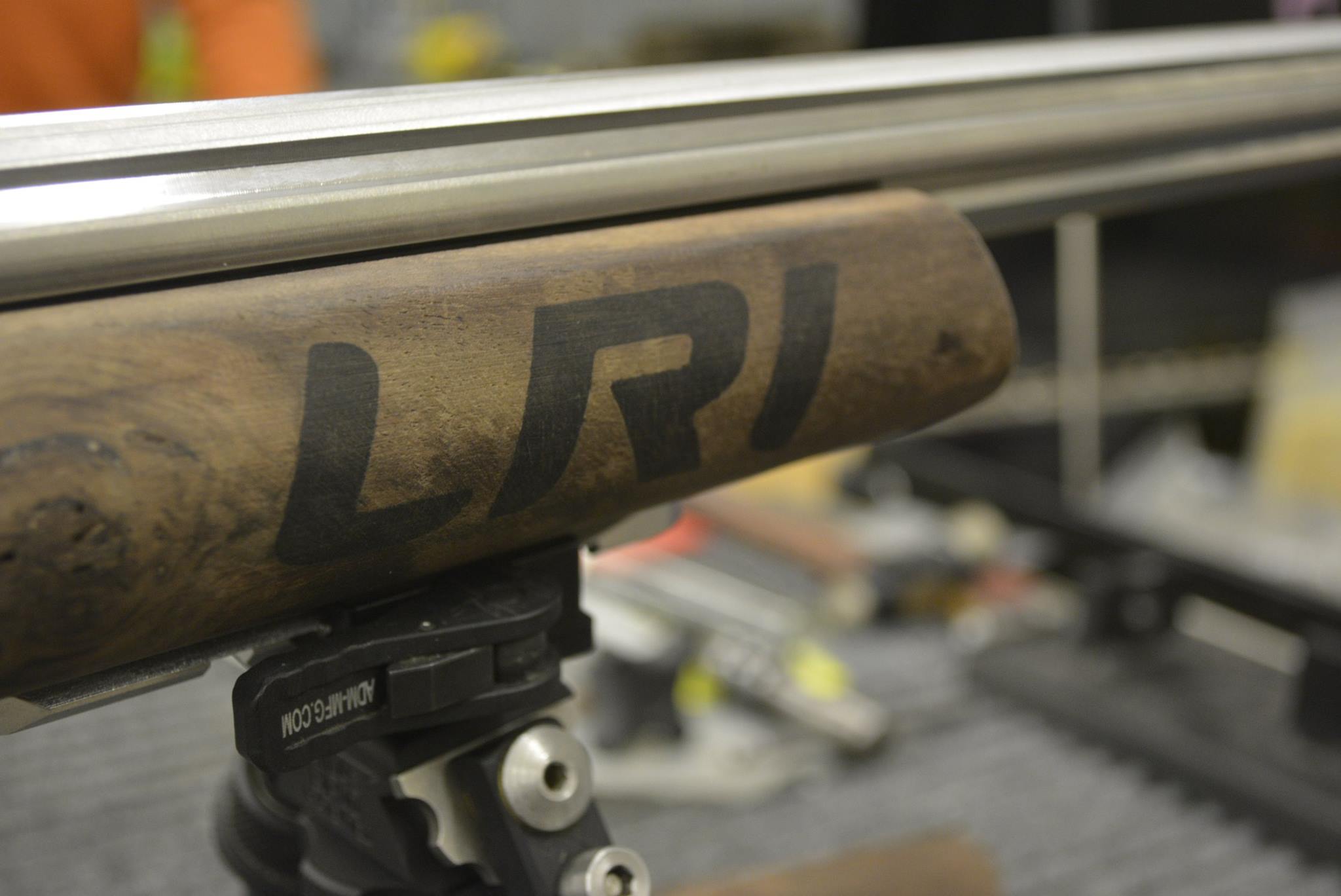

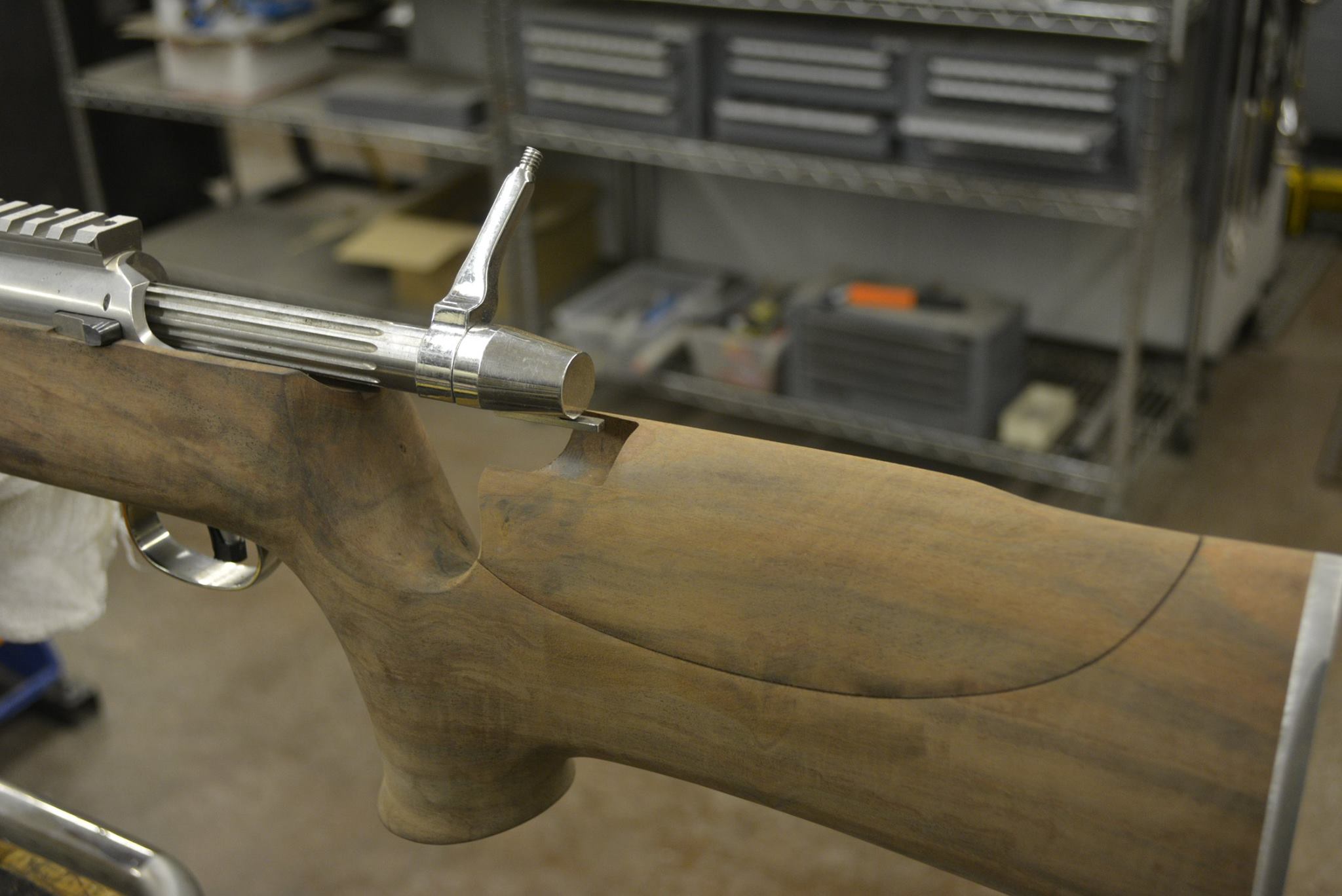

We can do it. We make our own stocks in house along with most of the peripheral hardware.
Be happy to help.
