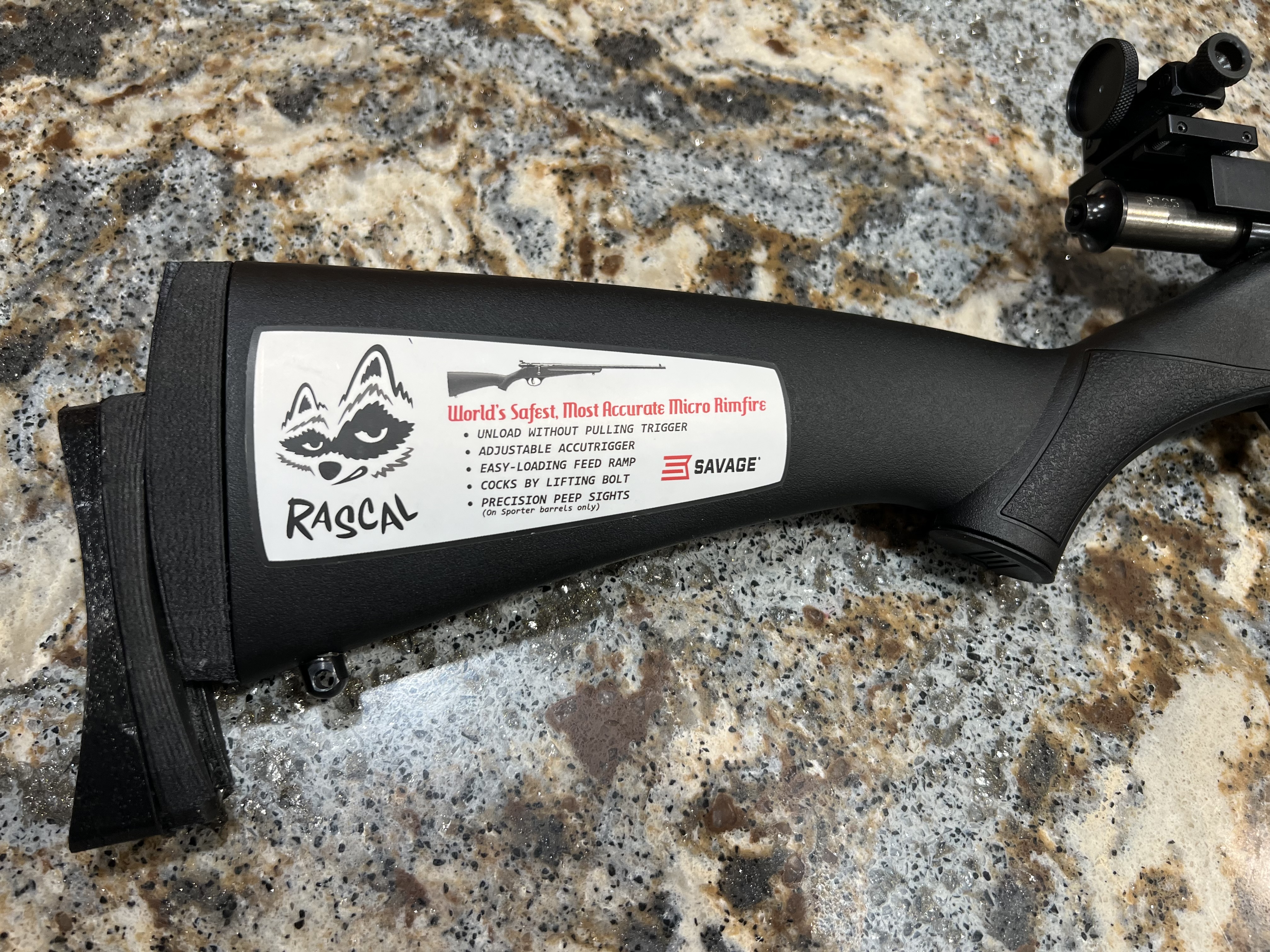

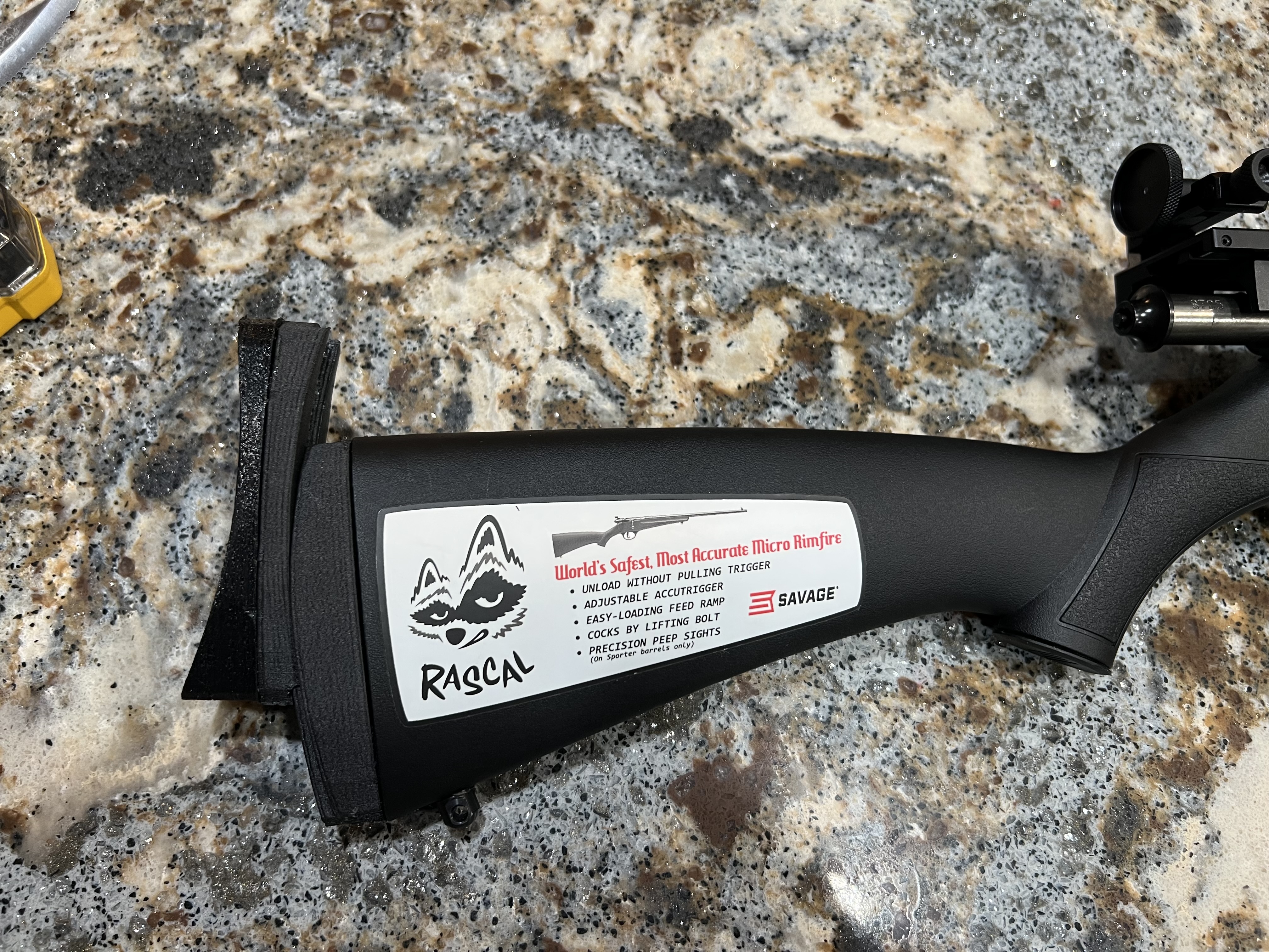

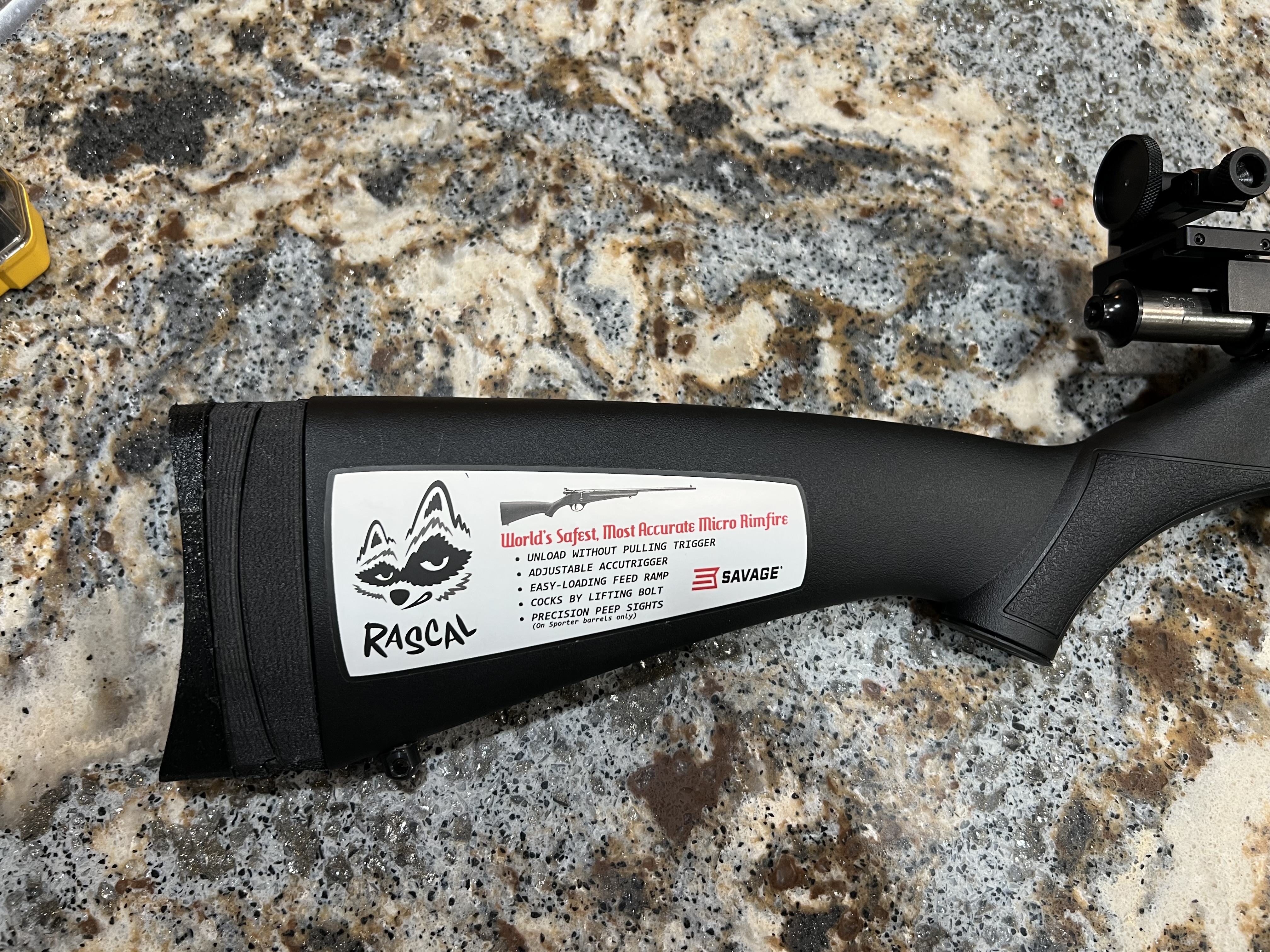

I was able to add an adjustable butt plate to my daughters rifle along with globe sights. Nice starter rifle
