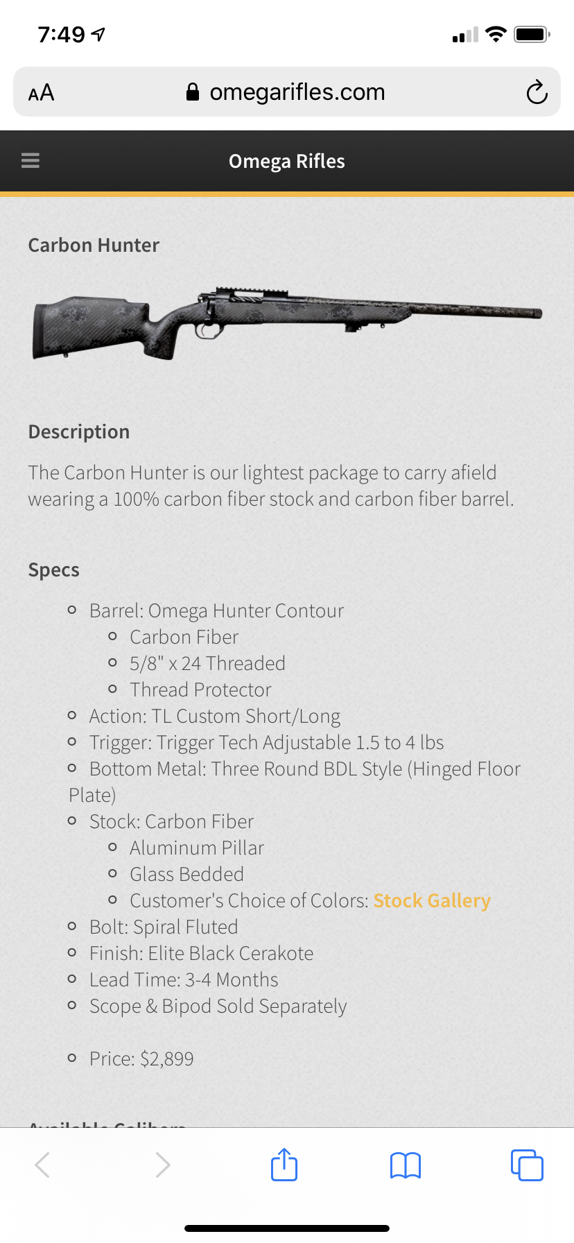

I’ve got a custom 6.5 with AG composite stock. I bought the gun used and it’s got a hinged floor plate ... I really dislike floor plates and prefer a detachable mag.. it has been inletted .. would it be possible to convert to a detachable mag ?

Not sure what style but here is the gun I bought . I got it used so I’m not sure what stole them floor plate is. It looks similar to my Remington 700 floor plate .

Good news is that’s a BDL inlet. The Badger M5 inlet is the standard one for using AICS magazines, so I’d recommend going with that.
As far as where to get it done, Badger inletting is $75 but the bottom metal is pricey. I’d call up Altus Shooting Solutions and ask about having them inlet for and supply Hawkins M5 bottom metal for you.

Usually inletting for a DBM is a simple job but I'm guessing the carbon fiber stock is going to be your problem......... I tried opening up a barrel
Channel on a carbon shelled stock and had lots of problems with chipping the surface layer.
Seems to me that rifles selling point is the light weight......id sell the whole thing and build exactly what your looking for, now that Bartlein has entered the carbon wrapped barrel game there are more options plus McMillan or manners can build a light weight stock inlet for a DBM out the gate....... lots if action options as well.

Is the action on your rifle a remington clone? Meaning round bottom and same action screw spacing as a remmy. If so, I can do it no problem. I can also recommend Badger Ordnance's inletting service as well as Jeff Hayes at River's Bend Gun Company.
I hope you are able to get it taken care of.
Edit - Quick google search.....looks like your rifle uses a Gunwerks GRB action......so its a remmy clone and easy conversion to an M5 inlet.
