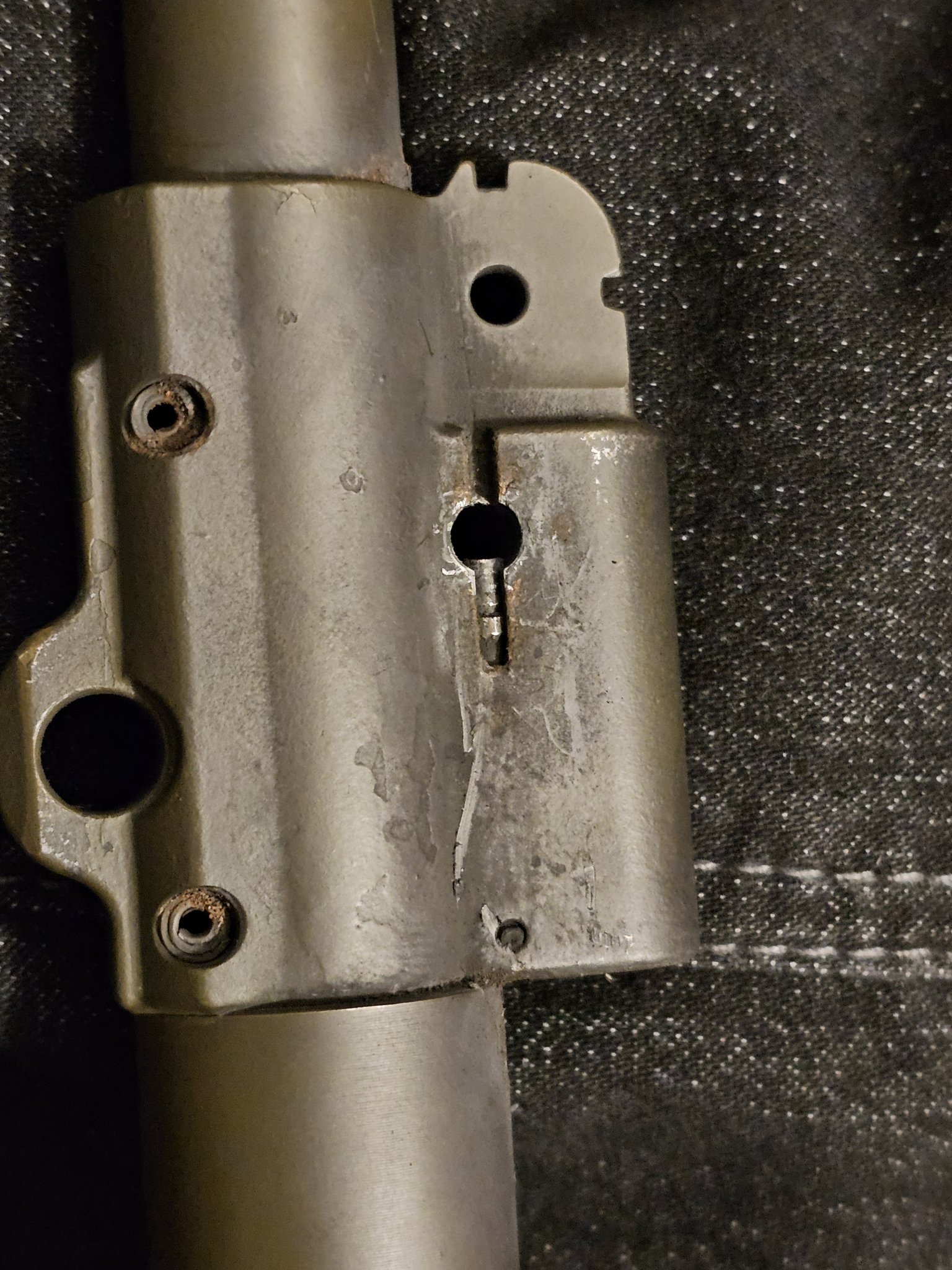

    While my HK MR223 runs very smoothly with my 75g3/24.4gr N540 load with the legacy suppressor, it has plenty of gas running factory 55gr bulk ammo.

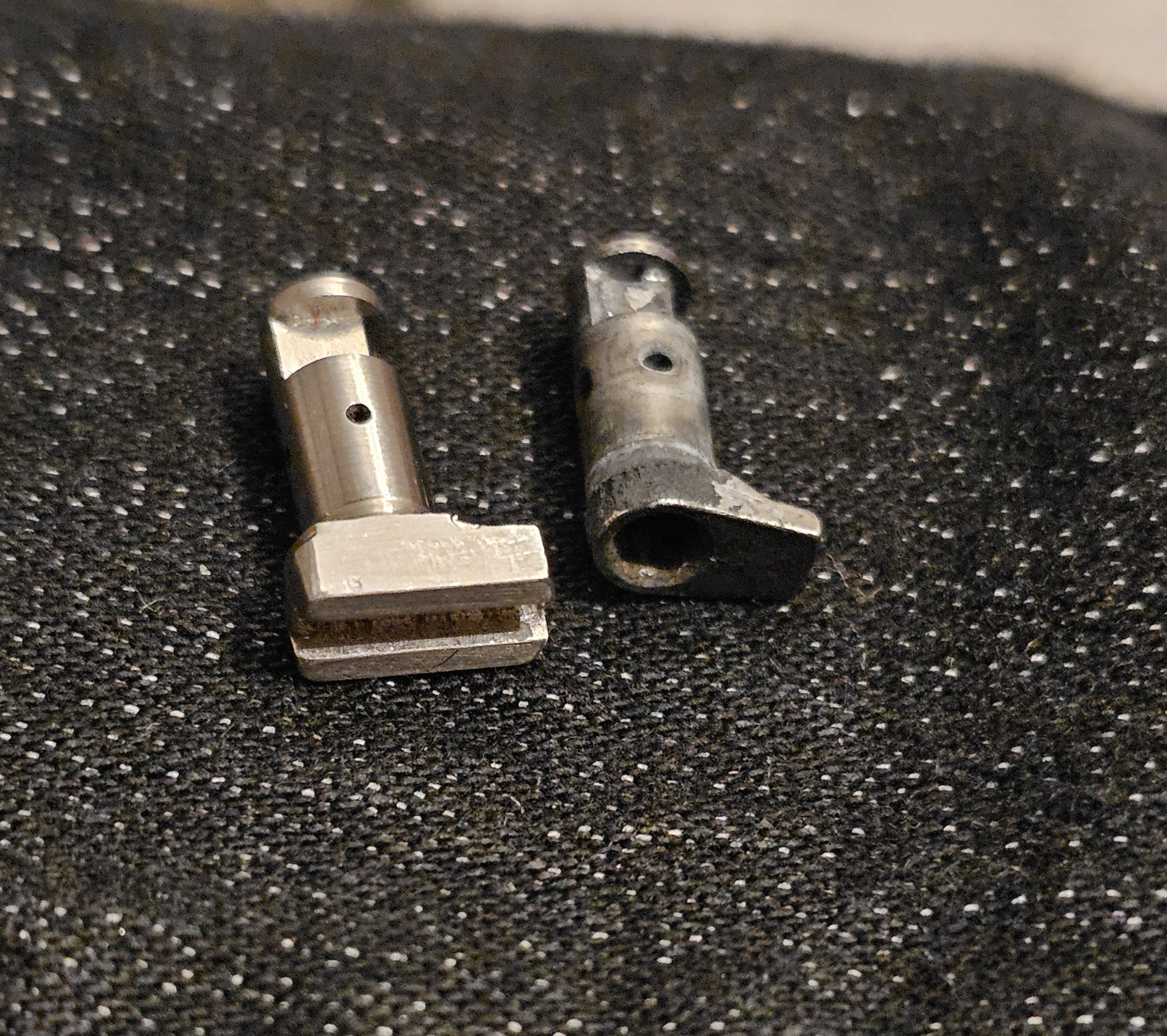

    Fortunately my gunsmith noticed that the adjustable HK gas block can be easily hand-fitted with a replacement gas port made by him. He could not make the new one operable with a hex key, but the slotted should work ok.

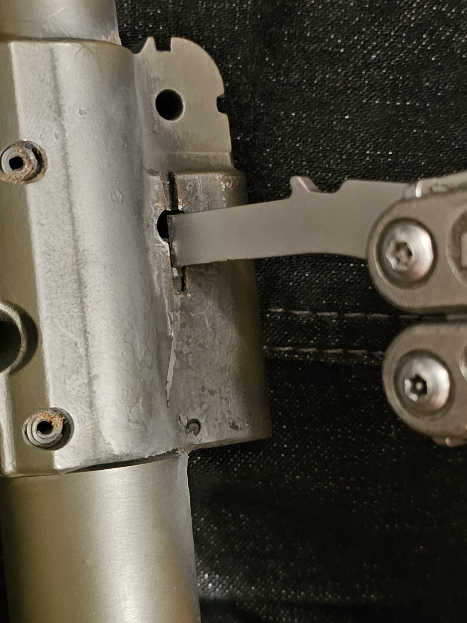

    You just hold the metallic bolt open, pop out the old one and pop in the new one.
    So far the new one still has too small holes, I inted to try out these two port sizes and record the bolt movement with slo-mo to make the best port sizes. Too bad I cannot get 3 settings into it to make:

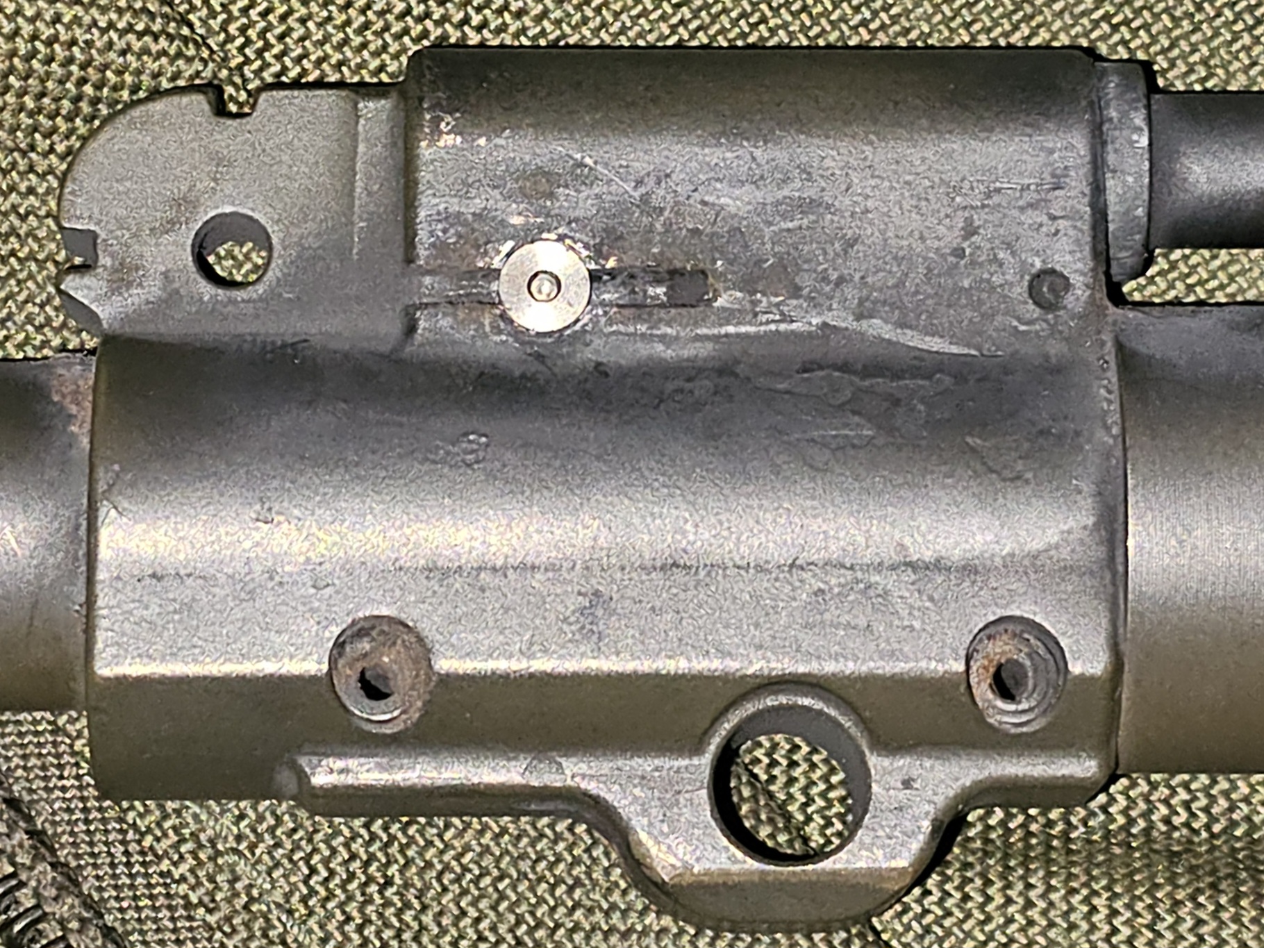

    It worked phenomenally well without any modifications, ejecting brass to 2:30 and 3:30 o'clock with the can on. The low setting was very smooth to shoot but still bolt catched onto an empty mag. The normal setting will most likely run the gun without a can.
    This is a must have improvement to have if you already have the 2-step adjustable ("Norwegian") gas port as it costs very little.
    Not all factory ammo is as gassy, but especially the 55gr Geco bulk which I have stacked on..
    Looking forward to modding it but getting it tuned will take some trying. I remember 1.1mm /0.043" being just around to get it to cycle with reloads suppressed and 1.4mm / 0.055" to work without suppressor.
