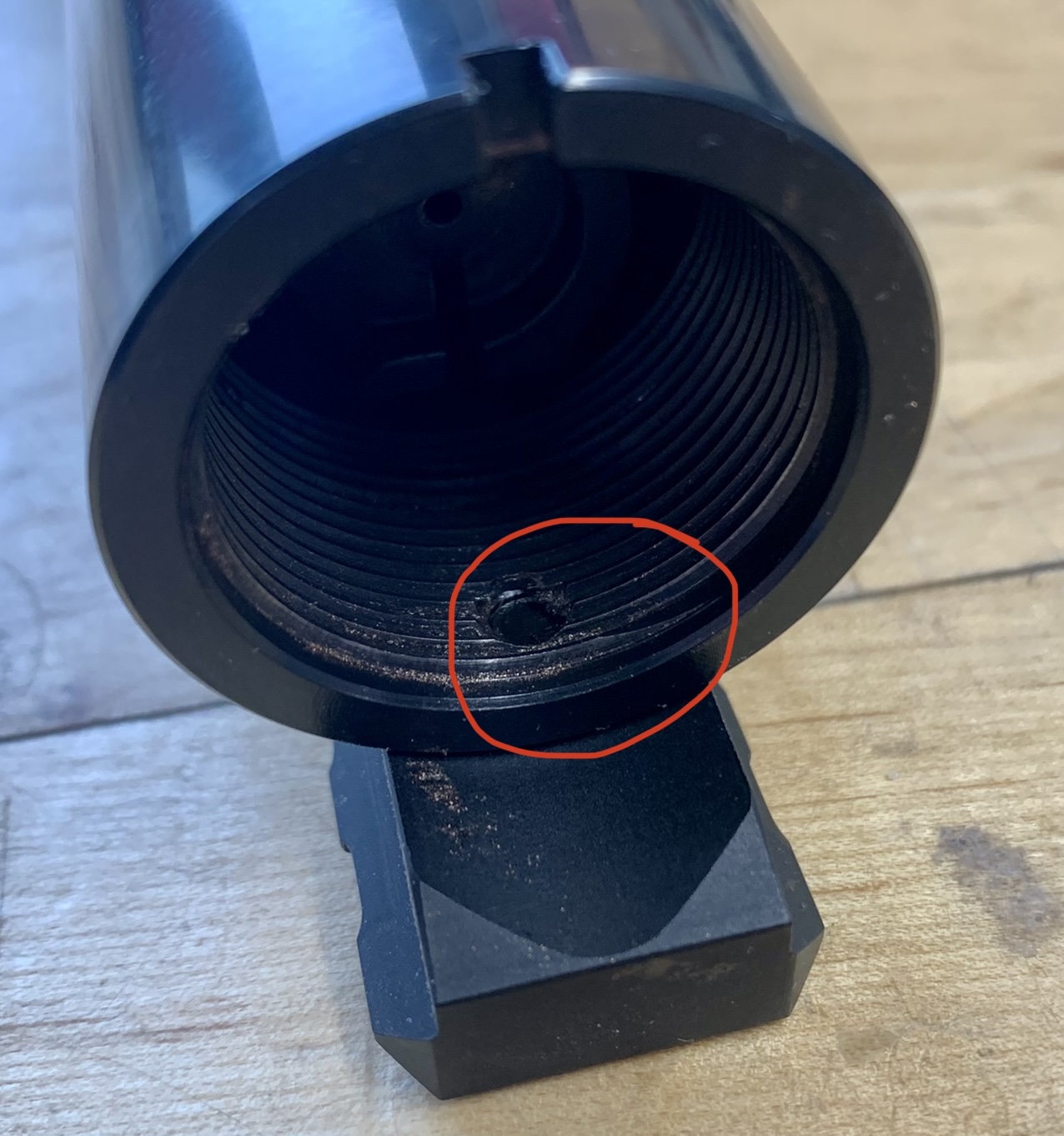

I recently picked up a bighorn origin as a backup to my bighorn TL3. I also got one of the Hunts long range recoil lugs for the Origin so that I could use my TL3 barrels on the Origin. I have not shot the Origin yet, but I have installed a barrel on it with the HLR lug and the barrel does not index the same as on my TL3 and seems to have a shorter headspace. I can still chamber brass fired from my TL3 in the same barrel mounted on the Origin, but it is much tighter that when the barrel is mounted on my TL3. Does anyone have any suggestions on how to get these two actions to headspace the same?

TL3 thread start is at 6 oclock. Here’s an Origin(inverted), showing the 12 oclock
start.
Reactions: BCX

Thanks everyone for their replies. I did not know (and didn’t even think to look) that the threads for each action start in a different location. I knew the headspace was very close between the two but I did not know how close. Again, thank you everyone for your info!
