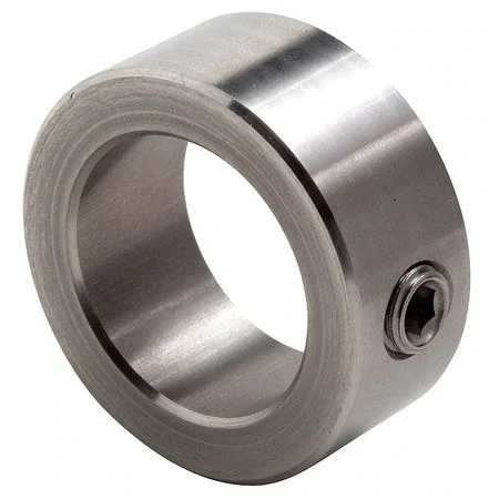

Recently I found the joy of using set-screw shaft collars on one of the riser posts. They cost about 3 bucks and can be easily adjusted with an allen wrench. I use the Loggerhead risers and they have 3/8" posts. Others I've used have had 5/16" posts. Measure and find one of these that fits:
Reactions: sanddanw

On price: If you're worried about $3 per multi-thousand dollar rifle...
On tiny screws getting loose/lost: Doesn't happen. Shaft collars are made for... well... shafts... used in industrial applications where things are in constant motion. They are set and forget and don't come loose.
On another allen wrench: An allen wrench set is part of my range toolkit - should be a part of everyone's. Not an issue. Besides, as mentioned, they are set and forget.
On o-rings moving: If you can put an o-ring in a detent, then great - it won't move. I have to raise my cheek riser above where the detents are. O-rings definitively would not work for me as there is nothing to stop them from moving along the post.

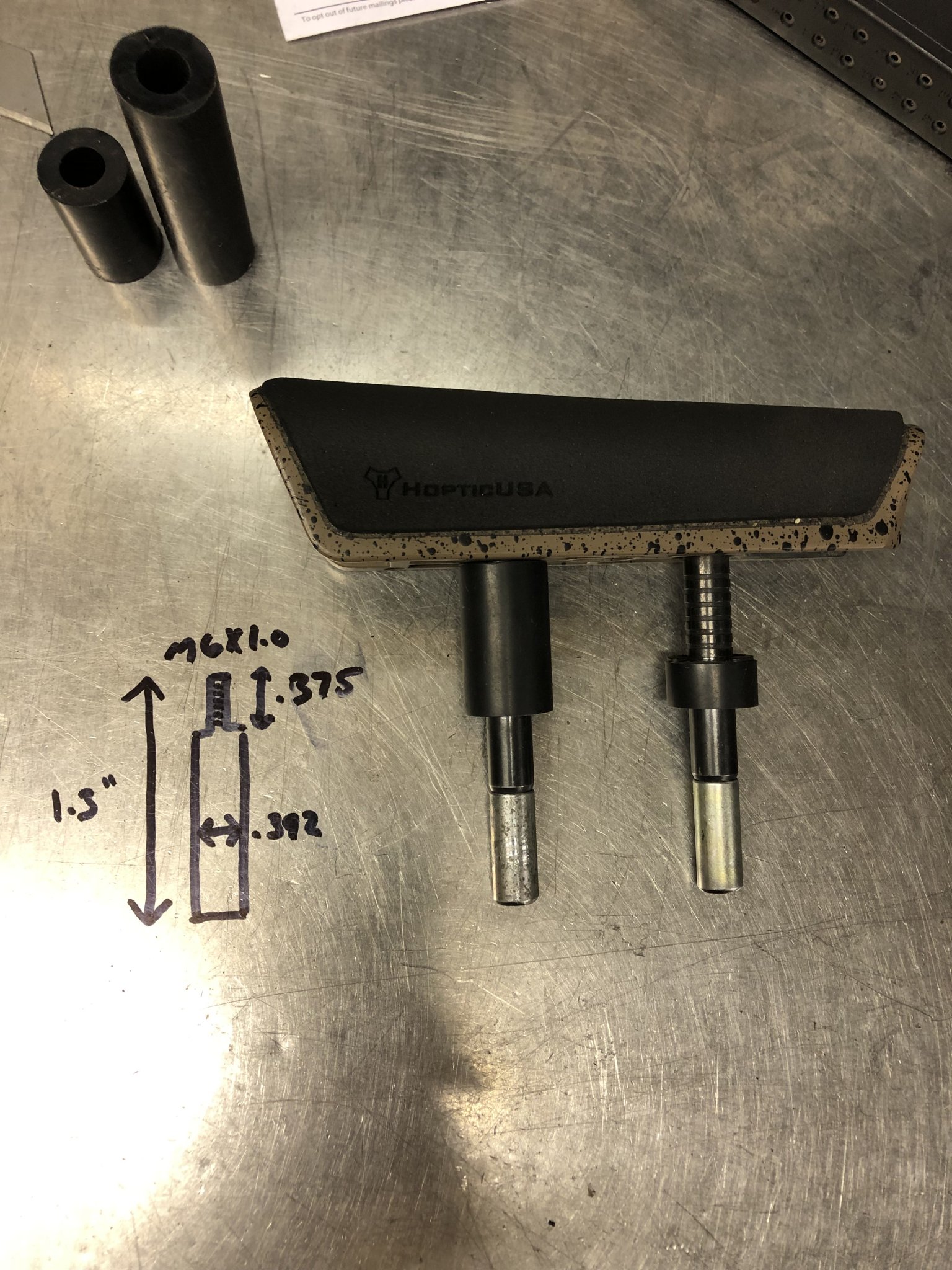

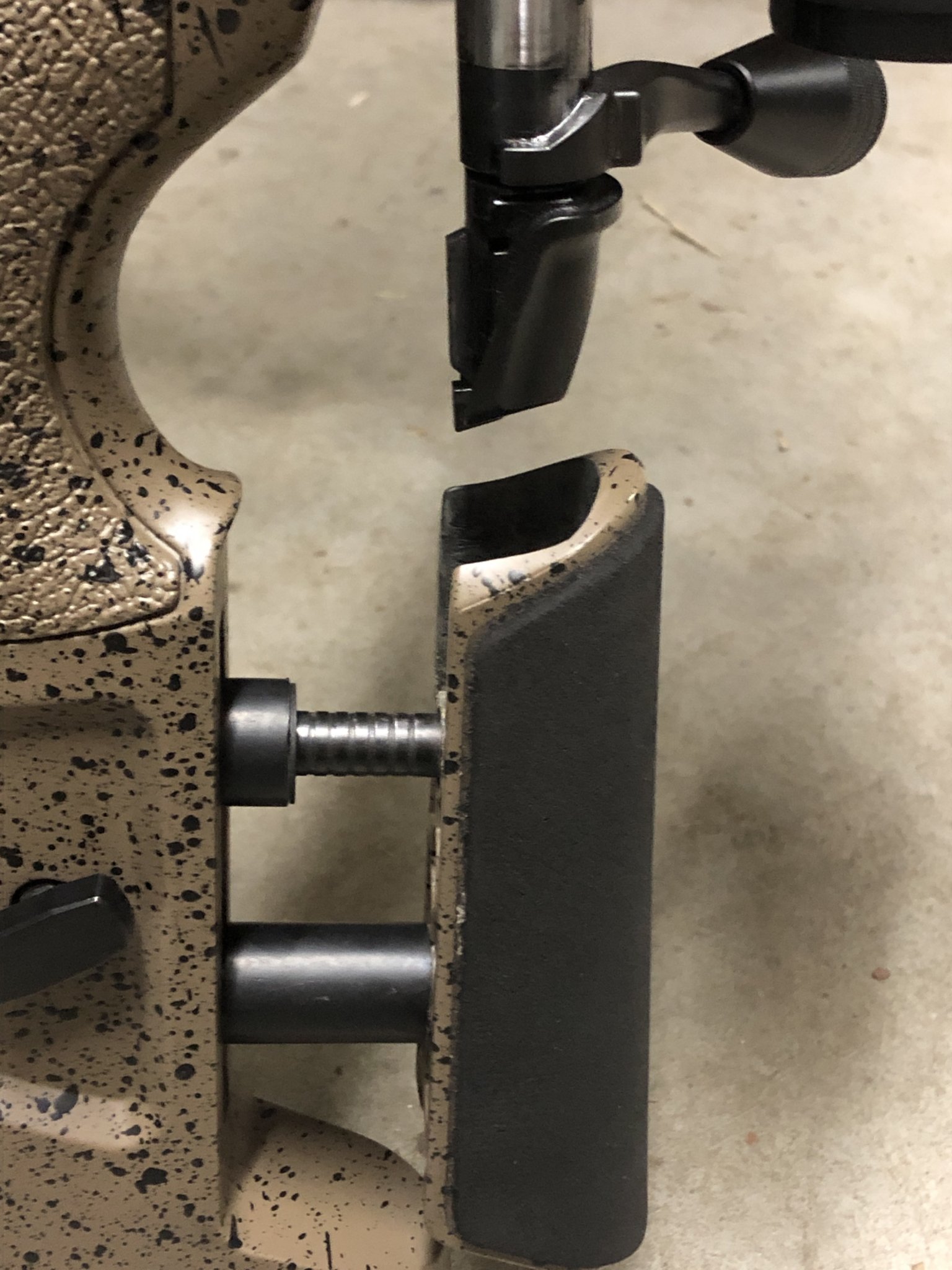

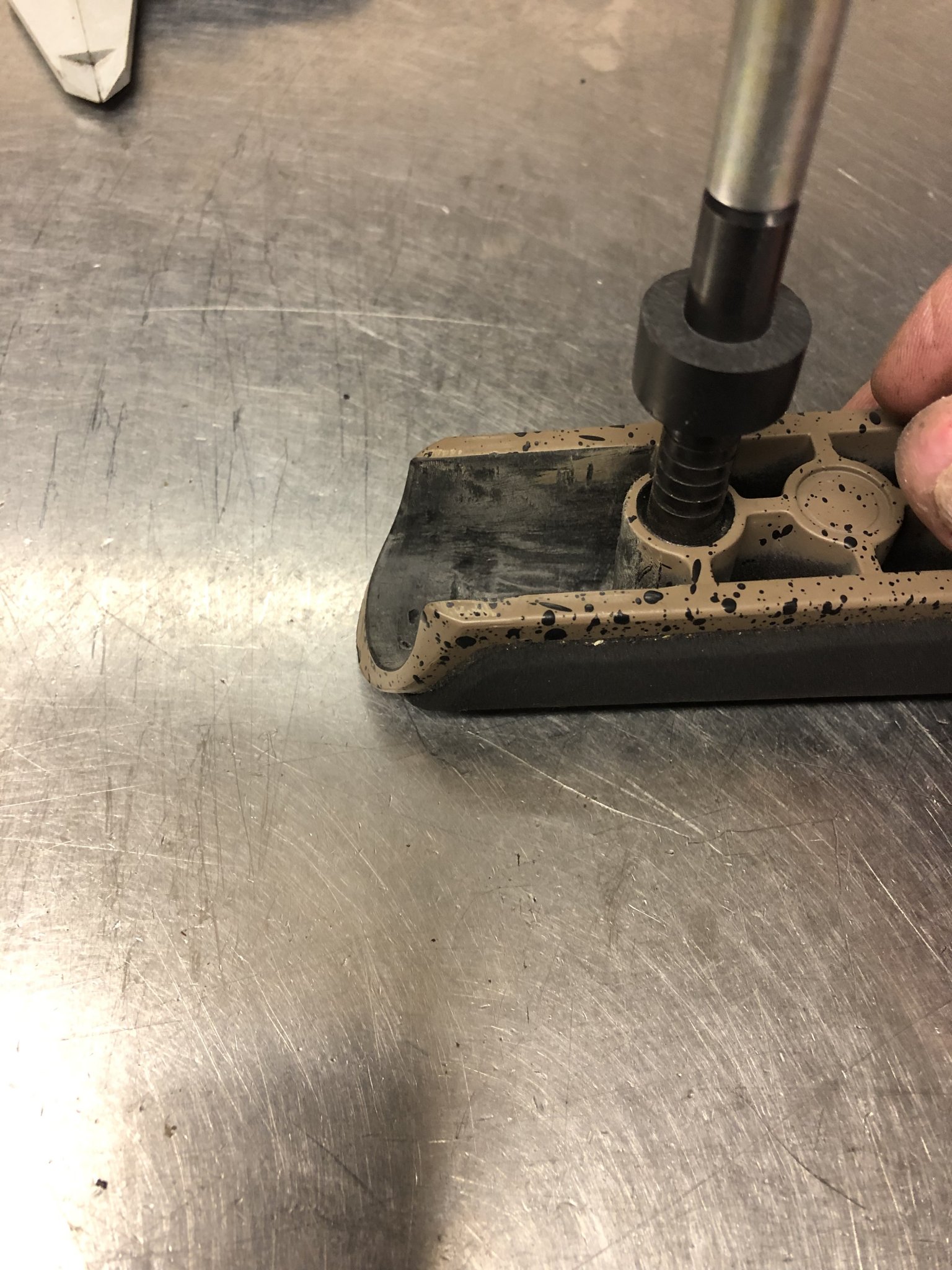

Bringing back an old thread, I just finished cutting mine out tonight to get the bolt out without removing the riser. I also used an e clip and some delrin I had on hand (that was magically the exact size I needed) cut and sanded down to make it level. With the rings and base I have I needed more length on the legs for the risers because every few shots it would work loose. I happened to have some Subaru valve cover bolts on hand that were the perfect OD and thread size. (once I cut the head off and took a little length off the threads.) Aside from some finish work on the cut out, it works perfectly now.
