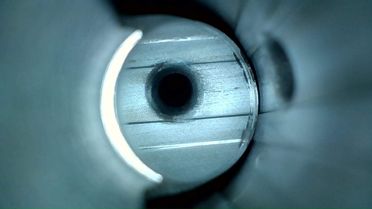

I have a 12.5" "suppressor optimized" Hodge barrel. I tried looking for the flutes using a bore scope, but my barrel is dirty, and can't see anything like it. The only thing I can note is that the gas port is centered nicely.
Had heard that this might be part of the special sauce. 0/3 of my Hodge barrels have the port centered in the goove. Schatz always said that HK did this with the 416...I've seen some that are, some are not.

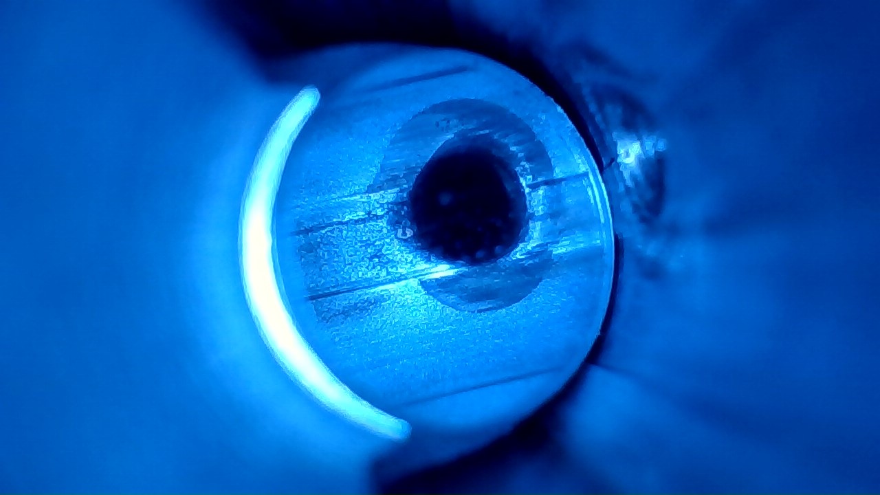

Since the gas port in the pic that R.O.U.S posted isn't actually centered in the groove, it's far more likely that it was just the luck of the draw that the gas port on that barrel doesn't impinge on the lands. Here's what the location of the gas port looks like when a barrel manufacturer "does the math" to insure that the gas ports on all of their barrels are centered in a groove.

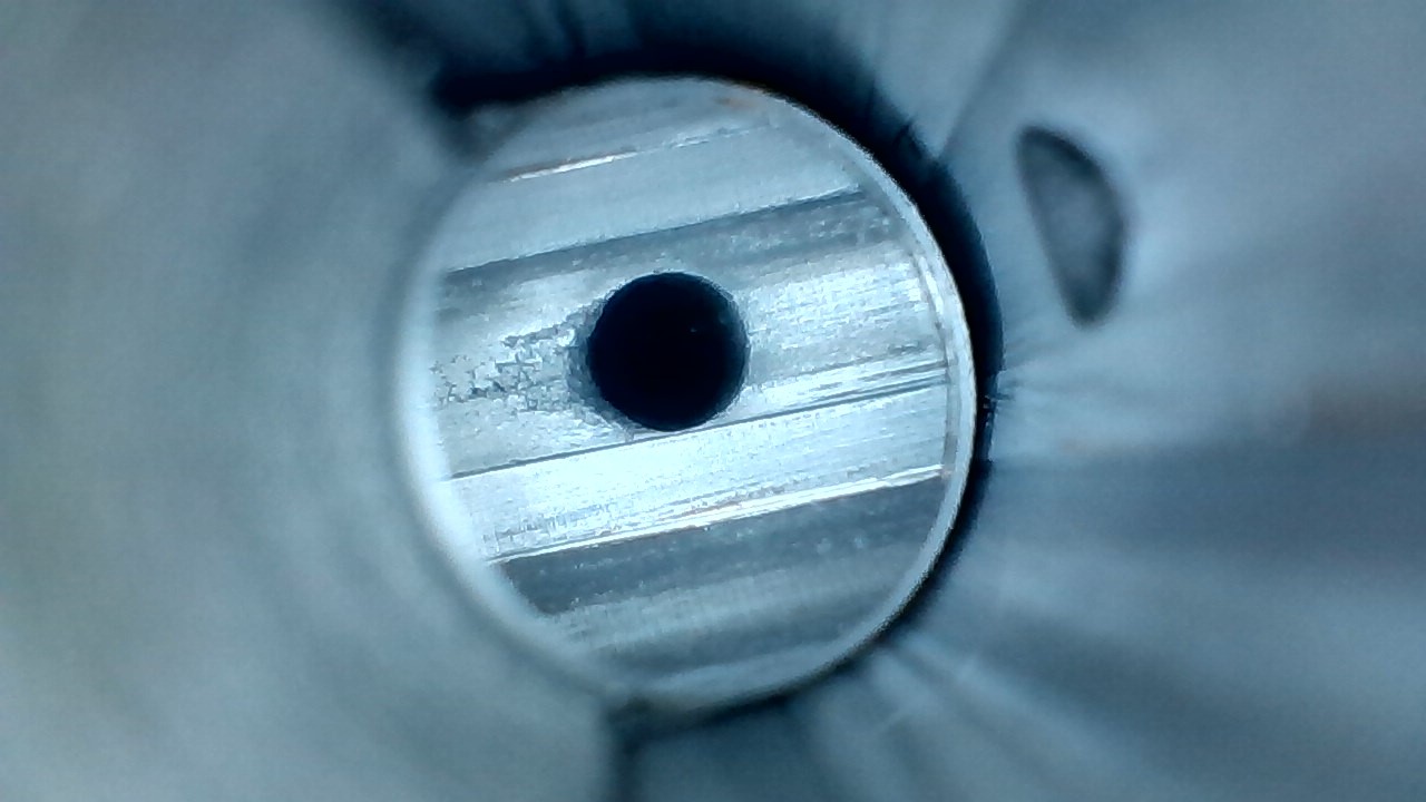

That's tiny...here's one in an HK M27 barrel:
And here's a 14.5" 416 for comparison:

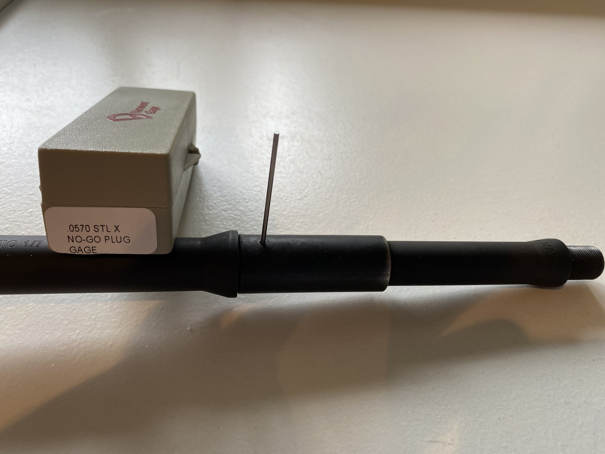

I tried unsuccessfully in early 2019. I used my calipers to measure the port but I was getting 3-4 thousandth of an inch discrepancy based on how I held it, where I placed it, and how much pressure I applied to the caliper.
This reminds me. I need to go get a pin gauge set for my tool box.

All right. I had to buy a few more individual gauges because the gas port was smaller than I expected. The gas port of the carbine length, early 2019 Suppressor Optimized Hodge 12.5" barrel is 0.057".
I can now tell for sure that my calipers are not even close to being accurate enough after going back and forth between the pin gauge and my calipers
edit. Added a picture.
9/22/20 edit- I grabbed a 0.0575" gauge which will fit inside the gas port. 0.0580" will not fit.
