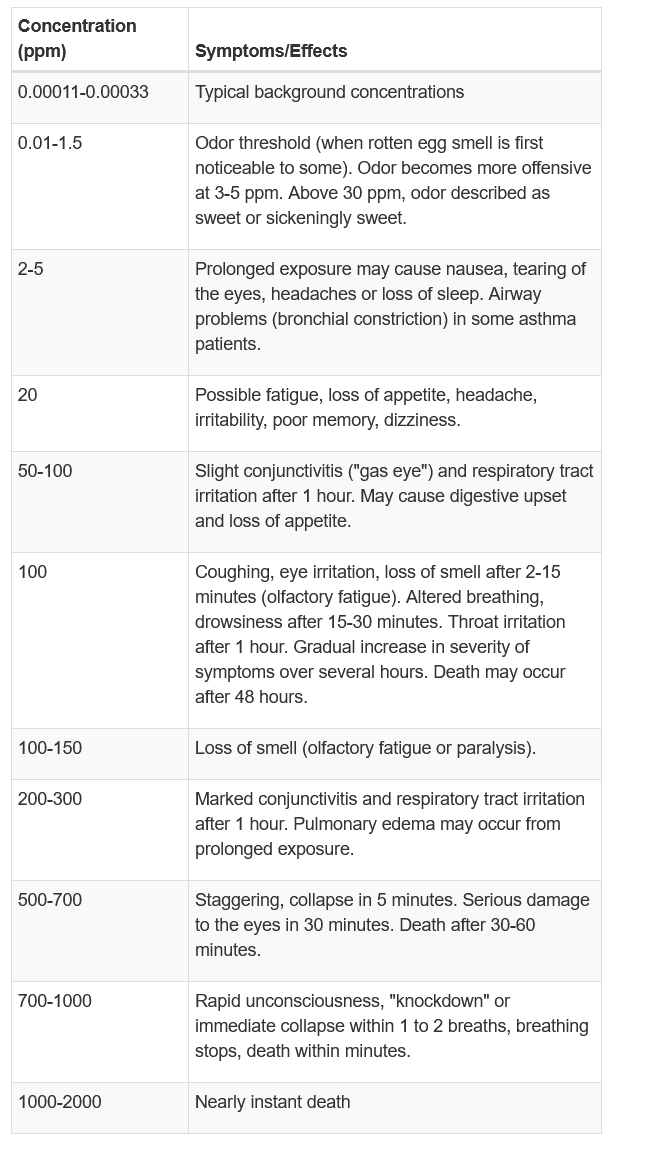

    Yall who keep talkin about your water smelling like rotten eggs.
    Thats Sulphur Dioxide.
    Yes, you can continue to smell it, it will continue to have odor, it has a pretty high threshold for being dangerous.
    Hydrogen Sulfide is a whole nother critter.
    At high enough levels, you will cease to smell it, after an initial exposure. If concentrations are low enough, yes you can smell it for a few minutes.
    I used to work in a building that had a nearly continual concentration between 10ppm and 50ppm, on the press floor.
    You lose ability to smell it...trust me.
