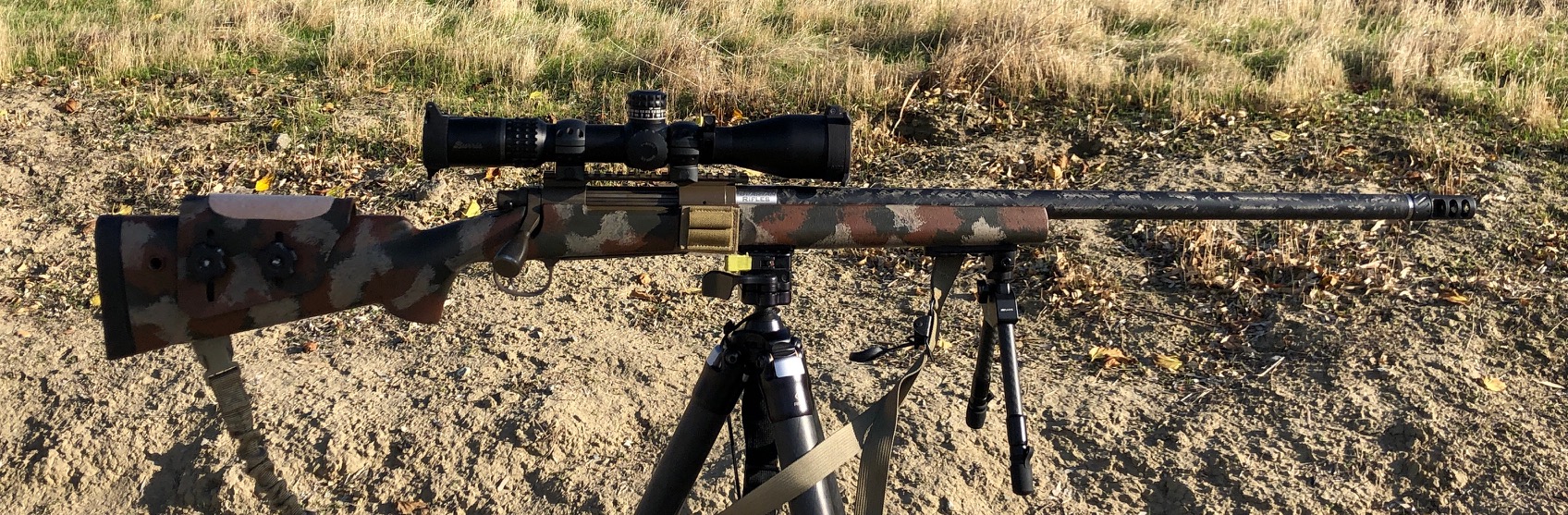

I use the RRS Anvil30 and leveling base on another and I do have one of the original Tac tables (I don't use it).. For my Match guns I run all full length dovetails. Hunting I also direct mount, but use one that has a full length, and several with much smaller plates. I've sold my Hog..

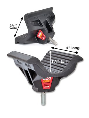

I carry one of these if I think I want to be nice enough to let a hunting buddy use my tripod that I carried all day long.. They cost $20 and I just unscrewed the post it left a 1/4 20 mounting hole for the plate for my tripod. It s MUCH lighter than caring a extra HOG

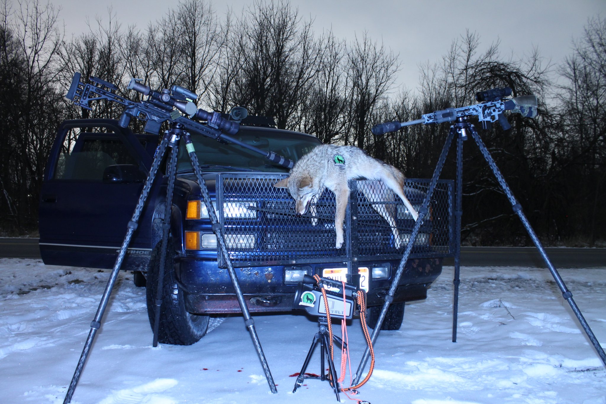

Here’s my .02 so take it for what it’s worth. i hunt and shoot from this tripod set up nearly every day. many nights a week killing predators. when i get out of the truck my rifle gets locked into the arca of my RRS for the entire set and i carry the tripod extended with the whole thing over my shoulder. i have also done this at many of prs match. after seeing many people loose their rifle or spotter out of a saddle onto the ground. after firing thousands of rounds from my direct mount system there is no comparison with a saddle. recoil mitigation included. the saddle benefit is simply versatility for anything you want to clamp. everything i have has a dovetail so for me that versatlity isnt as useful vs the solid lock up and mounting of all my guns and gear.

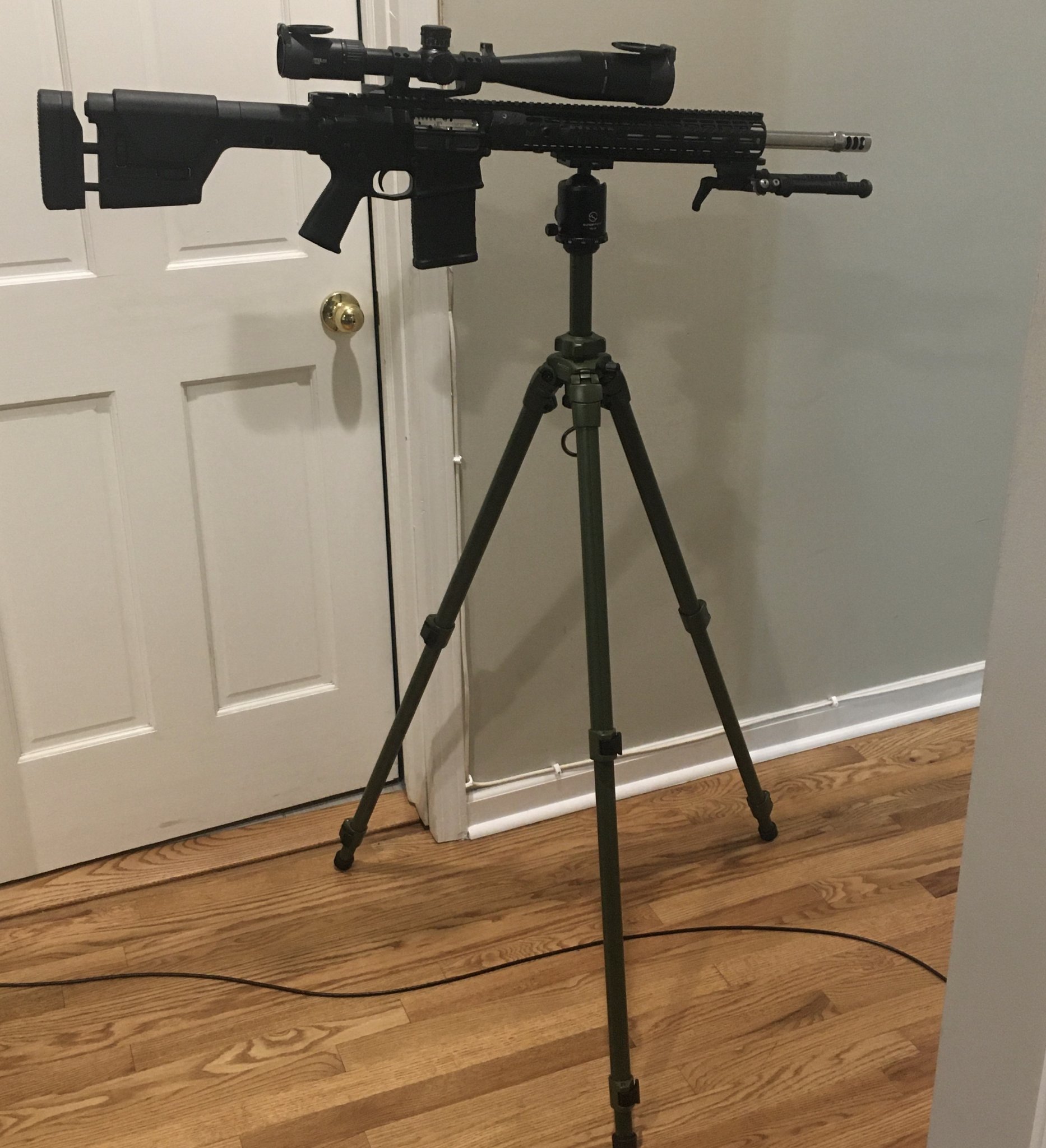

I finally took the plunge and picked up a tripod. Nothing fancy, just the tall tripod from ShadowTech and the Feisol ball head. It's stupid how stable it is whether mounted into the Arca clamp or just sitting on top of a game changer. Doing match shooting for several years without a tripod really makes you appreciate the tool when you finally get to use it. Even with this more budgetary setup, it's unbelievably stable.
If you lower the center shaft you'll get a lot more stability out of the setup.

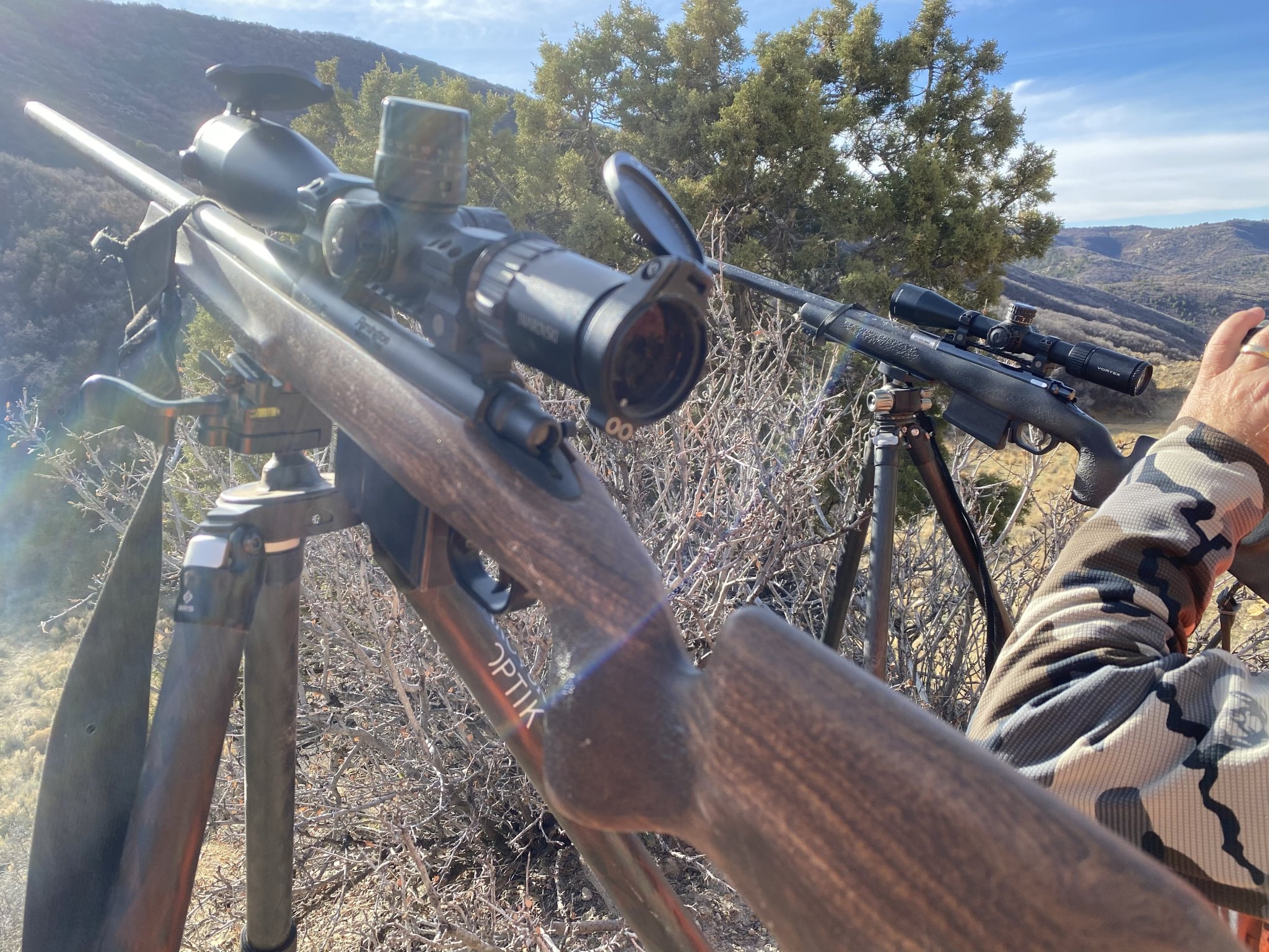

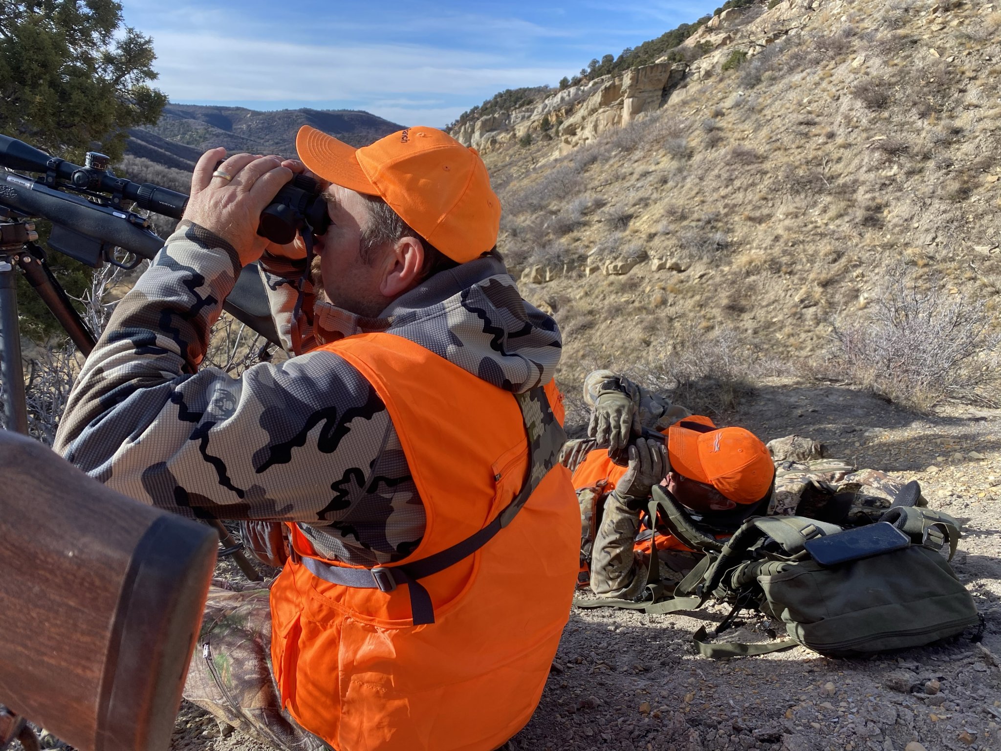

Well me laying down looking through a loop in a piñon tree, helping my buddies. No way could they accomplish this kinda shot without the rails - View attachment 7759228

I'm about to start learning to shoot with a tripod (love your post in the other thread I wish I could save it to my computer somehow) and I have a question about your picture. In a lot of videos on tripod shooting I see them tighten the lever down to maximum tension before each shot, do you do that in hunting situations or is your tension more like in your picture where it's not clamped down all the way? I'm not quite sure whether there's a balance to keep since animals obviously move and you may need to re-adjust several times before shooting to account for that.
Arca is best, but the saddle will fit more guns.
I have two tripods, one with an Anvil-30, and the other with a saddle for this exact reason. The Anvil-30 goes to matches, the saddle goes to the field.
It really depends on the situation. On this case we are tracking animals up on the ridge. In general, I only lock down enough to make a stable shot. With a magnum, especially a light one, even locked hard you’ll have to relock to make a follow-up shot. It’s faster in the end not to lock it out completely.
