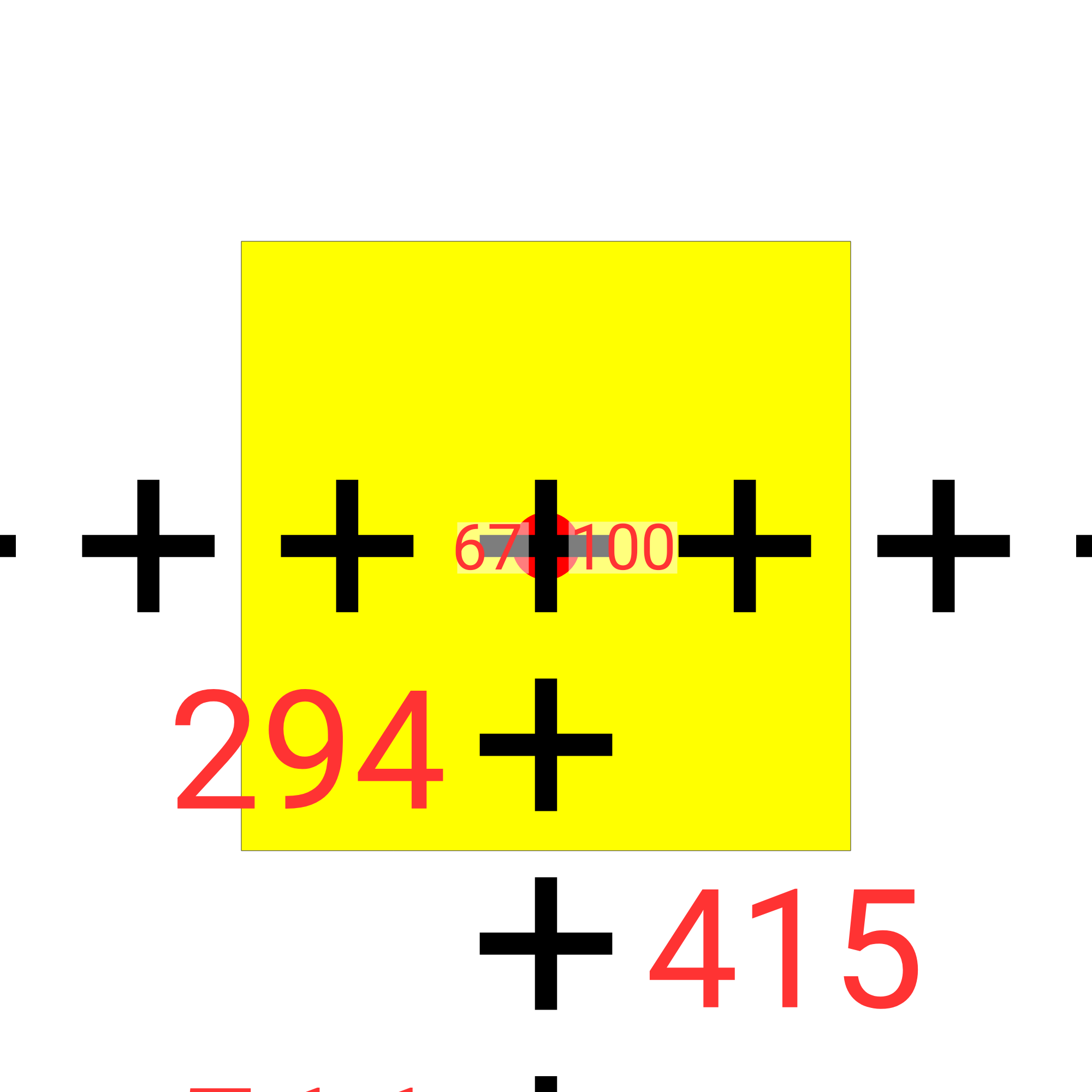

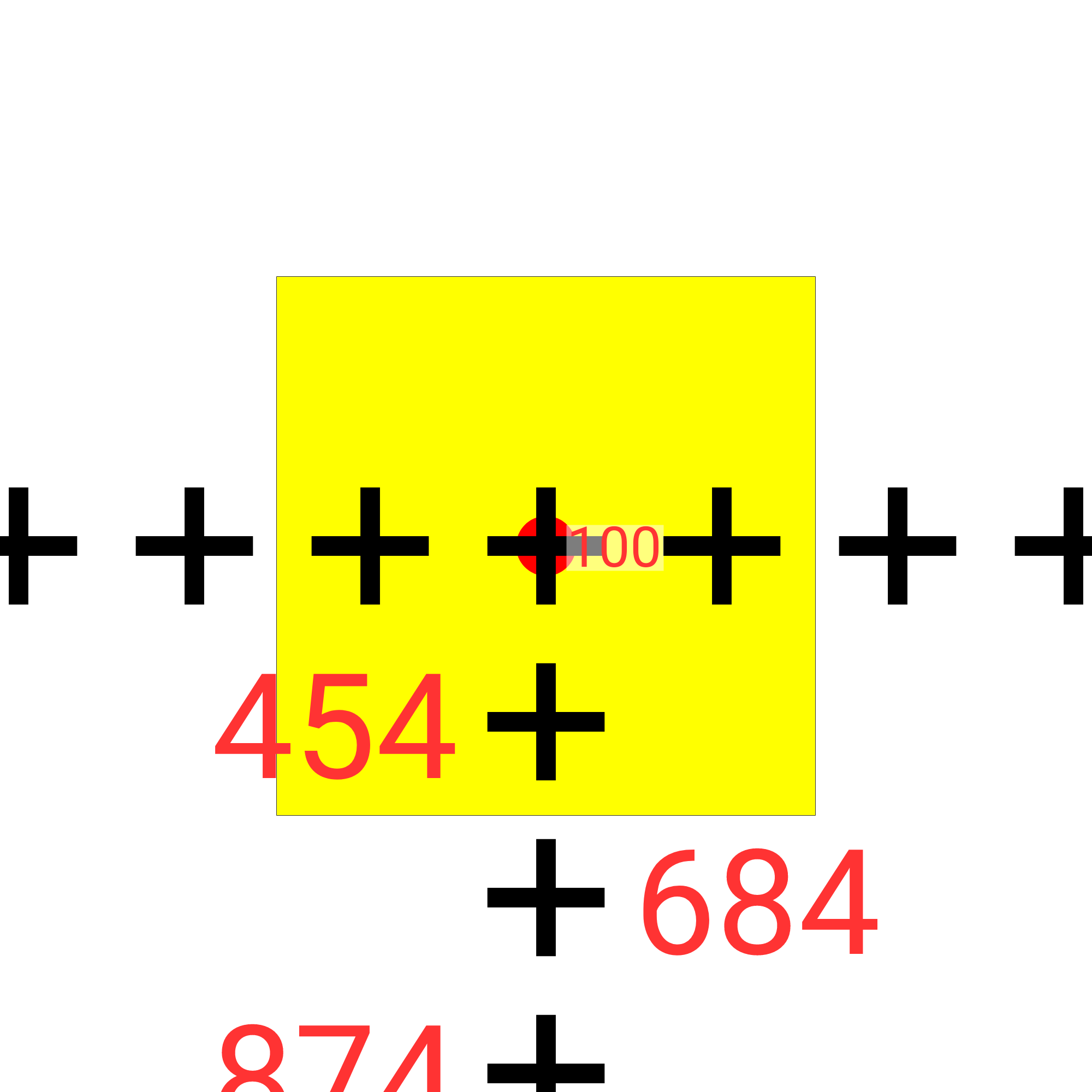

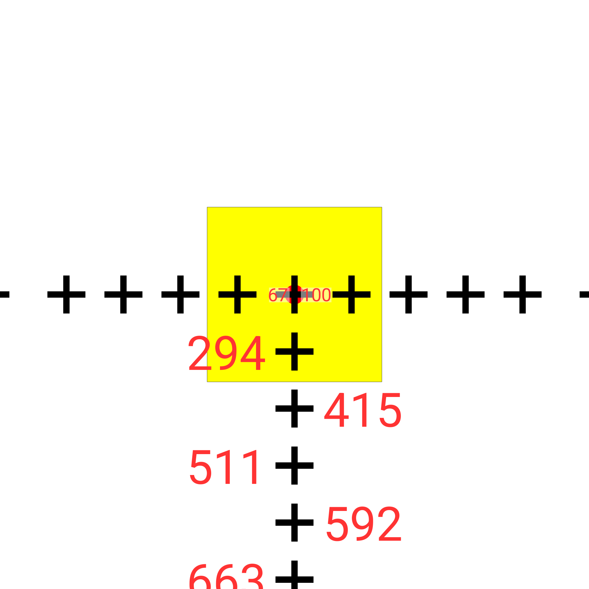

    If anyone is interested I did figure out how to set the Hogster 35 in Strelok Pro.
    Strelok has a reticle for the #5 Super Hogster, but not mine.
    I set up a 24" square at 100 yds. on my range. Set the rectangle target in Strelok to the same size and then played with the scope numbers until it matches.
    I ended up with min =2x, ranging = 2.9x and max = 2x.
    This makes sense since the Super Hogster is 2.9x and mine is 2x base.

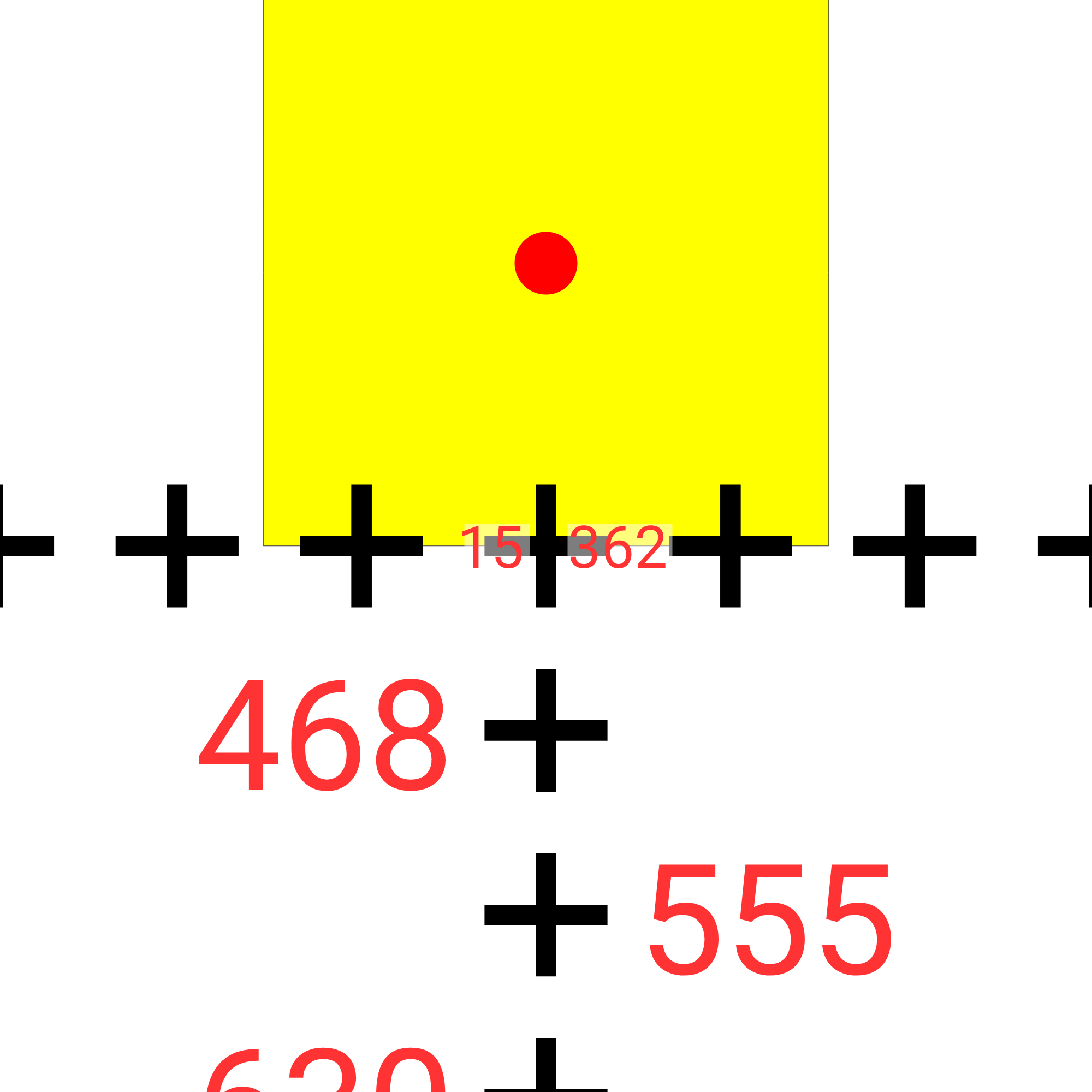

    Here is what it looks like in Strelok Pro, third is a bullet set with 12" vertical offset so you can see it is on the bottom edge as expected.
    Trick is being able to control the size of the target so I could set it to the same size as the actual target.
    Range markings is for a 300BO 110g V-Max at 2240 fps. The hash marks are not very practical as a BDC reticle.
