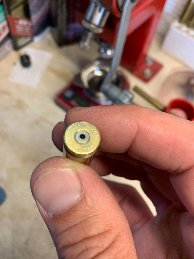

Rifle is AR-10/LR-308 and began life as a .308 with V-seven barrel and BCG. Replaced barrel with Criterion in 6.5 Creedmoor. A buddy gave me 40 once fired Federal brass that I loaded with Winchester WLR large rifle primers. No problem. Then I bought virgin Lapua brass and loaded with Federal 205 small rifle primers and get the holes like in the picture. Loads are mild/ not hot. Head space is good. I think it's the primers, but not sure what to do about it. Does someone make firing pins that are undersized? Could this possibly solve the problem. I have 3000 of these primers and would like to use them if possible.
Your photo isn't working. But they do make 'high pressure' bolts for gas guns. One feature is smaller firing pin. I use the JP high pressure bolt in my 308.
Pictures would be very helpful.

What is FP diameter? What is diameter for FP in bolt face?
Any other powders available? StaBALL 6.5 is showing as a little slower burn rate than 4350s, Viht N-550, IMR4451 and I suspect the time-pressure curve is causing you issues.

Loads look mild enough for either of the two brass case capacity wise . I suspect it's the small rifle primers not liking the speed(burn rate) of the Staball 6.5 , not so much the primers themselves . Good luck and keep us posted please .
@Raptor77 - One more thing I'd question. You said Titanium carrier. You didn't say if this was a complete Titanium carrier from someone reputable like RCA??
Check firing pin protrusion. Should be +- .035. If you got north of .038 due to tolerance stacking of miss matched parts it could cause this.

OP- Quit ignoring the right answer that was post #2.
You are using a .078-.082 firing pin while you should be using a “high pressure bolt” in ar lingo that has a .062 firing pin.

JP Enterprises high pressure bolt now in rifle. Gas rings seem loose. Should I put the ring from the old bolt on it? Going to try to get to the range this afternoon to test it out
