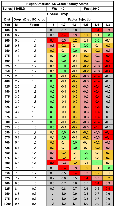

I chronoed my rifle and ammo at 2650fpd, 140 Hornady Match 6.5 creed. Plugged that into my Hornady 4Dof app that was set up with thier bullet info and shot my dope out to 720 yards. 4Dof lined up perfectly and I didn't have to change or true the Velocity or BC. I was pretty surprised because I usually have to tweak something to get it right.

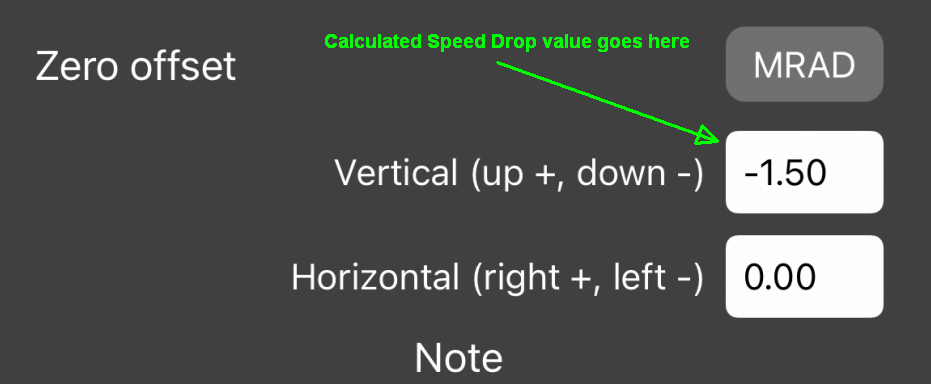

I plugged the drop data into my google sheet (Link) and it calculated a prime speed drop factor of 1.8. I decided to use 1.7 to have a 1/10 error in the middle of the range and then I stretched the near and far extremes to be 0.2 error. I had a speed drop factor of 1.7 and it works from 225yards out to 775yards. Its the perfect range for a match like the hunter series where targets are usually inside 800 yards.

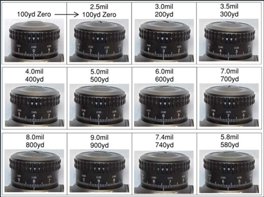

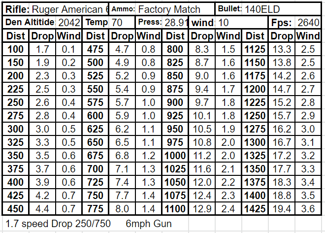

To set my gear up I decided to dial the distances. I zeroed my rifle at 100 yards and zeroed my turret. Then I took the turret off and re-set it to 1.7 mils, my speed drop factor. Now, when my scope is set to 1.7 mils is my 100yard zero. This made it so my 400 yard data is 4mils. 520 yard data is 5.2 mils and 750 yard data is 7.5 mils. See the pattern here? The yardage is the dope I had to put on the scope. Doing this I wouldn't have to lookup data on my arm board.
This is the idea but for my gun its 1.7mils rather than the 2.5 shown
Arm Board Data

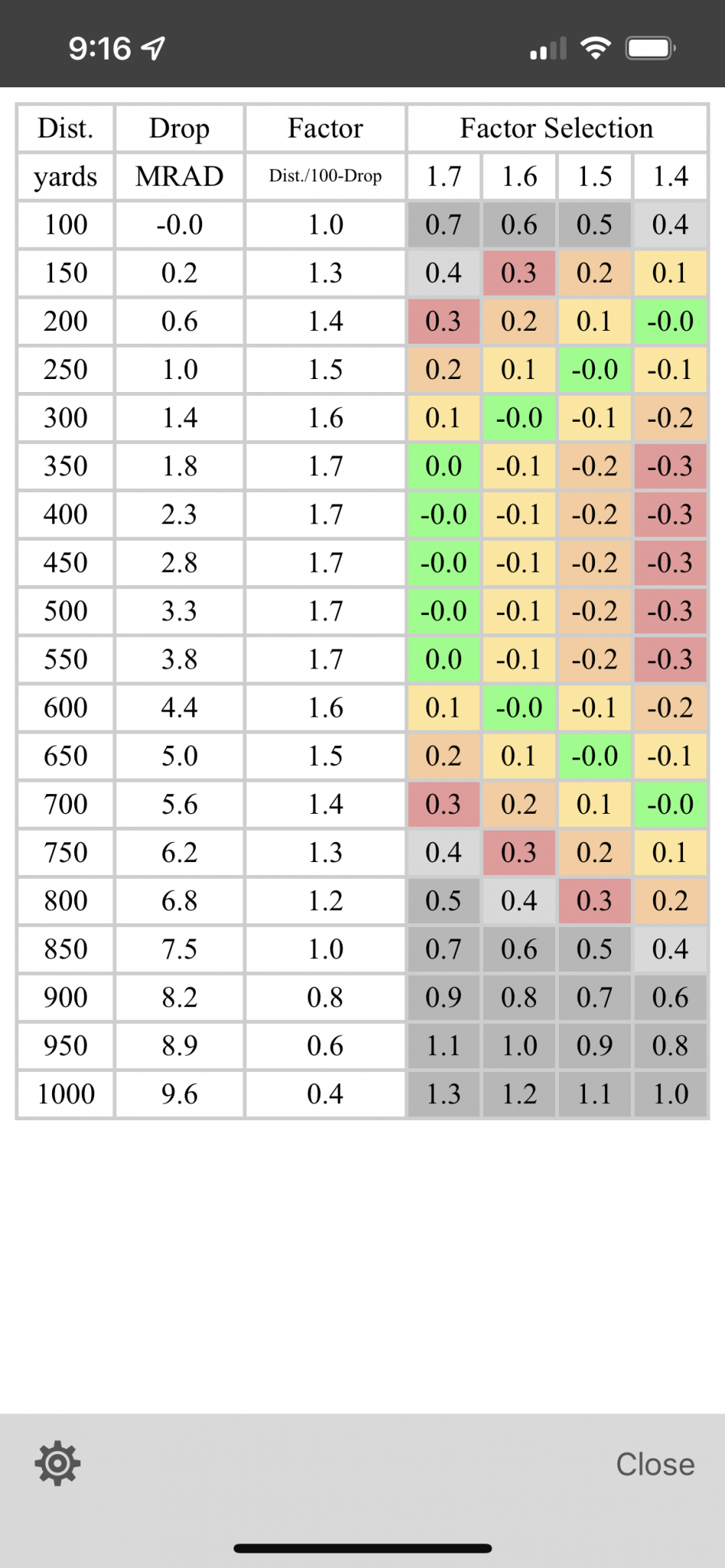

I retyped my arm board data to add 1.7 mils to each yardage. See the table below - 100yards = 1.7 mils. Hence the adding of 1.7 to everything. This way if I had a target at 1100 Yards I could still look it up in the armboard and dial what ever is says. 1100yards --> dial 12.9mils (Bang!)

Once your dial is set to your speed drop factor (1.7 for me) I can dial my scope back to zero and now my reticle becomes a BDC --> 3mil line = 300yrad 5mil = 500yard 7mil = 700yards. This works for the speed drop range. At any time I could have dialed down to 0 and held over the target distance.

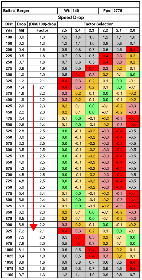

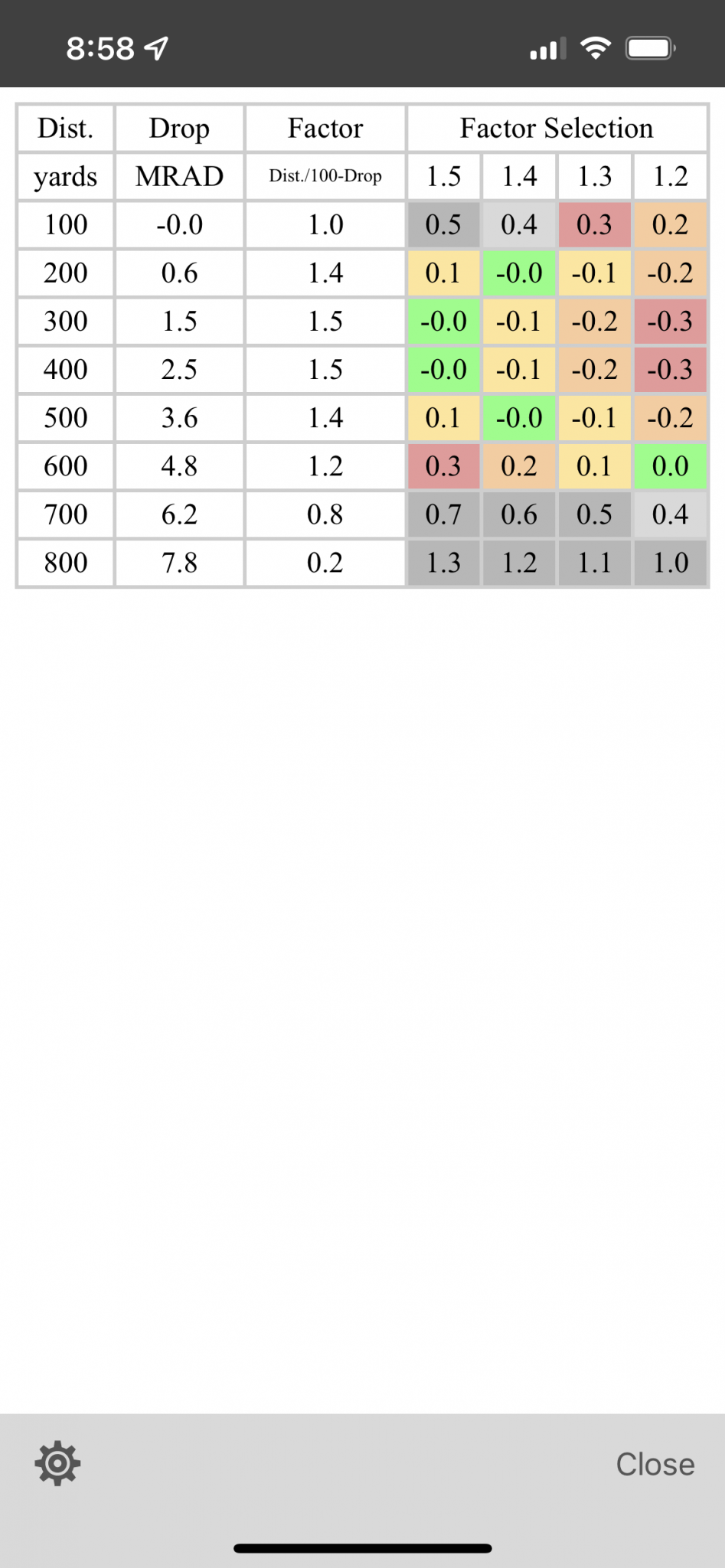

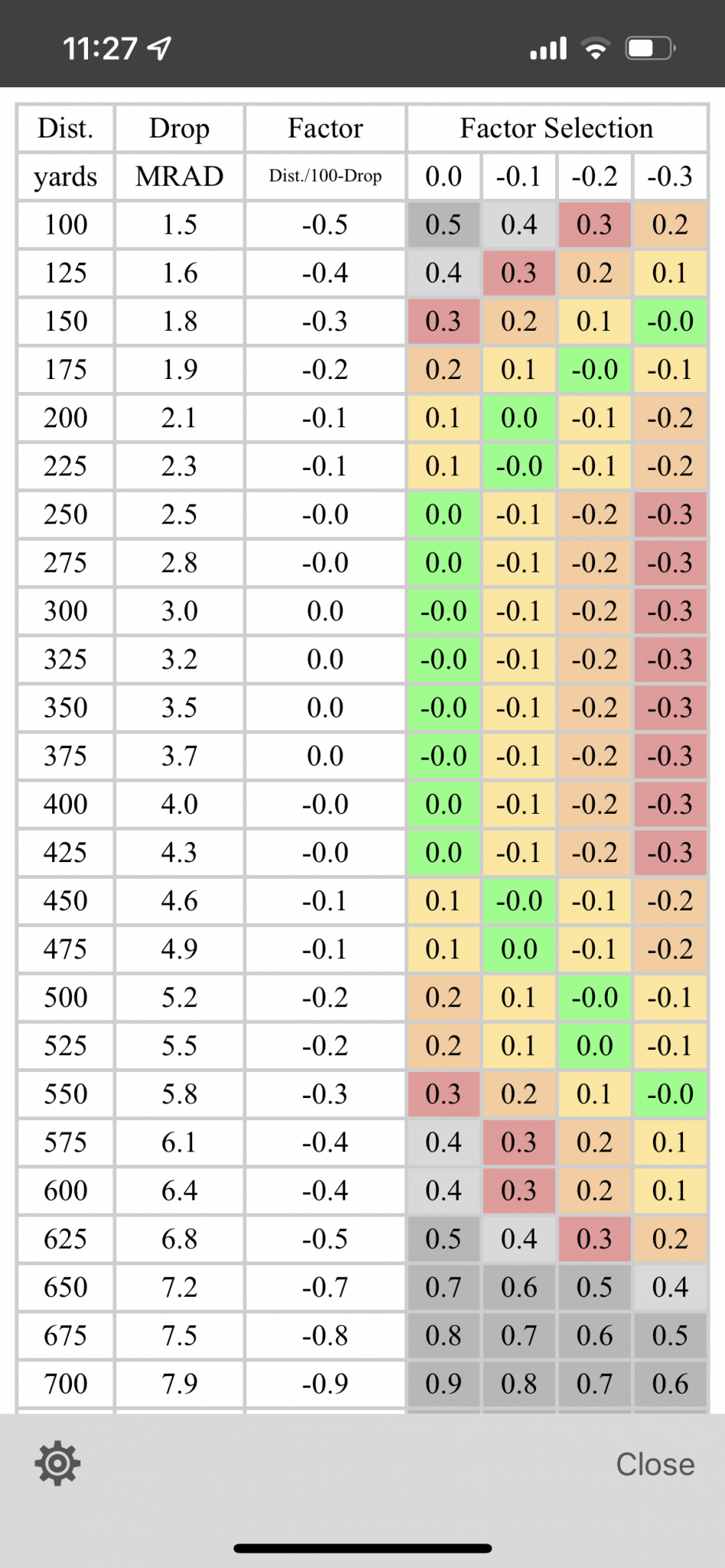

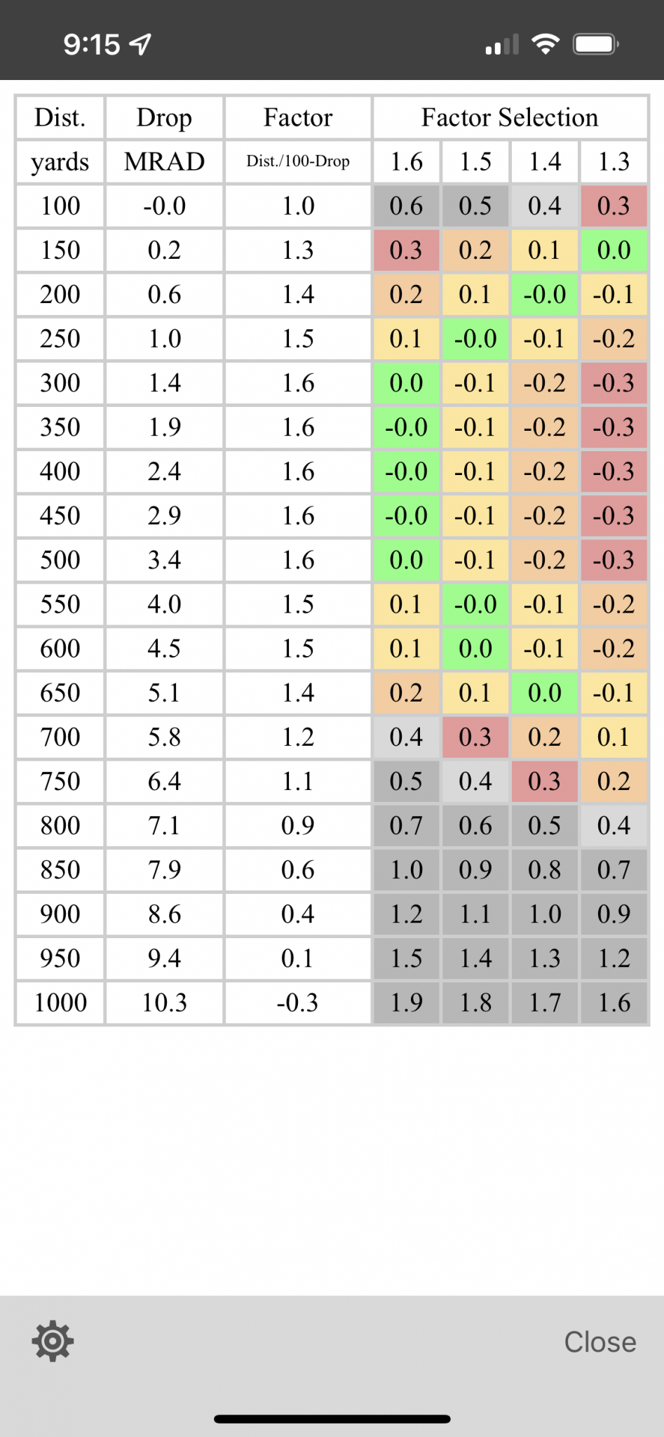

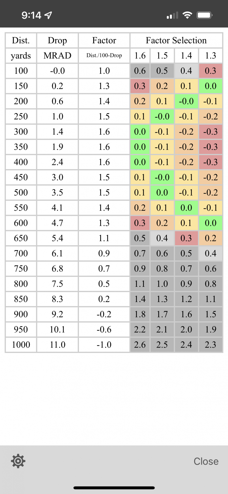

Here is another benefit to the Speed Drop Chart that is on the Google Sheet (for Free). We can check our drop data numbers.
Similar to this article - Going Inside the Numbers by Marc Taylor @Enough Said we can use this sheet to iron out a smooth flow in the value of our data. Gravity is consistent. our drop data should grow with consistency as well.
This data was put into the spread sheet by someone else, not mine, and I took the opportunity to help them fix it a bit. In the speed drop chart your will see there isn't a nice curve of green boxes, but rather some that are out of line with the others. This is telling us we have a slightly wrong value for that data. When the speed drop factor reads 2.5-2.5-2.4-2.5-2.5 we can deduce the line with 2.4 is probably not correct. (see 550yds in the chart below for this example)
This is the original data. I have red boxed the data that likely needs to change and I have shown arrows the direction the green box needs to move.
Here is the same rifle data with a couple data fixes. See the difference in the green arch? Its consistent and grouped together. Its only a 1/10th here and there to make adjustments but it will make all of your data line up better. See how the speed drop factor column does not have any out of order values? its goes up and then back down smoothly.
Gravity is consistent. our drop data should grow with consistency as well. I hope whoever's data this was comes back and checks it again to see the slight errors they had.

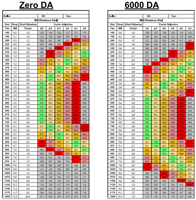

Do you think this would have issues if there was a major change in elevation/DA? Like if you checked dope at your home range to come up with your drop factor at 1000’ ASL and went to a Hunter match in Laramie, WY like Buffalo Bill’s Revenge that I shot where elevation was 7500’ ASL?
I’m guessing you would need to have a part in your process to confirm initial dope at the different elevation/DA or fudge it by plugging in new DA to your kestrel, etc to determine adjusted drop factor.

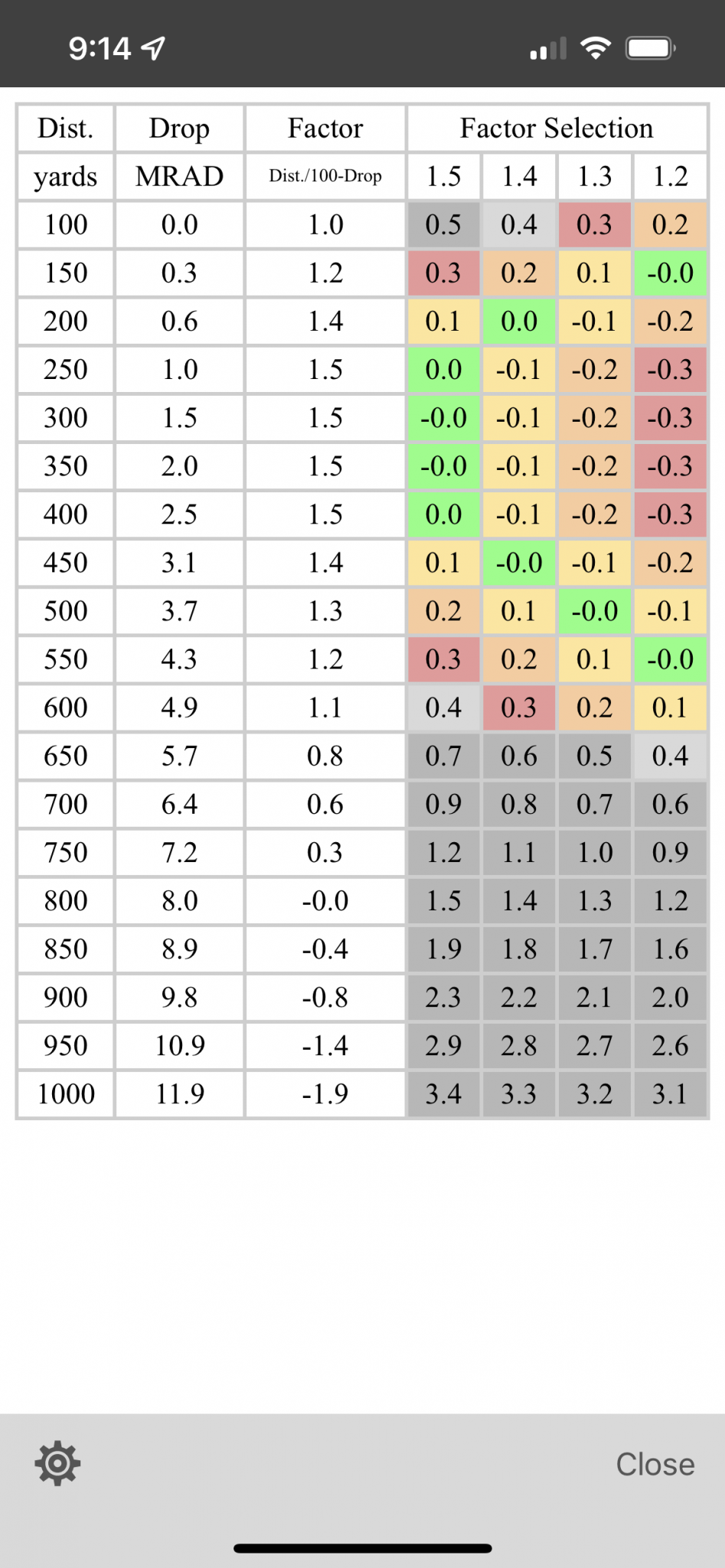

Yes. Our DA is going to effect this system. Below is a table of the same rifle comparing Zero DA to 6000DA. I would not worry about the environmental changes over a day or maybe even a week because the effect will not be large enough, but changing major elevation or traveling would warrant a re-calculation.
Zero DA
Factor = 2.4
Range = 325 to 825
6000 DA
Factor = 2.7
Range = 425 to 975
If you use the zero DA at 6000 DA you would be 3/10th off, about 1moa. This would not meet the accuracy criterial for me, but if the use had large enough targets (military Iron Maidens) it could still work to get the job done.

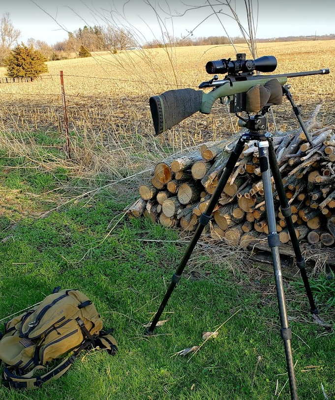

And is that vet wrap on the stock as a cheek riser?
Right on!
Yep. Foam for the riser then self adhering Bandage (vet wrap) because it will only stick to itself and not the stock. I can always take it off and redo it or just remove it. Works Great for a temporary fix or for wen your trying to figure out high you want to make a permanent one.

@Jack Master @lowlight I emailed whoever runs the strelok app afew months ago after i read and tried out your guys speed drop methods. They worked so good i nerded out on your guys spreadsheets and made a few of my own and was like hey this would be sweet on an app. Thats the one i just so happen to use. They added it to the app!
You guys blow my mind with the knowledge bombs all the time. Thank you guys for always pushing the envelope in the way that you do🤙🤙
Like Frank and crew talk about all the time, if you get a good paper zero, use weaponized math to get hard dope, precisely enter zeroing weather in the app, true mv at 600 and bc at 800 in your app, and accurately input all other required fields, the apps will work for you. Just playing w strelok, if your load is all validated and trued up and youre a DA guy, when you change DA’s you can see how your speed drop changes with bigger swings in DA in the app. I tried copy and pasting the speed drop table from the app to google sheets and it works. No formulas like @Jack Master tables which sucks but at least you can store how ever many tables for different mv’s and DA’s you want in google sheets🤙
Reactions: Jack Master
View attachment 7908411View attachment 7908412
That's awesome! I'm glad to see apps picking this up.
My question is - in the screen shot above, what is your speed drop factor? I'm not sure they are showing the right numbers yet. They have the right process but I cannot gather the speed drop prime number from this to which subtract the factor selection from.

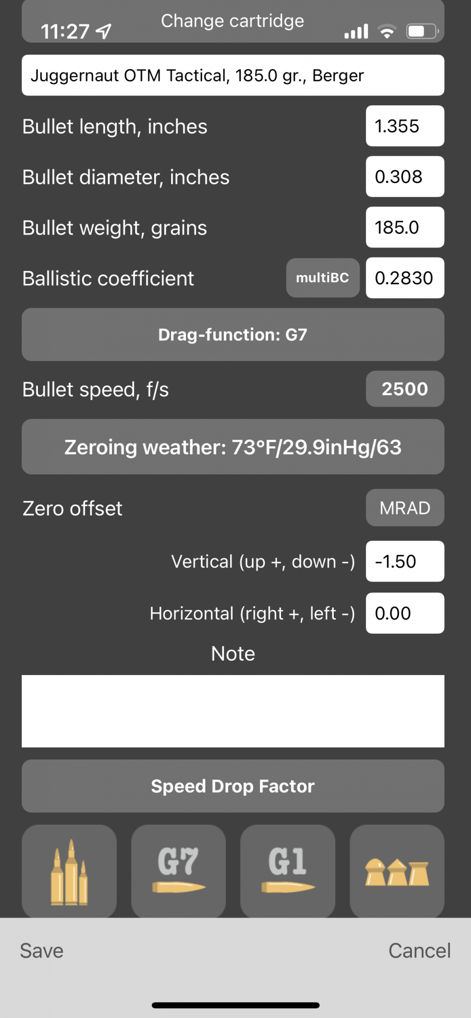

Heres an example of simulated DA changes with my 185 berger juggernaut at 2500fps. My zeroing weather is essentially a warm day at coastal sea level and low rh. The tables show da changes to the speed drop at -2000, +2000, +6000 and +10000 respectively.
Clever stuff from Igor in the app, if you have a MOA scope selected the button doesn't show.
ETA:
This is live in the Android version as well under the Cartridge section of a rifle profile.

Ran this over the weekend at a NRL hunter one Match in Decorah Iowa. It works damn well. I ran a arm board with the distances under 400 and over 700. So I could dial the exact dope for those. But any thing between 4-700 yards just turned to the turret to match the yardage. Any misses were from my shooting or bad RangeFinder reads. With a little thought on how to implement this it works well.
Not trying to be an old fart here, but how is this better than simply marking your turret with 2,3,4,5,6,7 etc above the mrad numbers?
Its the same idea but instead of needing the pen (and maybe tape) we can just rest our current turret.
These are some of the benefits I see:
  1. Won't rub off like a marker
  2. Less confusion with multiple rows of numbers on the turret
  3. We can make this system work any where in the field. No pen or tape needed.
  4. This is a system you can carry in your pocket of knowledge to double check yourself
  5. My turret is too small and don't want to cover the mil numbers (if using tape)
  6. If I reset the turret to the speed drop value I can dial back to zero and the "tree reticle" becomes a yardage reticle.
  7. If I change atmosphere or DA I just need to re-set the turret, not rewrite all the numbers
Some of these are all small and petty things that I think make it better. Some of them are a major difference that is better. Marking your turret is fine too. Speed drop is just another tool.
Now I can ask the same question: How is marking the turret better than using speed drop?

I have a stupid question… my scope (vortex Gen ii) limits zero stop to -0.5 MIL. So if I have a 2.7 speed drop, how do I go -2.7 on the turret? I assume I have to dial in -2.7 on the elevation turret and then just hold over my range… 600 yards = 6 mil elevation hold on reticle (which is really about 3.3 mil since I would have -2.7 added on from the turret being negative)…
Reactions: TheOtherAndrew
You'll have to take the turret cap off and adjust the zero stop to allow more movement below your existing (-0.5) zero.
Once you've figured that out, and you can dial the -2.7 mils, the speed drop system should work, within the near and far distance brackets provided.
