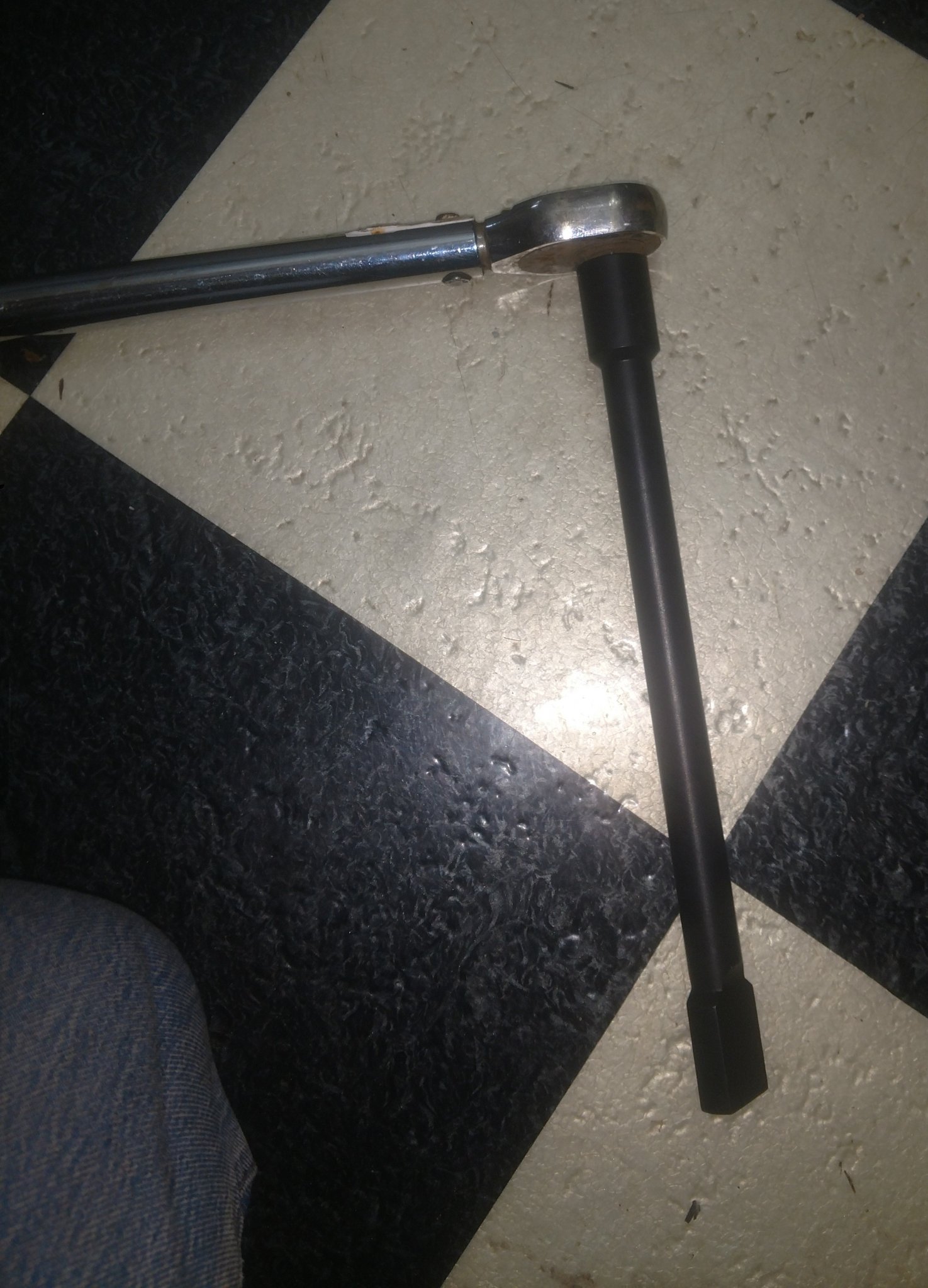

I use a cheap harbor freight 1/2 inch torque wrench that snaps right onto my action wrench.

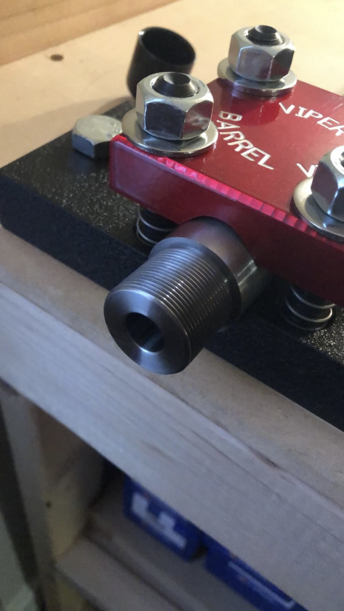

I think you and I have the same bench so I'm glad to see that your vise works. I had the same place in mind for where to set it up.
The $80 benches from Home Depot?
Can’t beat ‘em really. Good for me since I’ve moved 3 times and they pack up easy.
I have it about 1/8” too close to the edge of the bench so back it off a hair. depending on the size bolt and nut you use it could hit the inside edge of the bench underneath. The flat side of a nut sits just against that framing underneath so I just barely got it to work. Just an FYI
Yep that's the one and I know what you mean about backing it off the edge. I had to do that when I installed my vise block. I'm tempted to actually get another bench like that.
I have two, my buddy just got a second one for his reloading room. They are sweet! My barrel vise is mounted on the left edge just out of frame behind the regular bench vise
