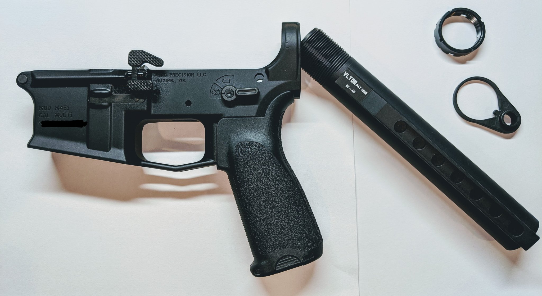

I've never used an A5 system, but based on all the threads/research i've found it seems to be the best(?) setup for a smoother carbine.
I've been shopping around for months and all the Vltor A5 stuff is permanently sold out, so i'm hoping to piece together my own setup
1.) Receiver extension: these are easy to find as numerous companies make intermediate length tubes (i'm a fan of the LMT mws one)
2.) Spring: endless options, cheap to swap out, not really a huge concern

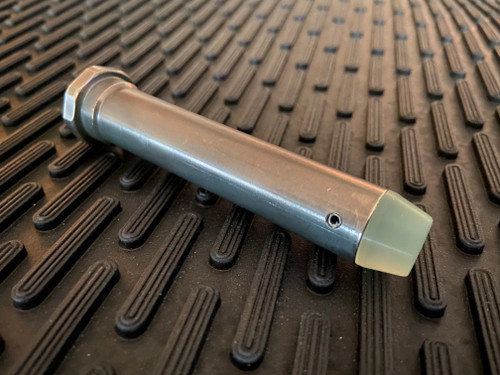

3.) Buffer: This where i'm hung up, i assumed it was just about the weight (H1, H2, etc) but the "official A5 buffer" is slightly longer than a standard carbine buffer.
Is it really going to make any difference if i'm using the same weight as an A5 H2 buffer just in a standard length? (which is like 1/2" shorter or something minor).

DO NOT use a standard buffer in an A5 extension. You will damage your carrier and/or lower.
Thanks for the heads up

I agree that A5 buffer systems make a noticeable difference in felt recoil. I run them on every semi-auto i have. heavybuffers.com has them in stock as of 7/23. their quality is just as good if not better than others...
Get a kynshot (5007 only) and tubs flatwire for a intermediate buffer tube.
