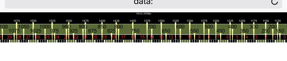

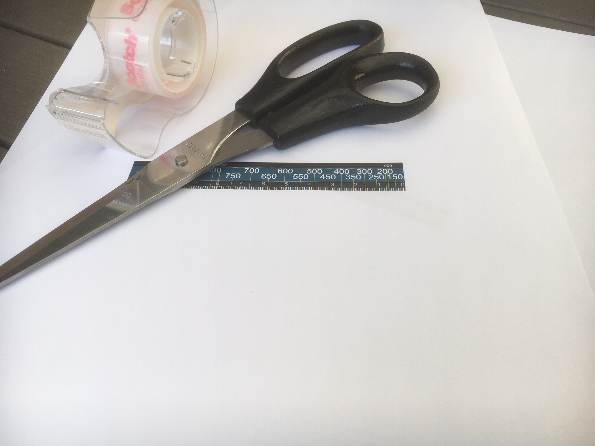

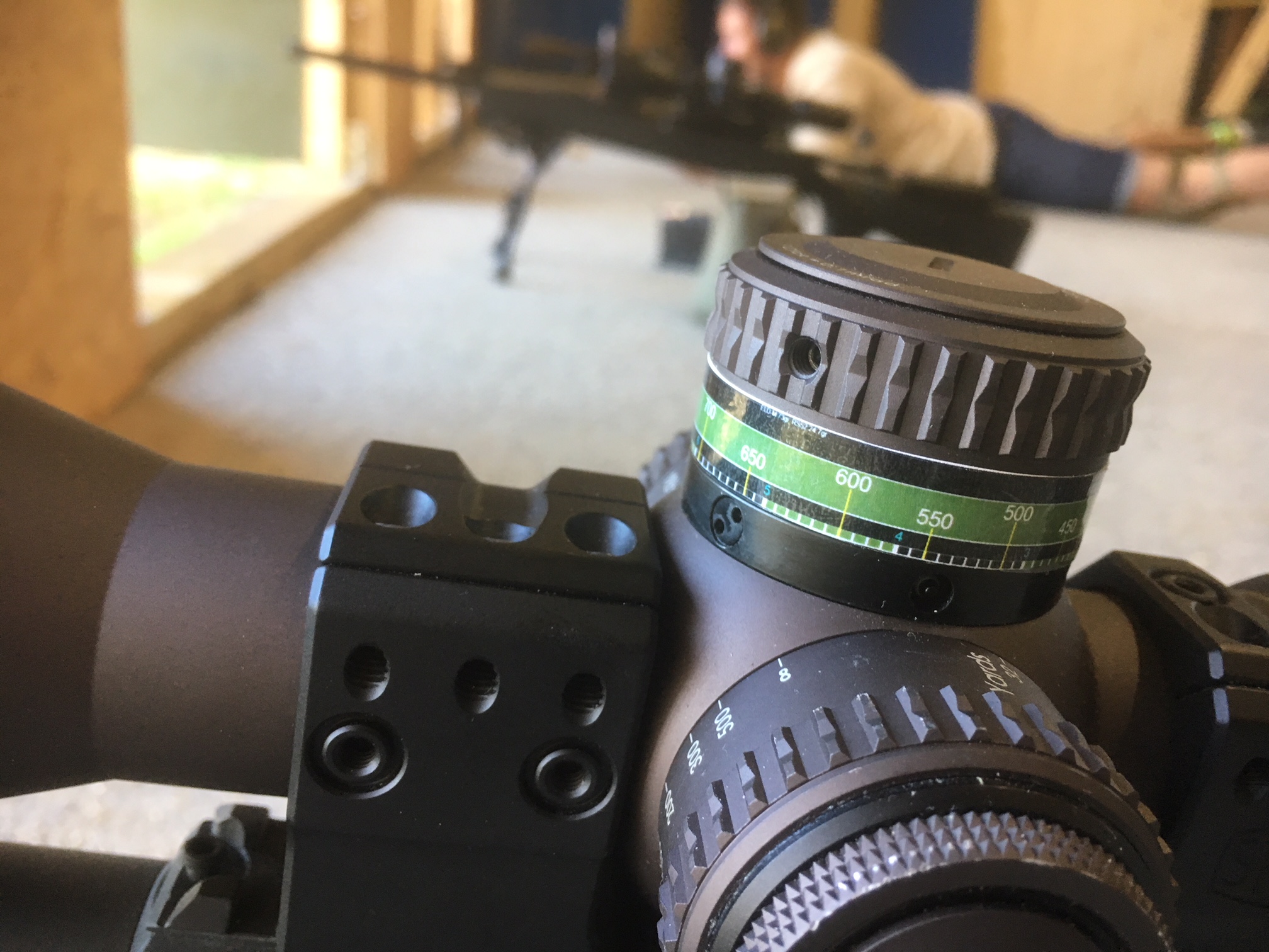

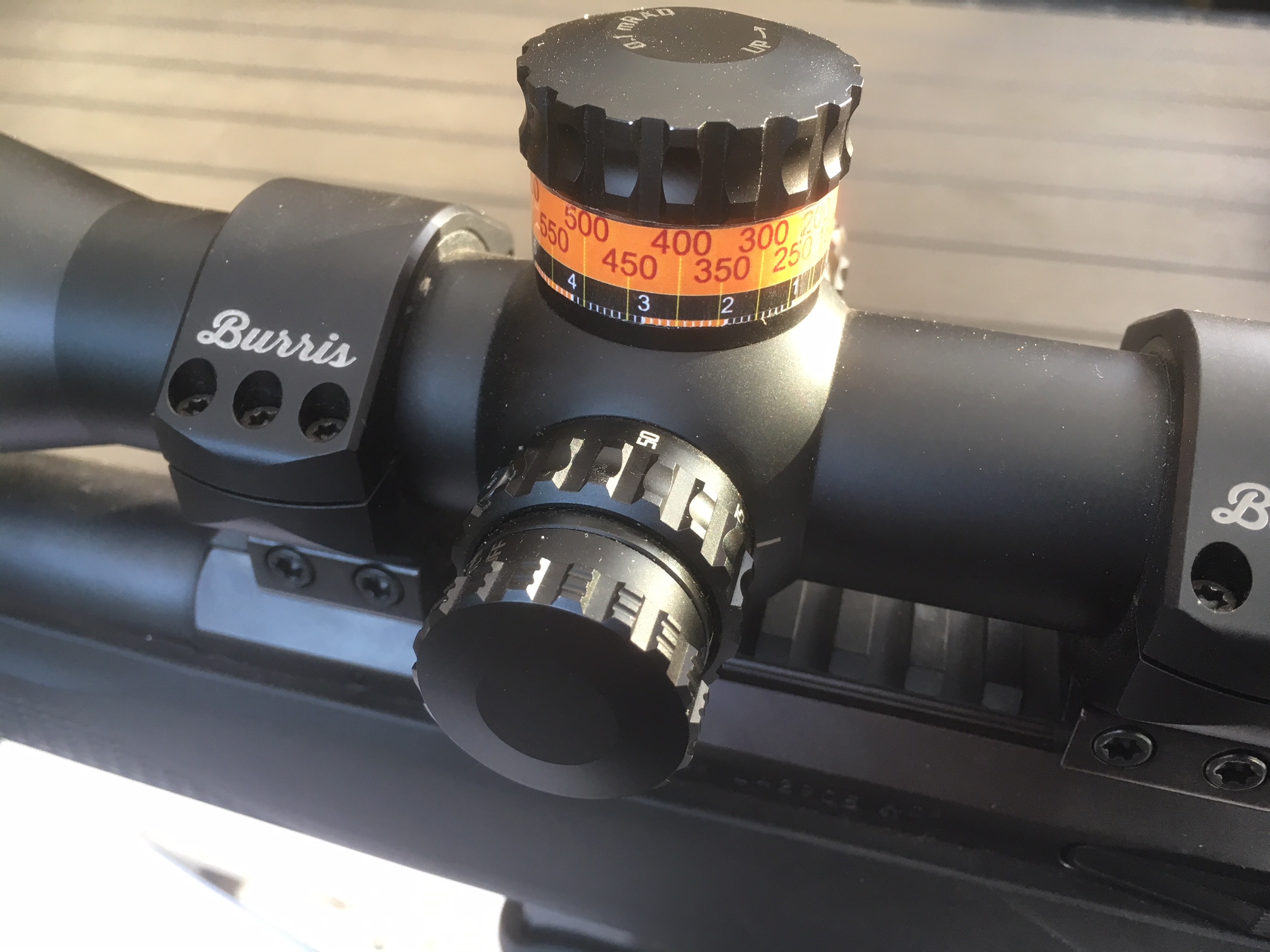

Basically you just need to measure your turret diameter and height with a caliper and plot it in (it only accepts mm right now, will make support for inches some day soon). I've divided the label/turret in 4 "bands". The lower one is the "units" band (has markings for each click and each full "unit" mil/moa), then 2 bands - one for 1st rotation and then one for 2nd rotation (this is where the distances are put). Top band is used for giving your label a name, eg load data, environmental settings for table.. You can define the height of each band with the "ratios" - sum must be 1 of the 4 bands ratios. So you can skip some of the bands, if you don't have a lot of real estate (low turrets). Play with the colors, the font size - and share some pics it with us if you make something awesome (colors and contrasts make a huge difference in readability and visibility) :)
You rock, this is a cool tool and it's awesome that you are sharing. Last night I figured it out but since my home printer doesn't work anymore I tried it this morning at work and my work computer is having trouble. I'm not sure if it's a security block or what. I might have to create the file at home then e-mail it to myself.
Anyway, thanks again I'm looking forward to playing with this!
