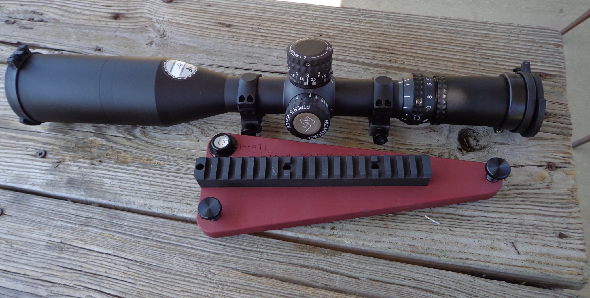

Hey guys
While I'm waiting for my new scope to arrive I ran across the Wheeler system. I'm sure most of you are familiar with it, it
looks great to me. But considering how much this new build is going to cost in a new caliber. I'm doing what I can to hold costs down.
So long story short just using this AR as a prop. Mimicking the wheeler system to my home brew setup. Once the barrel level is
leveled, then the red level that will be laying across the scope elevation knob is leveled out. What is the difference between my system
and Wheeler's? Will mine work as well for scope reticle leveling considering this is for shooting at long range accurately?

Another good suggestion thanks guys! I did see in another thread that someone used feeler gauges. I know for all
practical purposes ALL the methods listed work fine. I'm just trying to determine the best method considering the
amount of time/$$$ that will be expended working up loads . So since nobody thinks my home brew system is "off
track" I'll go with it and verify with a plum bob.
Still curious if anyone has used the Wheeler system and liked it?

Thanks HB, that's solid advice that I've used in the past. As long as the base that the lower scope ring is mounted to. Is aligned with
the rifle bore it works fine. But if the rifle's base is off axis with the bore from the factory is when we run into problems.
Now 99.99% of the time the bases are fine and everything works with that method.
The Wheeler 2 level method eliminates the rifle base mount specifically from being an issue since it aligns two points. The reticle and the bore axis to each other. If their is a inherent misalignment from the factory in the base mount, rings not perfect etc.. Then aligning the two levels will correct for it automatically. That's why I like the Wheeler method, if I'm understanding everything correctly it seems the most error free if the process is followed to align the scope reticle to a T.
I've never used the Wheeler method before and it probably wasn't created by them anyway. Its just something I ran across since
I'm getting into long range shooting. Appreciate the input guys!
I have the Wheeler. Sits in the bottom of a drawer unless I want to make sure a self-timed brake is level with the barrel. It works providing you are running a GOOD optic. I have seen optics where the reticle is not aligned with the scope body which makes the leveling system pointless. As mentioned, plumb bob it. Way faster and you get the reticle vertical within your natural point of aim rather than with the barrel. Not much point in leveling the reticle to the barrel if you are having to force the rifle in to that same position before you shoot.
