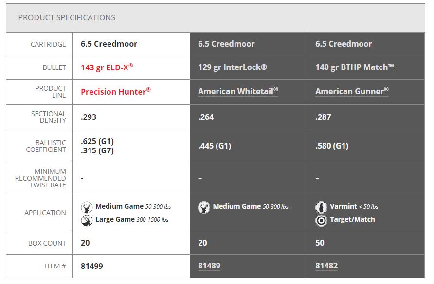

Just wanted to know if anybody out there has used the Hornady 140 American Gunner bullets in 6.5 CM for hunting. This past weekend I shot an antelope with them in the left shoulder at 225 yards and it just blew up, ZERO penetration into the cavity, the antelope turned around and I shot it in the right shoulder with the same result with NO penetration at 300 yards. Finally had to shoot it a third time at 450 in the neck which did not pass through either. Anybody else used these bullets for hunting and if so what were your results? Did they just explode for you too?
on the website (Hornady) they do mention hunting but specifically varmint and small game hunting.
I'd find something with the ELD-X bullets if you are hunting anything bigger than coyote.
Your bullet didnt fail. It accurately hit the target like it was designed. They arent hunting loads. I used them to hunt deer once and never again. I didn’t experience what you did by any means but will never use them again. Mine penciled through on the deer I shot at 365 yds and blew up on anything under 200 yards. Sample of 6 and all results faired the same.

Certainly won't be using them again, on their website they do say the American Gunner can be used for hunting, obviously that's not the case!! I bet it would be a good bullet for dogs!!
This American Gunner? Hmmm, a prairie dog silhouette and a target? What do they recommend using it for?

Also, try actually researching what you're buying in the future. Easily could have grabbed the eld-x and avoided the entire situation.
Or, he could have bought the American whitetail, which is loaded with a bullet designed for light skinned medium game, and still stayed on the cheap...

I wish they would stop giving these match bullets a “hollow point” designation.
They are an “open tip” bullet. There is quite a bit of difference with an “open tip” meplat compared to a true hollow point.
That’s why the US military has used them as sniper rounds without violating the Geneva convention ban on the use of hollow pointed ammunition.
Technical parlance dictates the use of the term; “open tip.”
They ought to be known as BTOT bullets instead of BTHP.

Either way, a match bullet is not designed for the job.
