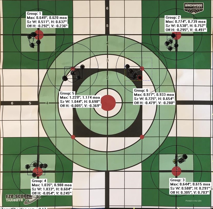

Weird. I have a Tikka CTR 24” stainless and these are the first groups out of the gun (the first 30 shots I ever fired through it) with 147 grain ELDMs (working up to the max charge in 0.3 grain increments). The average group size is 0.57 MOA. I am trying the 140 grainers this weekend. Maybe it's the difference between the carbon steel and stainless steel versions or just what my rifle likes for whatever random reason.
Update: For anyone interested. I went shooting this morning trying out 140 grain Hornady ELD-Ms. I shot 6 groups with powder increasing in 0.3 grain increments from 42.5 to 44 grains (of Winchester Staball 6.5). The groups are labeled in the order they were shot. Last week with 147 grain ELD-Ms my Tikka shot on average 0.57 MOA. Today it shot on average 0.84 MOA with the 140 grain bullets. It seems my 24" Tikka CTR Stainless definitely likes the 147 grain bullets better. That said, it was really windy today (30 mph wind gusts) so take these results with a grain of salt. I did my best to shoot in consistent conditions but I'm not perfect. Still, only one group was over 1 MOA. It's not terrible but nothing to write home about.
