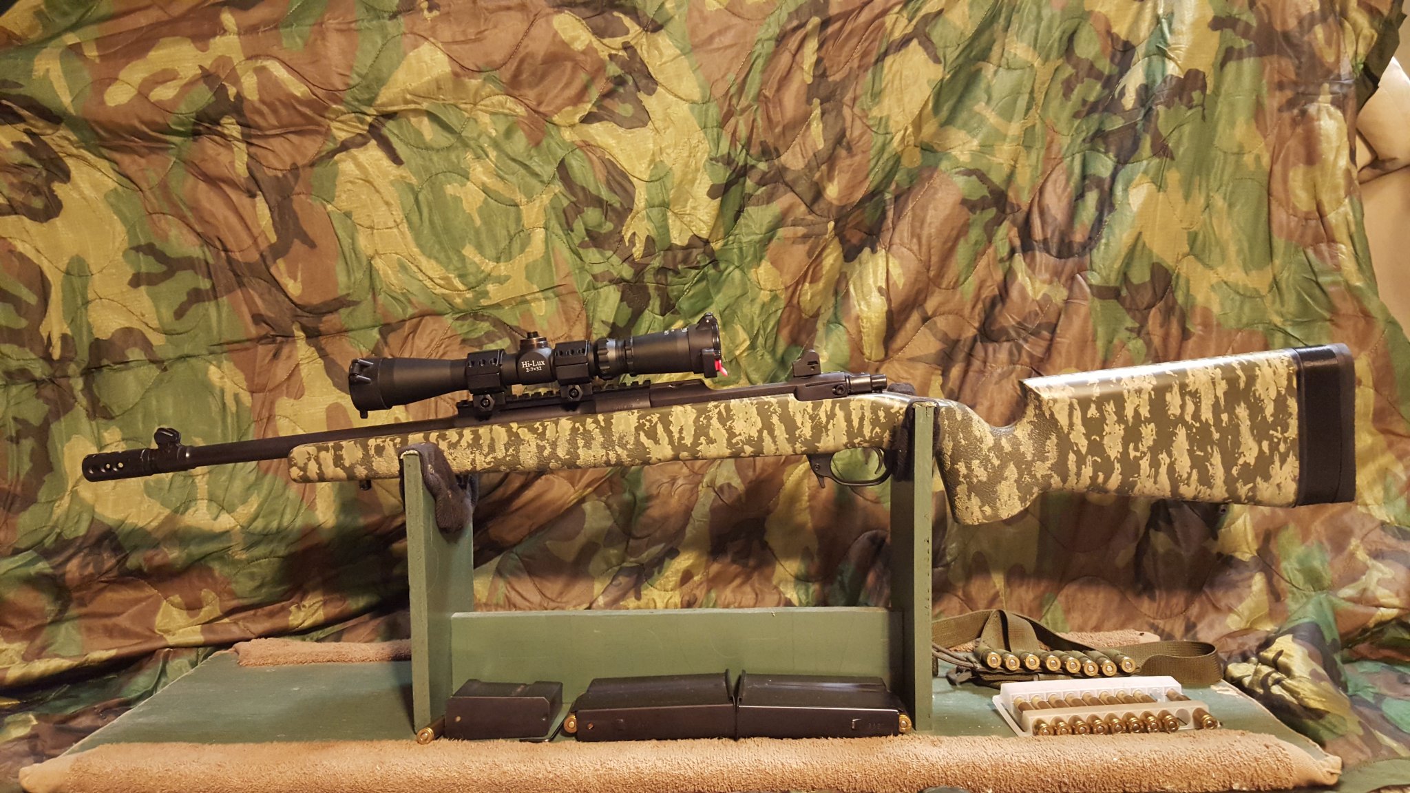

It should be running close to 2550 at 10' and around 2250 at 100m. As this is a scout rifle, built to kill anything on four legs or two, or even take out 'other metal things'. I've done my best to essentially build the consummate bolt action, kill or incapacitate hunting/battle rifle
