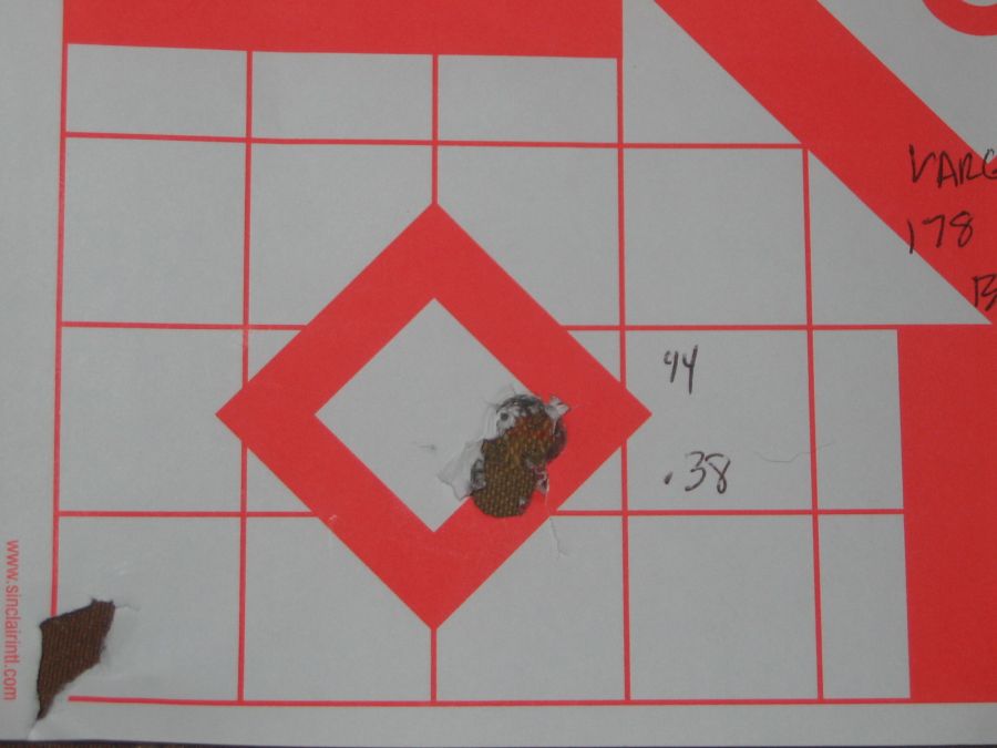

I shot this yesterday. Five shots at 100yards. 44gr Varget, Lapua brass, 210m primers. I have not tried them out further. I'm hoping they shoot as well as the amax.
In my SPR the Amax shoots more accurate but the hpbt's shoot better at 800+ and I am addicted to shooting out that far so I stay with them... Not to mention I can't find the Amax's anywhere
