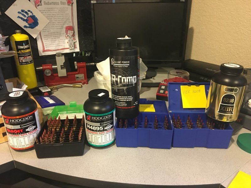

Two boxes of the new .224 Hornady 73g ELD-M showed up today. I loaded up an OCW with 8208XBR in .2g increments from 23.2g to 24.2g to test in my 20" WOA 1:7 SDM AR. They are longer than a 77smk and a tad shorter than a 77 TMK. I have to finish my seating depth testing with the new 6.5 130ELDM tomorrow. If I have time I will shoot this test otherwise I will shoot it early next week.
1xLC Annealed
205M
8208XBR
2.2585" COAL
From left to right
Nosler 77cc, Hornady 75BTHP, Hornady 73 ELD-M, 77TMK, 77smk

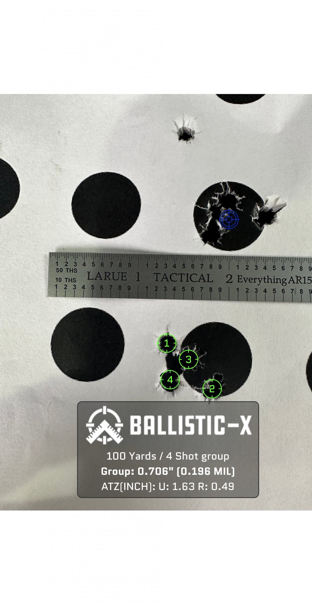

Ok so I was able to shoot the OCW yesterday with my 20" WOA SDM 1:7. I loaded 5 foulers to shoot over the Magnetospeed V3 so I could get an idea of speed. I do not shoot my OCW's with the Magnetospeed on. I loaded the foulers to my same 75BTHP and 77smk charge weight of 23.6g 8208. All rounds were loaded to 2.258" COAL. This charge was dead on with my 77smk load in speed at 2800fps and SD8.4. Accuracy was not there but I was not looking for accuracy with an OCW. I suspect these like to be seated deeper just like my 77smk and 75BTHP loads. And yet again, after shooting the OCW 23.4-23.8 shows an obvious node. That node exists with pretty much every 75/77g bullet Ive tested with 8208XBR. Im now going to load up a seating depth test with 23.6g 8208XBR and see how accurate this bullet can be.
sawgunner, per the test I just did yesterday with these new 73"s, your same load should work just fine with these bullets. At least it does with 8208 for me, but I personally always test to confirm. I never had great luck with the 75's, they shot OK but not nearly as good as the 77smk do in my rifle.

I shot my seating depth test today and the result were disappointing.
I shot my OCW at 2.2585 COAL. Found an obvious node between 23.4-24.0 but groups were large at 1.5-3". I went with 23.6g and loaded a seating depth test going shorter in .003" increments 4 times. The groups never got any smaller. I am going to load 2 groups going longer in .003 increments above mag length to see if these 73's like to be closer to the lands. Would be ashame if that's the case because they would not fit in a mag... Will report back
Going to try Varget and RE15 as well to see if they just done like 8208..
Shot a 5 shot group with my 77smk go to load just to confirm everything is functioning properly because I got a new QD scope mount and it was .4" so gun is shooting just fine as always.

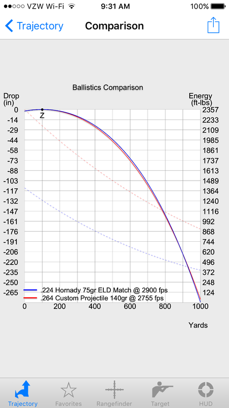

I thought the comparison between a 140gr ELD and the 75gr ELD was interesting. Obviously when the wind picks up it a whole other story.
My 73gr ELD load @ 2900fps is also nearly identical to my 130gr Berger AR Hybrid load @2800fps. At around 480yds the flight paths diverge by greater than 2 inches with the gap growing to 10 inches by 650yds. Wind drift is ~ 1.5x for the 73gr versus the 130gr.

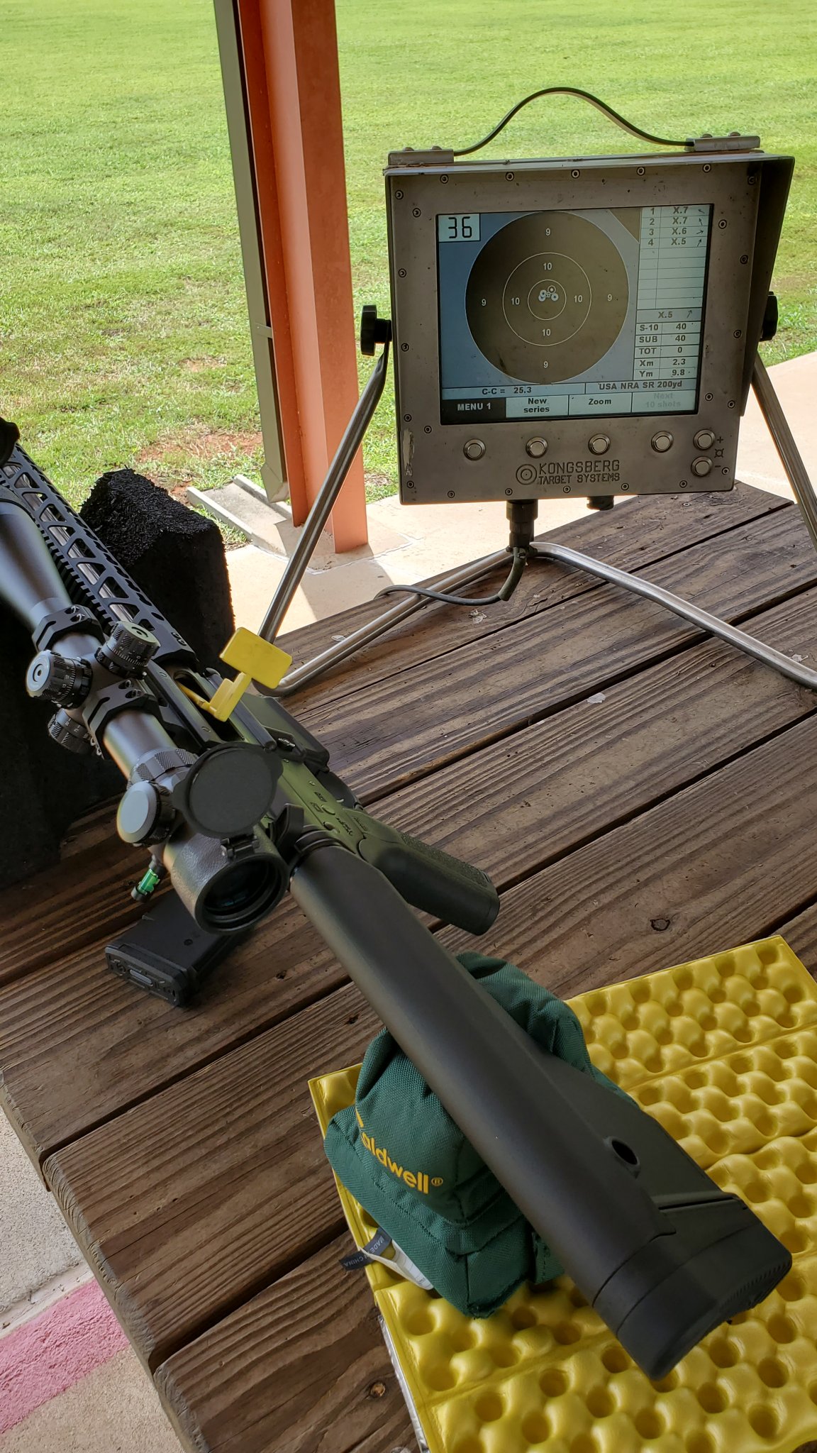

I've worked with this bullet quite a bit recently as well. Testing two powders in 3 different AR's and finding great results.
First with Varget at 2.260 COAL. Fully prep'd Winchester brass, GM205MAR primers. Gun is a bastard build AR. Has an older Larue Stealth upper with the 18" Lothar Walther 1/8 twist. Also used a SAS Arbiter 7.62 during testing. This combo comfortably shot the 77SMK into 1/2" at 100 so I use that as a benchmark.
Physically couldn't get enough Varget into the case to find any pressure signs. Loads past 25.0 grains were compressed to the point of bullet deformation so that was out but shot them anyways. Like they say with Varget, if you ain't crunching you ain't living.
Accuracy was outstanding. Best groups I've ever seen from this rifle and across the charges more accurate than the 77SMK or 70RDF ever was. Wish I would have seen more distinct velocity nodes throughout the charges and a bit tighter SD but the 24.8 load has done well on whistlepigs out to 700 yards. 2685fps is what I'm plugging into JBM and it lines right up with the advertised BC out to 700 so far. The velocity isn't mind boggling but from a canned 18" gasser it's right near what I expected to see. 40fps faster than my 77 SMK load.

Second powder tested was H4895. Going off others helpful information in this thread I expected to see a node in the upper 23g range and that's exactly what I found. I ran the full spectrum anyways just to feel this faster powder out. Again, no pressure signs were seen in case heads but noted pretty flattened primers up past the 24.0 grain mark. Also, heavily compressed with slight bullet deformation north of 24.2 grains. I get the feeling these projectiles must have VERY thin jackets as the SMK's seemed like they could take a bit more crunch with no signs of abuse.
Test rifle was a budget build PSA 16" light stainless kit. 5.56 Chamber and again with the SAS Arbiter 7.62 suppressor. Typical accuracy hovers around 1 MOA with a decent load. Fully prep'd WMA brass (Winchester Military) and GM205MAR primer. Found a very nice velocity node from 23.7-24.0 with 23.8 being a standout on the chrono. Group size tho warranted additional testing of seating depth. Found that this barrel liked a bit more jump. Final load was 23.8g at 2.220" COAL or 1.768" ogive.
I may may revisit the previous LW barreled rifle with this powder just to see an apples to apples comparison of H4985 to Varget.

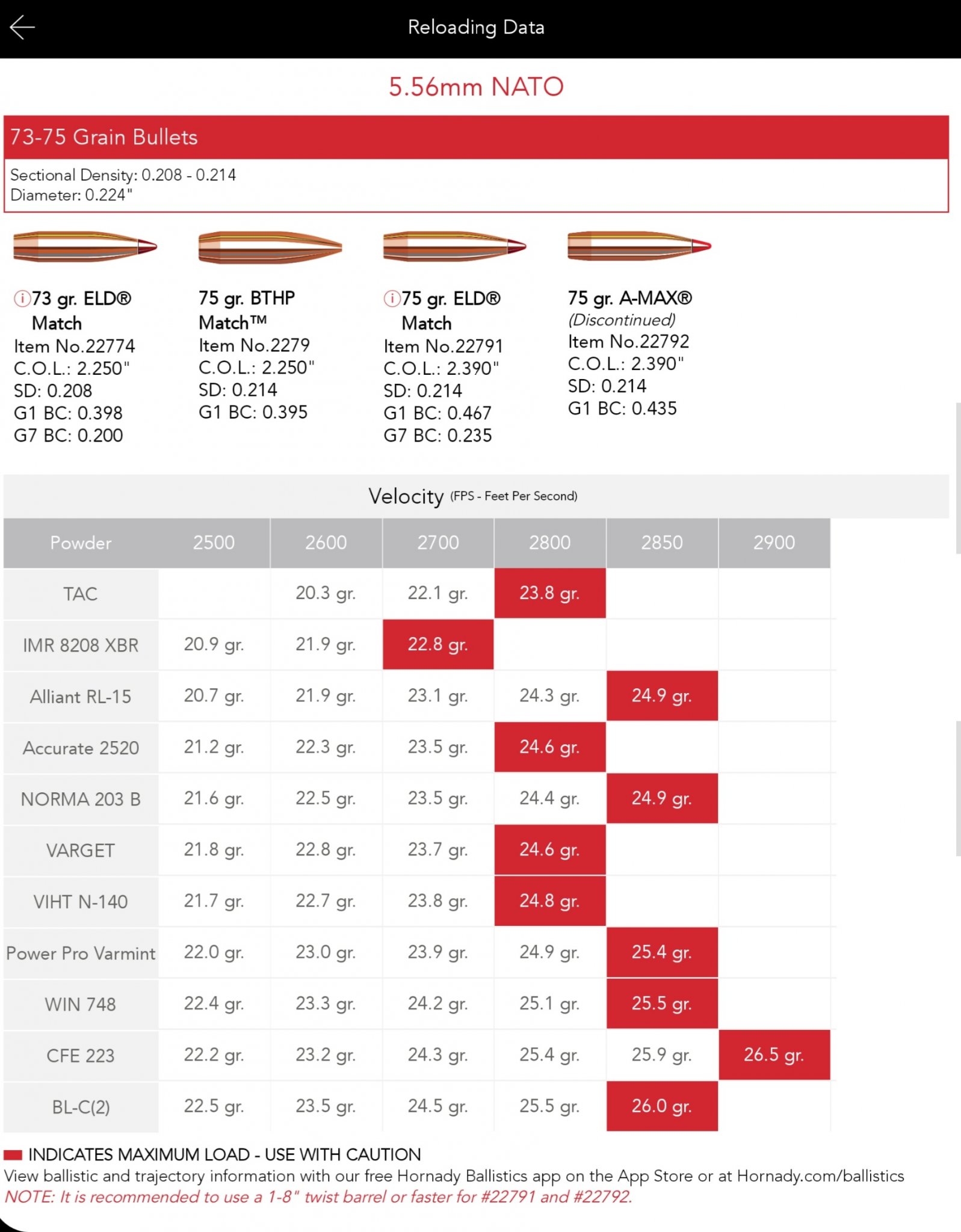

I purchased the Hornady 11th edition 5.56 load data through their mobile app. I hope its okay to post this here.

Are you loading for a gas gun or bolt gun? Hornady's load data is quite conservative FYI. I would not go above 23.5gr of XBR8208 for 73gr and even that could be a bit spicy dependent on variables. Work your way up obviously,
A gas gun, rifle length gas tube in an 18" bbl, so the cycling is fairly soft, had plenty of cycling issues with H335 in the first half of book load ranges for that powder.

Ok for the gas gun I'd stay below 23.6gr of XBR8208. My goto load of XBR8208 is 23.3gr under a 77 SMK in a LC case.

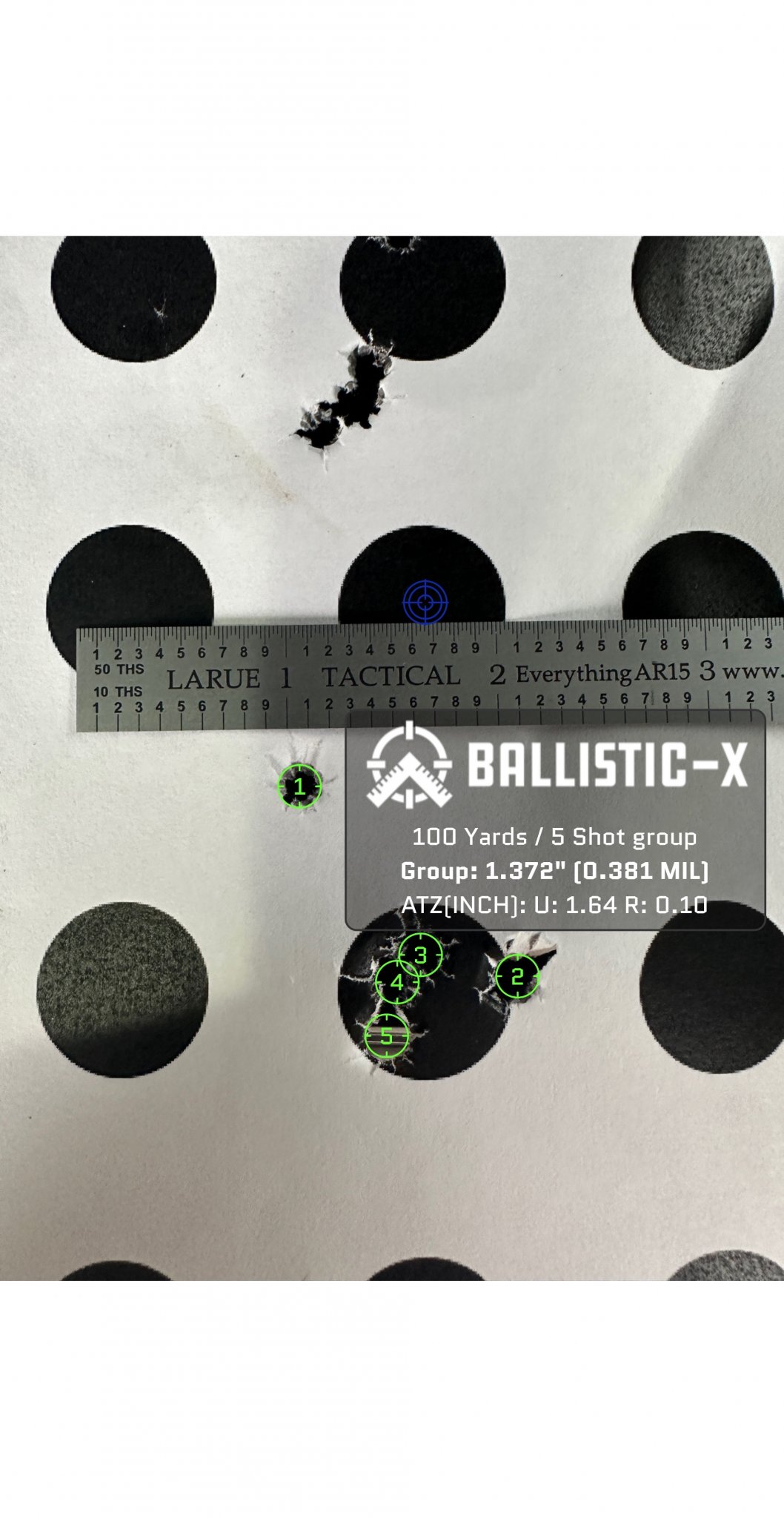

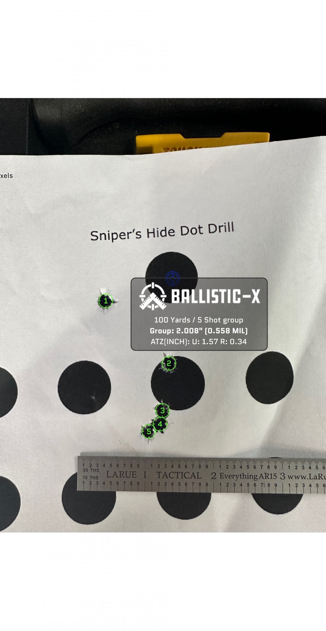

Old thread, but wanted to share.
73ELD-M
New Starline Brass
Powder - Shooters world precision - 25.7 which gives me 2675 out of an 18” barrel (OVER MAX) No pressure signs.
Primer - Federal GMM SRP
OAL - 2.256
This gun shoots in the .75” range with Atlanta Arms MK262 load, and that is what I have shot for a few years. Decided to start loading for this gun and figured I would give the 73 ELDMs a shot as they have a bit better BC.
I think this has great potential, I just have spoiled myself with so much bolt gun shooting that my fundamentals are rough and I am struggling to shoot the gas gun well.
Found the charge weight via a combo of OCW w/ a chrono, but really didn’t find any significant flat spots. The velocity was a pretty straight line.
73ELD-M
New Starline Brass
OAL - 2.256
None of my 5.56 rifles wanted to do any better with that bullet either. I gave up on it and stayed with the 75 BTHP instead, which shoots great in all my rifles.
FYI if you can find it, both 8208 and Benchmark will do about that same velocity with the 75 BTHP and the 73 ELD and are fairly temp stable to boot. Just an alternative. 24.0gr of 8208, or 23.5gr of Benchmark were both good accuracy loads for me with the 75 BTHP at right around that velocity, although the 73 still wouldn't group all that well.
You mention your powder gave pretty linear velocity increases, which sounds like a number of ball powders I like to use. With several of them, my load workup method in those cases is to find max and work out a comfortable pressure load from that, and then just work on seating depth to dial in accuracy. Leverevolution is one example (and it works great for high velocity 5.56 loads, faster than anything else you'll find, but there's no published data) - I find max with bullets as close to the lands as feasible, back off a hair, then just adjust seating depth for accuracy. If it's not good enough, then I'll try a few different primers; usually some will shoot better than others.
Reactions: Gentleman4561
