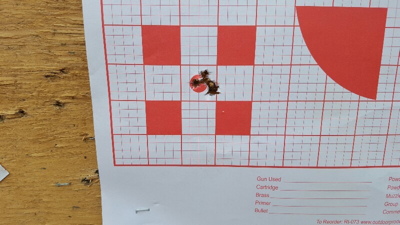

I'd say the hornady .260 match works well. It performs as good as prime in my tikka ctr with 20"barrel. Sorry, but I wasn't able to get mv data today. It produced this 5 shot group with me doing my part. Hornady_groups.jpg
Yeah I'm happy with the performance. I'll have to get it out long range and see how it does. Hornady offers a b.c. for various distances on there page, I'm gonna see how accurate it is, but I'm betting it's good to go.

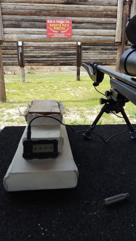

I went to the range today and got muzzle velocities from my 20" TIKKA CTR in 260 WITH THE Hornady .260 ELD. I FOUND out a few things.
1. ES was 65 from a 10 shot group. That's a little higher than I hoped for.
2. MV was an overage of 2667 fps. That was better than I hoped for. Nice!
3. SD was 23, so not bad or great.
I did measurement with a magnetospeed sporter that I picked up from the midway sale.
My brother in law shoots their 140 gr match ammo in a 6.5 Creedmoor. I can post that data too if anyone likes but his ES and SD WAS better then the .260.
Overall I'm good with the Hornady match. It groups well enough and I plan on looking at the Prime, Federal and Gorilla soon. I'll make a separate thread for those if it seems people like having the data.
