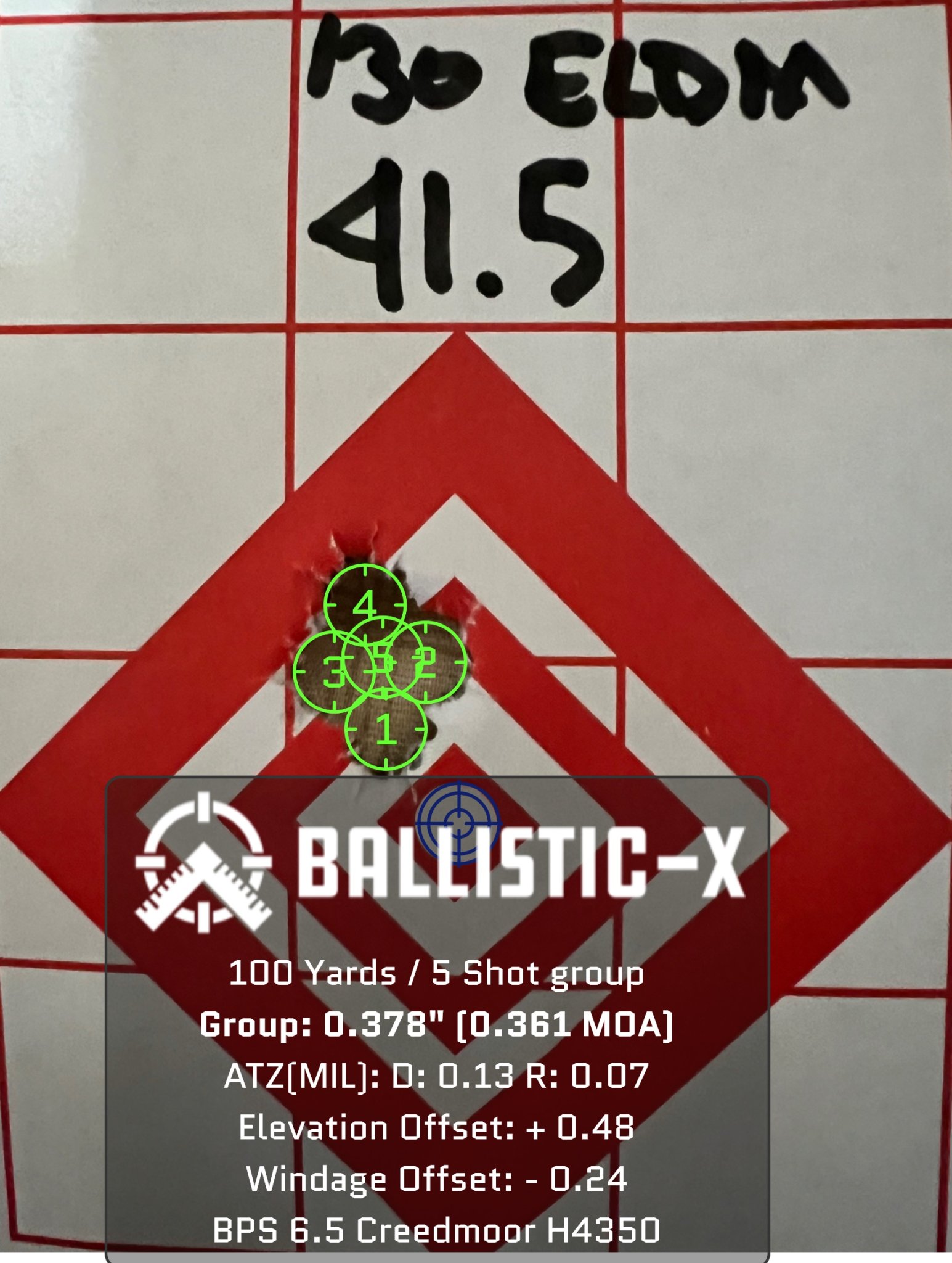

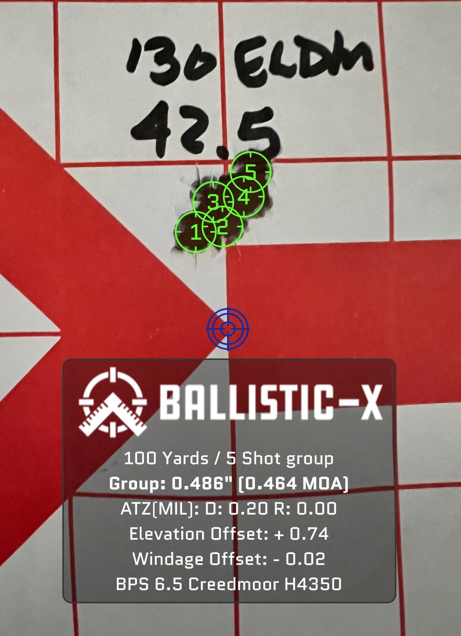

    They are very forgiving. I set them to 2.810
    Ballistic-X-Export-2022-09-20 18:35:22.886841.jpg
    Ballistic-X-Export-2022-09-20 18:45:31.285102.jpg
