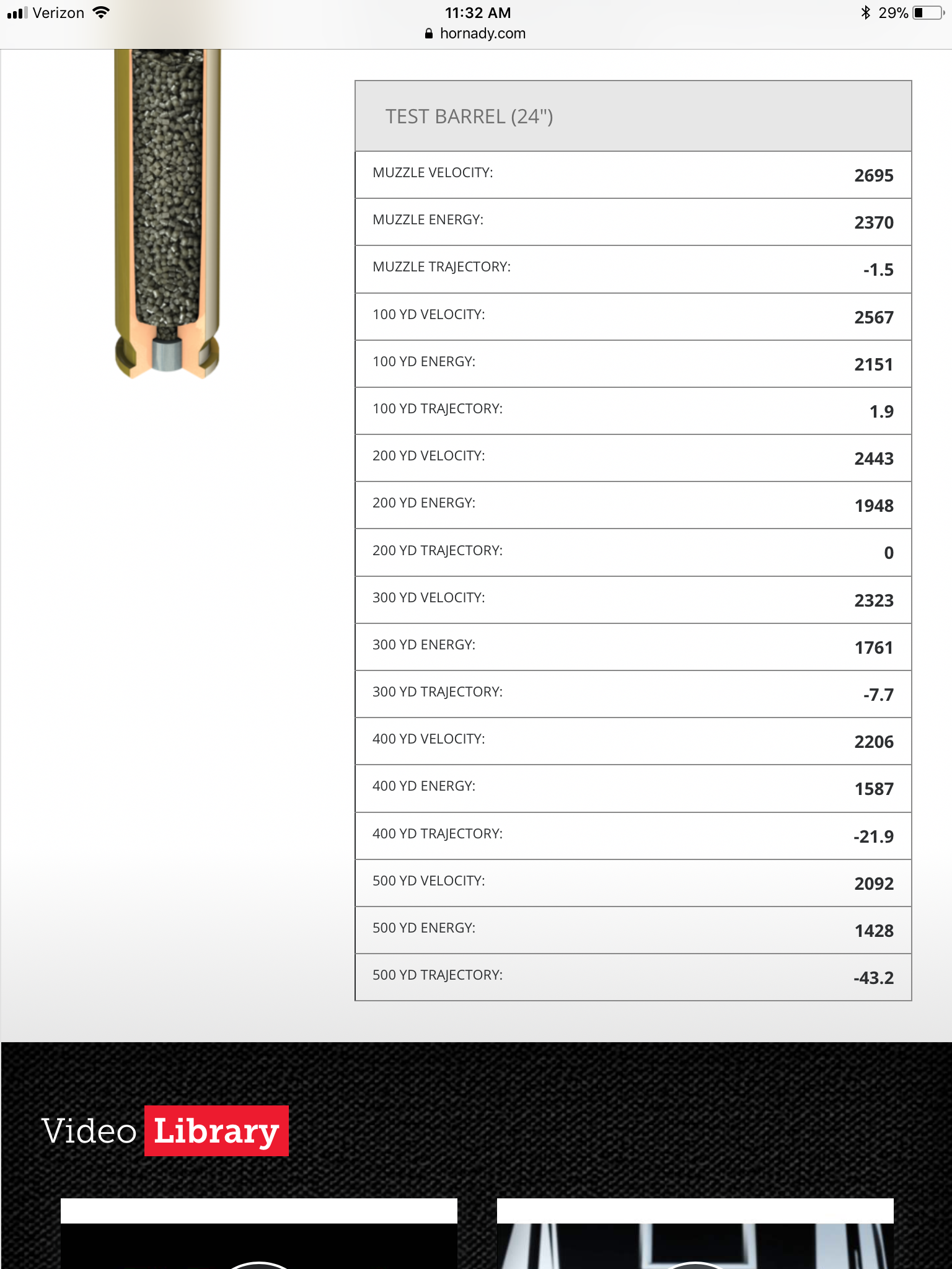

Just run the numbers in JBM using realistic velocity ranges for your barrel length. You’ll get really close.
Not 100% sure what you’re asking either. If you’re asking about factory ammo. The Hornady 168 ELD-M Superformance is for sure my favorite factory ammo in 308 these days. Really closes the gap between 308 and 6.5 Creedmoor.
https://www.hornady.com/ammunition/rifle/6.5-creedmoor-147-gr-eld-match#!/
https://www.hornady.com/ammunition/rifle/308-win-168-gr-eld-match-superformance-match#!/

Only listed at 2600fps from the box spec so probably a 24" barrel. At that speed they are about at 1179fps at 1100. if he loses velocity it might drop off on him depending on his elevation.
