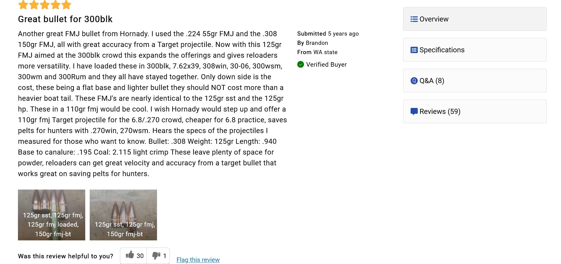

From the MidwayUSA reviews...
IMGScreenshot 2024-04-21 at 07-54-46 Hornady Bullets 30 Cal (308 Diameter) 125 Grain Full Meta...png
From Ultimate Reloader.. and I would consider using 125gr load data unless you have a manual that shows your specific bullet.
