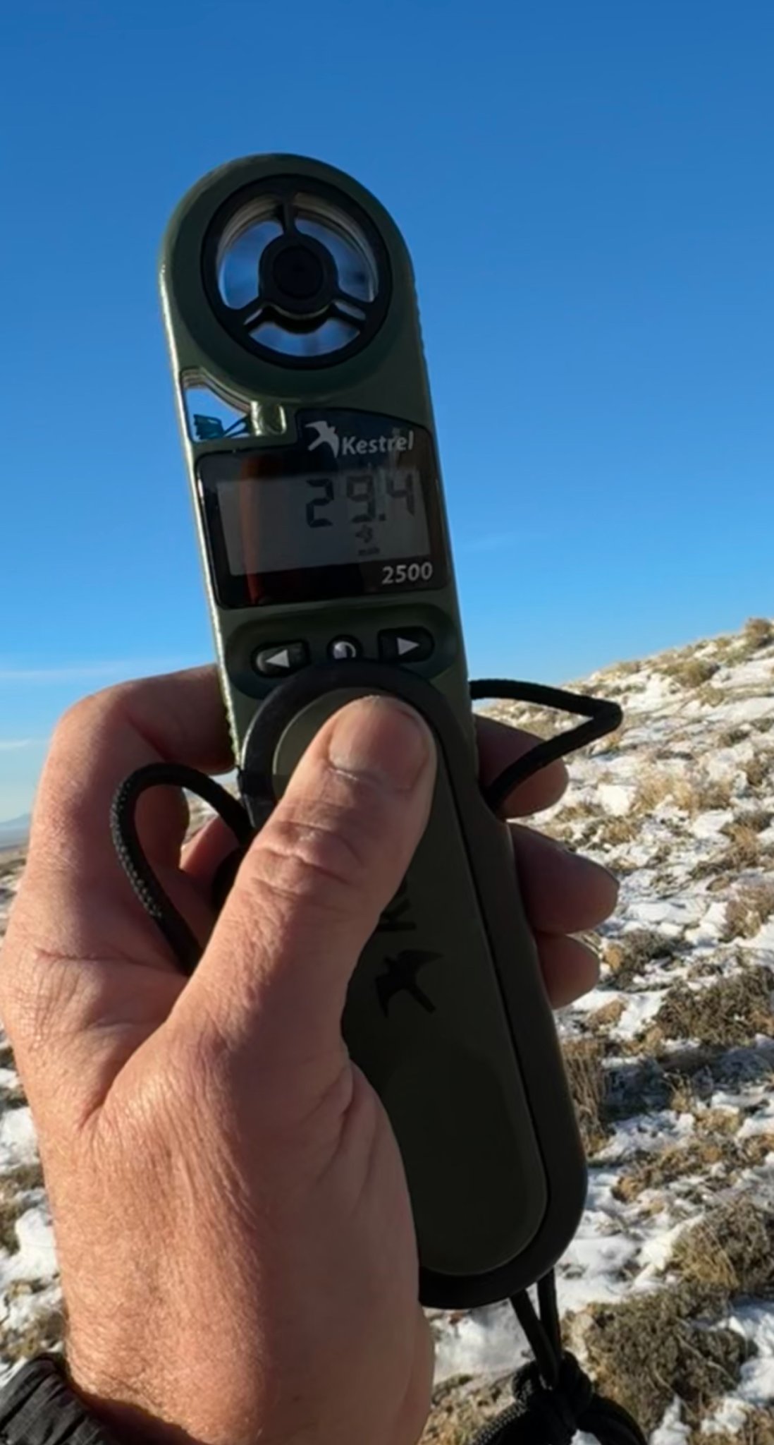

I used the Hornady 4DOF app on my phone this summer for practice. I used an older Kestrel to input the wind by hand. It worked well.

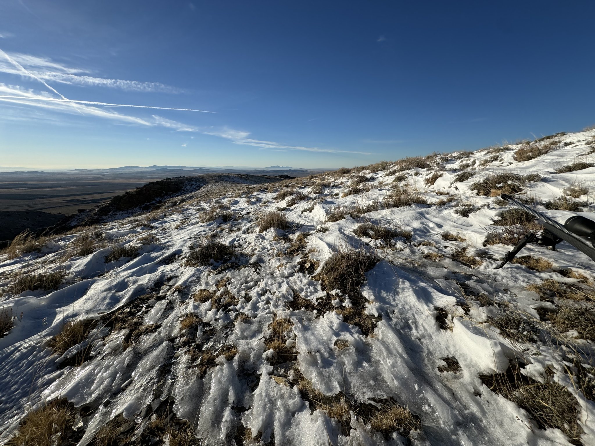

Then I got a surprise while hunting. I was hunting in an area without cell coverage (typical).
There was a deer 482 yards ahead of me, downhill shot, 29 mph. I wanted an aiming solution from the app.
I pulled out my phone and found out that the Hornady app dropped me. It wanted me to log in again. I tried to log in but that requires cell phone service.
So I have learned that the Hornady 4DOF app is not useful without cell phone service.
So I will switch.

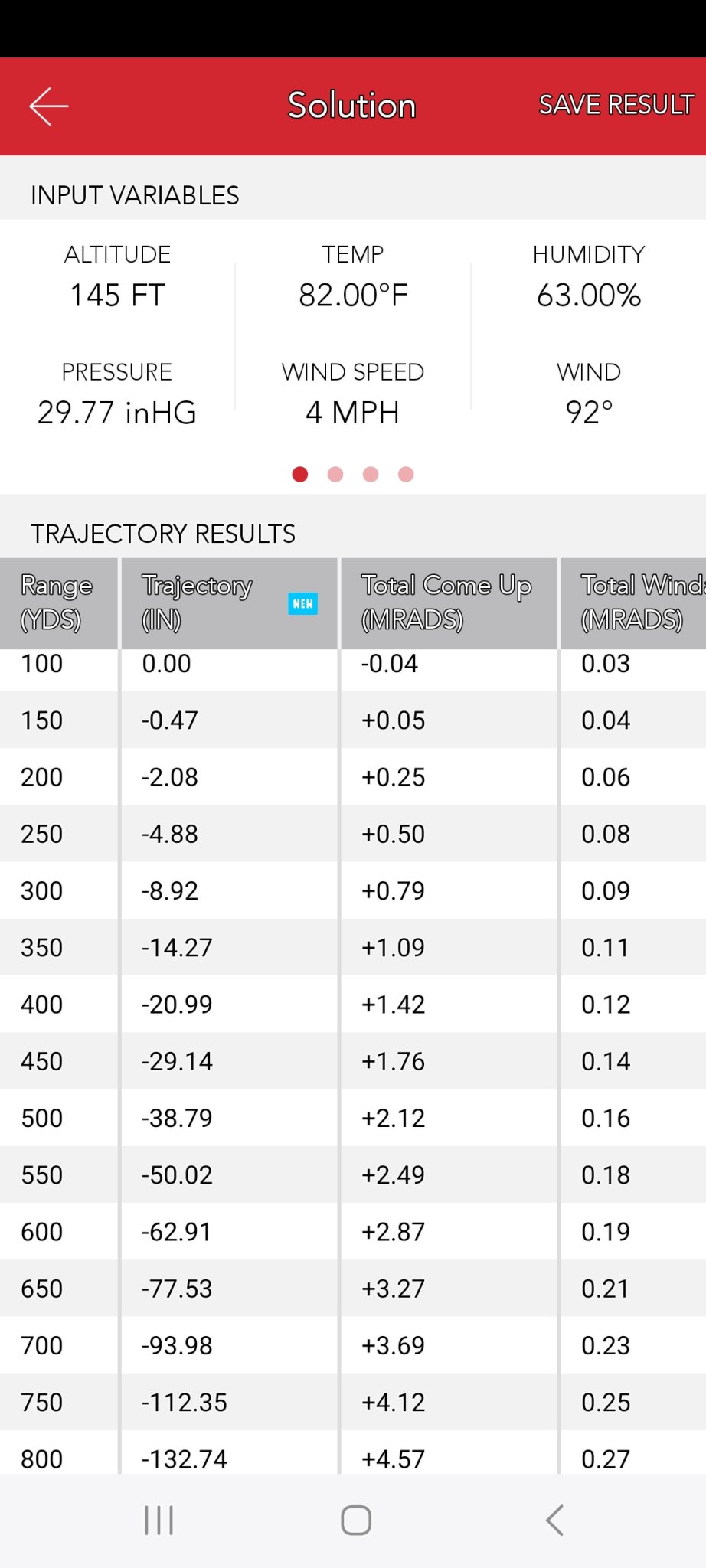

I just now put my phone in airplane mode to test if they changed something. The app recognized it wasn't connected and opened up with no login prompt. All my rifle profiles were still present and usable.

I just tried signing out then closed the app and went back to airplane mode.
The app will allow continue without account, but yep, none of your favorites will be accessible. So yeah that would a nasty surprise if you needed to re-enter things by hand to use it.

I ran into this issue too and found it very irritating. My fix was to go into Settings (iPhone) and disable the app's access to cellular data. Now it just opens in Offline mode, and all my favorites are stored locally on the phone.
Obviously it won't pull down new info like new bullets in the library, app updates, etc., but that's a small price to pay (especially since most of their updates are milquetoast at best).

In iPhone, to Settings and:
1. Turn off WiFi
2. Under Cellular, turn off Cellular Data
I never log on at all (didn't create an account to my recollection). Another approach to try is to go into 4DOF Settings and turn on "Offline Mode". Personally, I also turn off Auto Sync.

I use 4DOF weekly at my range that has ZERO cellular service. This on a lowly iPhone 12.
Thanks for the reply. As I can once in a while find a spot with phone service, I like to keep the phone in regular mode. When I find those spots, I can catch up on texts in case there has been an emergency.
The offline mode in 4DOF will not effect your phone service or ability to download txt, etc.
It only keeps 4DOF from timing out if there is a too-weak-to-download but present signal that it detects.
I just turn it all off at the range (4DOF and cellular data) as the present but very weak signal does occur at my range. Just the offline mode should work but I'm a suspenders and belt kind of fella. haha
