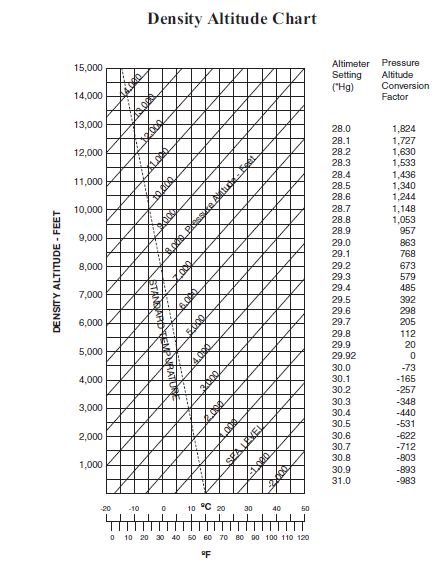

If the actual altitude doesn't matter then explain to me why in every DA chart ive ever used requires me to know my pressure altitude?
The reason is because you don't know what standard is where you are unless you know your ALTITUDE/ELEVATION. You don't have to be exact, +- 500 ft is more than adequate, even within 1k is fine. But elevation absolutely matters

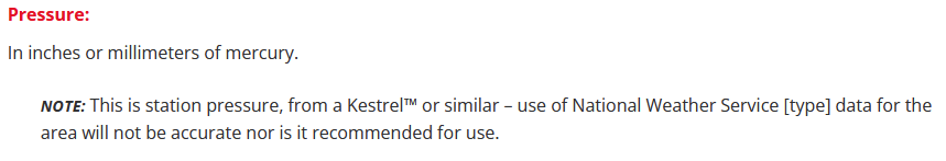

But according to Hornady, it does though. And it's a required input on both the web app as well as their iOS app, but not required in the Kestrel w/ 4DOF solver.
"Height above sea level. Unlike other ballistics programs, altitude and pressure must both be input into the 4 DOF. Based on altitude and pressure value, a custom table is built within the program to properly model atmospherics."

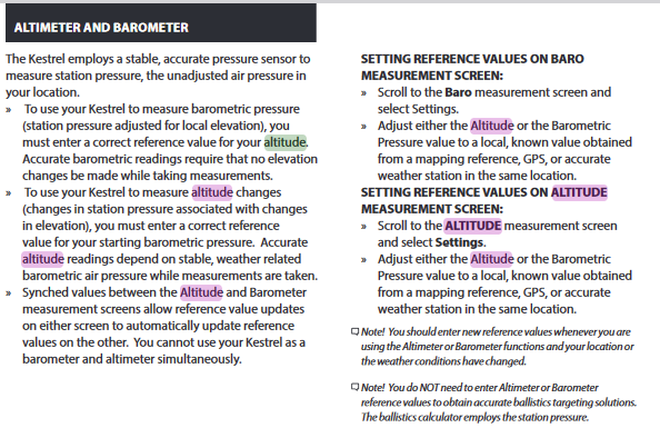

Ah, it does? My Kestrel with 4DOF want SP…station pressure which along with temperature and humidity from which it can calculate density altitude.
My 4DOF app on my phone (to me, much better interface) does want altitude (MSL) but if you go on Hornady’s 4DOF site, the technical document, it says they do so in order to modify the shag curve due to pressure drop as the projectile climbs and descends along its flight path.

It doesn't need the altitude input to back into the station pressure because the meter has captured that (the station pressure).

First, we both seem to agree that the Kestrel 5700 w-4DOF does not use altitude in any way for ballistic solutions. It does use temp, station pressure, and humidity to calculate density altitude which is pretty much all that's relevant to a ballistic solution.
Kestrel does have in its weather portion altitude and baro pressure. This seems to be there to allow one to calculate changes by making one or the other as primary and the other calculated thereof (see below).
From Kestrel docs:
"For Kestrel 4500 Ballistic and 5700 Ballistic meters, the ballistics calculator will ALWAYS use station pressure despite the altitude number that is entered.​
  • If you want station pressure, set your reference altitude to ZERO on the Baro screen (4500 Series) or just view the Pressure screen (5000 Series).
  • If you want your altitude to display correctly and have station pressure, you will need to enter your current barometric pressure as the reference barometric pressure. The reference altitude should remain ZERO, and Sync Alt should be OFF."
So, for our ballistic solution purposes, altitude in the Kestrel is not relevant. My 5700 measures temp, humidity, and station pressure and so I'm good to go. Right?

Uh, you mean when you ,manually enter station pressure? Below is from the 4DOF web site and the ? in the circle on the app says similar...SP.
I'm pretty sure it's a stop-gap tool for the user that doesn't have a barometer but knows their general altitude. Plug in altitude and it auto-populates barometric pressure for a "standard" day at that altitude.
I guess that's a reasonable work around for not having SP available. Sort of.
The solver, as near as I can tell, uses the barometric pressure to get air density and uses that as the reference point, not the manual altitude input, for the density gradient for high angle or high max ordinate.
Again, I'm guessing that you really meant station pressure. And yes, it seems reasonable that if you have SP, temp, and humidity (everything needed for DA), and you use the shooting angle function in the app, that it can then calculate a solution even accounting for a high angle/high increase in altitude shot by using standard atmosphere lapse rates.
