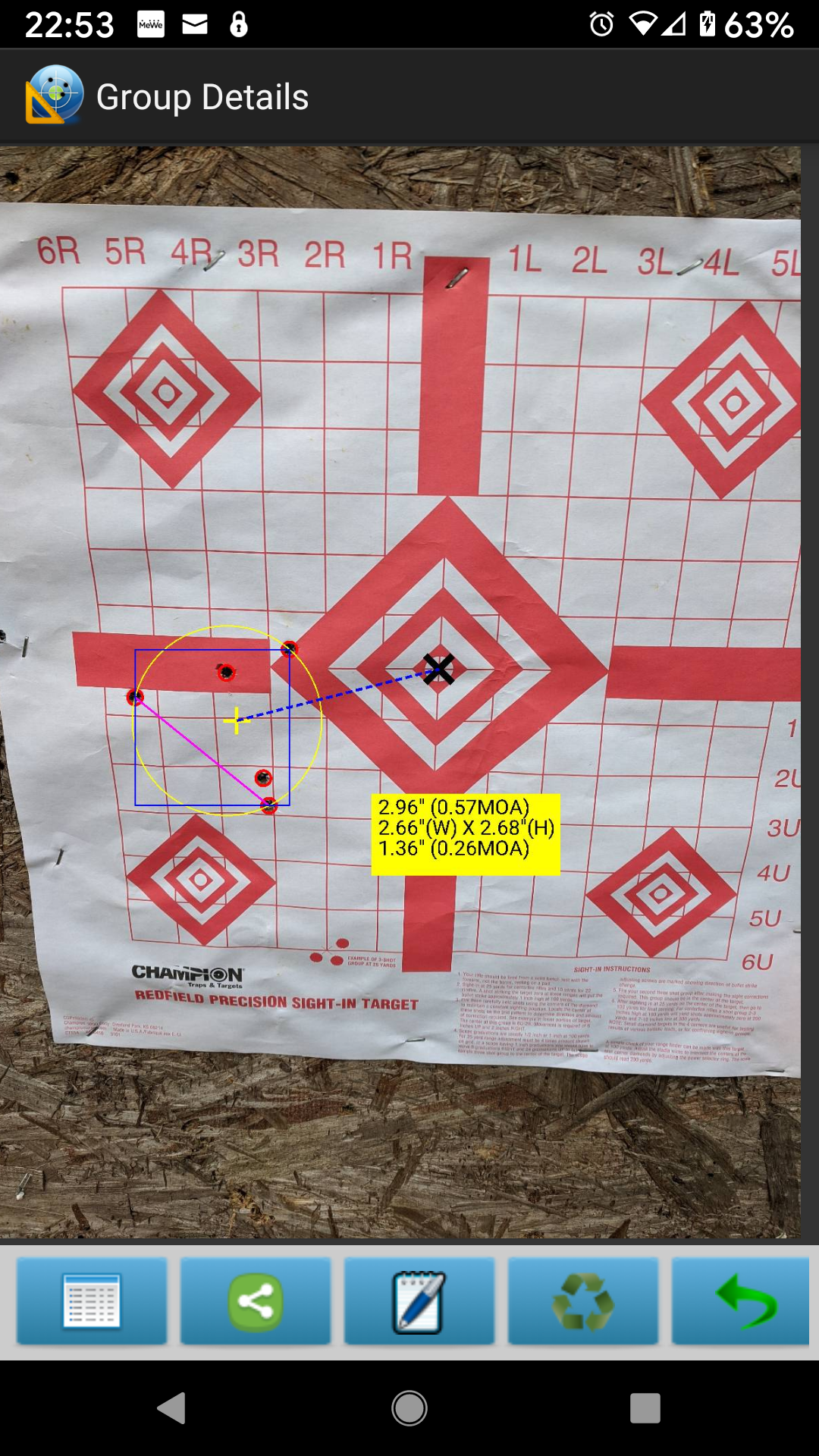

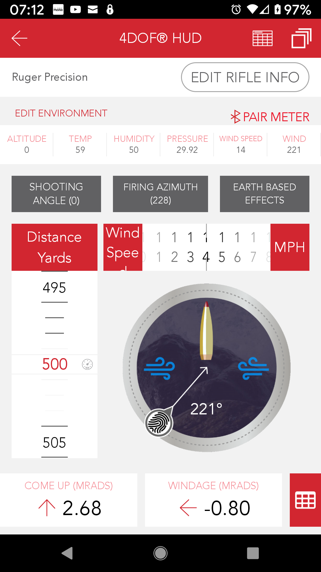

Be easy on me here as I'm new to ballistic apps and some longer range shooting.
I'm just curious on how to properly read this wind data. If the arrow points to the left is it a .80 hold to the left and vice versa if it points right? I dialed the wind hold.
Shot this target at 500yds and ended up left of center (POA) and wasn't sure if I was right on what it was telling me.
Appreciate your help.

I would say yes. I haven't paid for any upgrades. I've had the app for about a year or so. Does your app have it?
Here's the version I'm using.
version 2019.1029.235
No, mine just had the one row of numbers. What’s your bullet, and velocity? I’m curious if I punch in that data If the output would be close to yours or different? My hud is attached

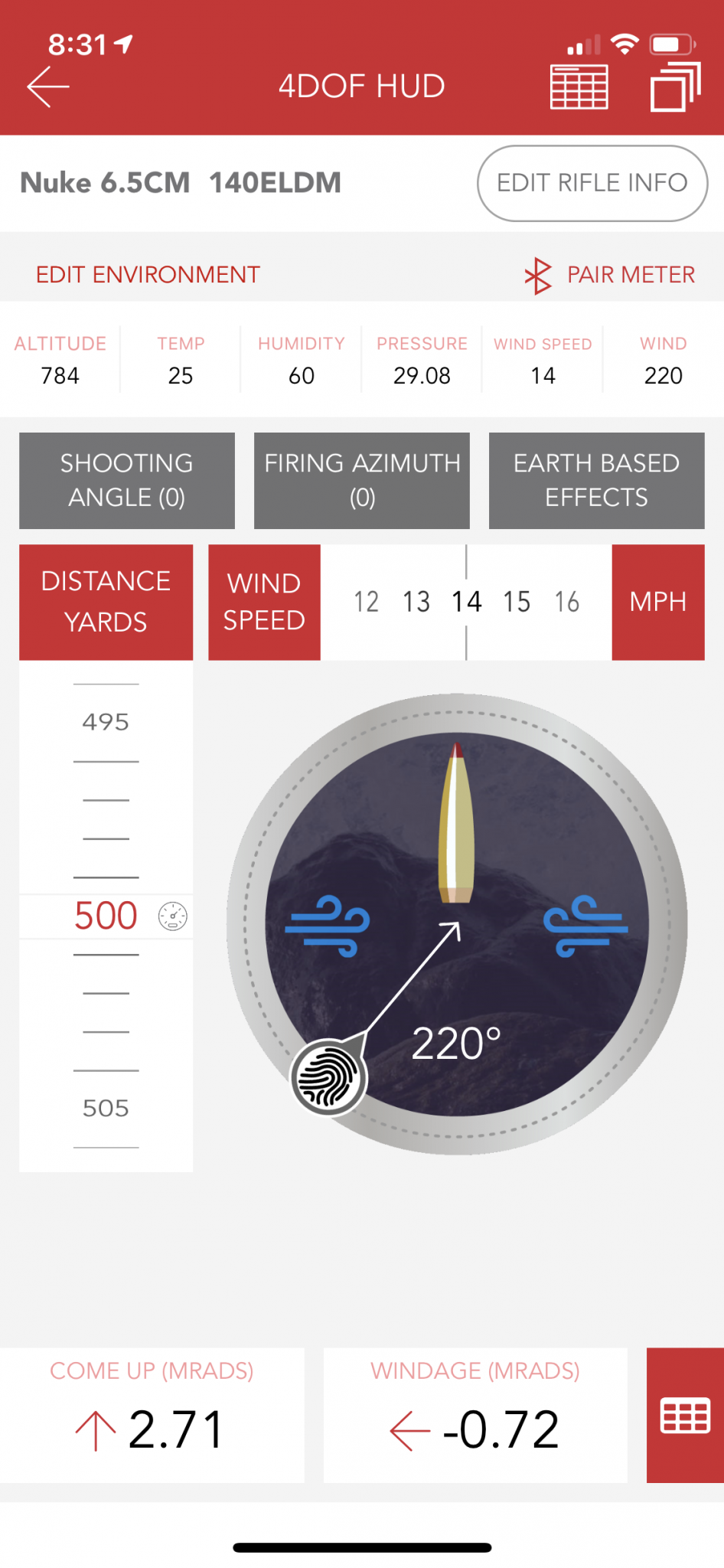

I use the same app. It seems to work well with the ELD-M's out to 1100. I use the local pressure and set my elevation to 0. You can also change the drag factor up and down to true the dope. Winds from behind and in front that are at a slight angle are the trickiest for me. I'd much rather shoot in a direct crosswind so I can read the mirage better.
@Skunkworx 140 Eldm 2733 fps
I can’t quite duplicate your windage outputs but was sorta close at .73 Mils with a 14 mph wind at 221 degrees. I guess my next question would be how did you determine the wind was really at 221 degrees? Just updating the wind vector to 200 degrees cuts the windage in half. What’s your wind angle determination method just for reference?
I used a compass to figure out which way was north. I then used my local weather app to see which way the wind was blowing. I may not have a true exact angle of 221, you can say it was my best guess based off the information I was using.
All of this was completely experimental. I've never shot at 500 with any regularity nevermind with wind.
Your #'s are pretty darn close. There maybe some other inputs I have in the app that aren't getting you to where I'm at. Just a guess.
