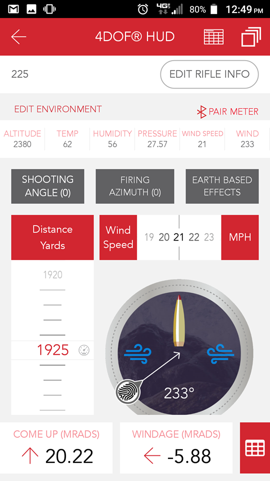

I'm headed out today to shoot some 225's out to 1600+. Possibly sling a few at 1900 but it's 20mph wind so no promises. I should for sure get good data to 1200. I'll keep a long of enviro data and actual dope required and if I remember will come back here and compare.
225 ELD-M
2910 FPS (Lab Radar)
2.56" sight over bore
POI is 0.9" low at 100yd-- I use zero angle in 4 DOF so I don't really worry about having an exact 100yd zero so if you use a 100yd zero, figure a .25 mil offset accordingly
Zero angle: 0.6867
1:9 twist barrel
1.08 Axial form factor (everything in this barrel has been 1.06-1.08)
Enviro data is on the screen shots.
This was 4DOF today and it was spot on for elevation out to the 1925yd target. Prior to the screenshots below I walked out 100, 600, 800, and center punched everything (IPSC torsos). I was 2/3 at 1200 (18" disk I think), 2/5 at 1637yd on a IPSC torso, and 3/10 at 1925 on a 24x24" square. Misses were all wind except for 1 high shot at 1637-- it varied from 13mph to 24mph and was fairly gusty, hard to be repeatable past 1000.

Using the Hornady G7 side this is what I need to get similar outputs (accounting for my .25 mil zero offset):
1202: G7 BC of .400
1637: G7 BC of .402
1925: G7 BC of .398-.399
