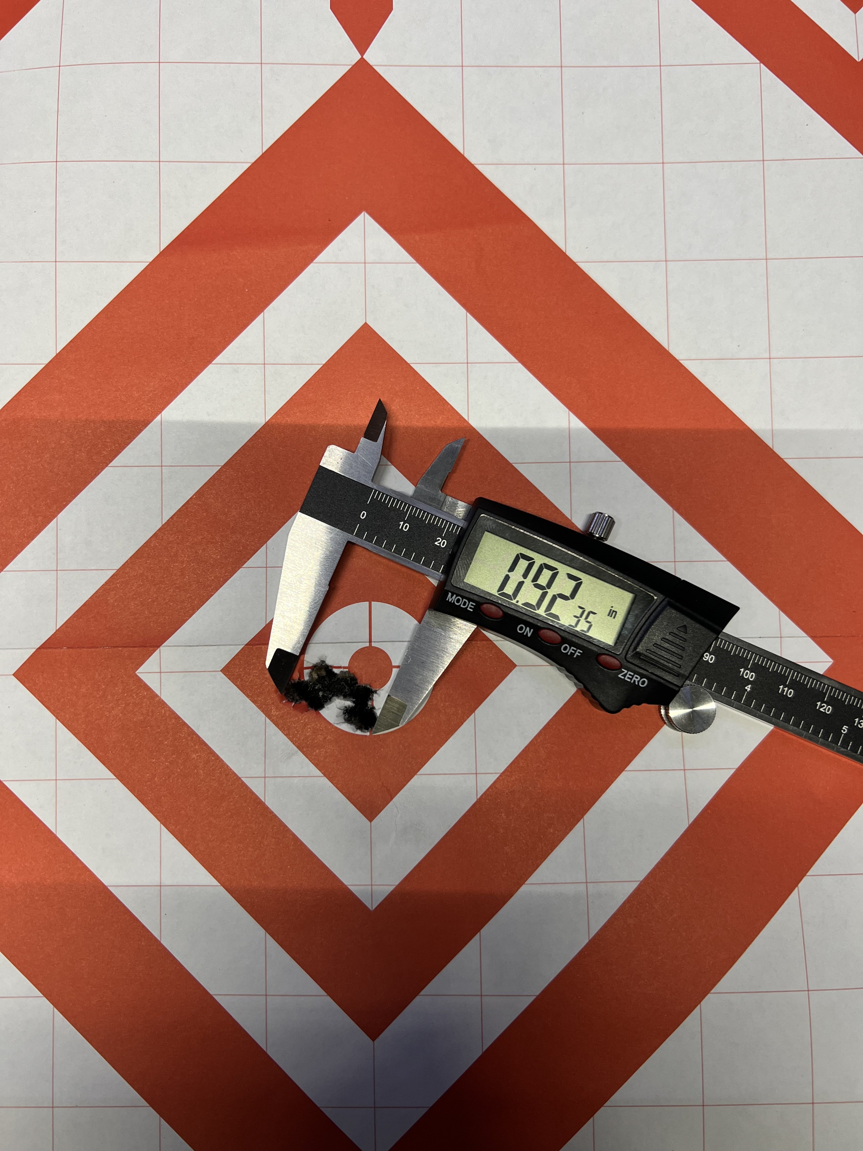

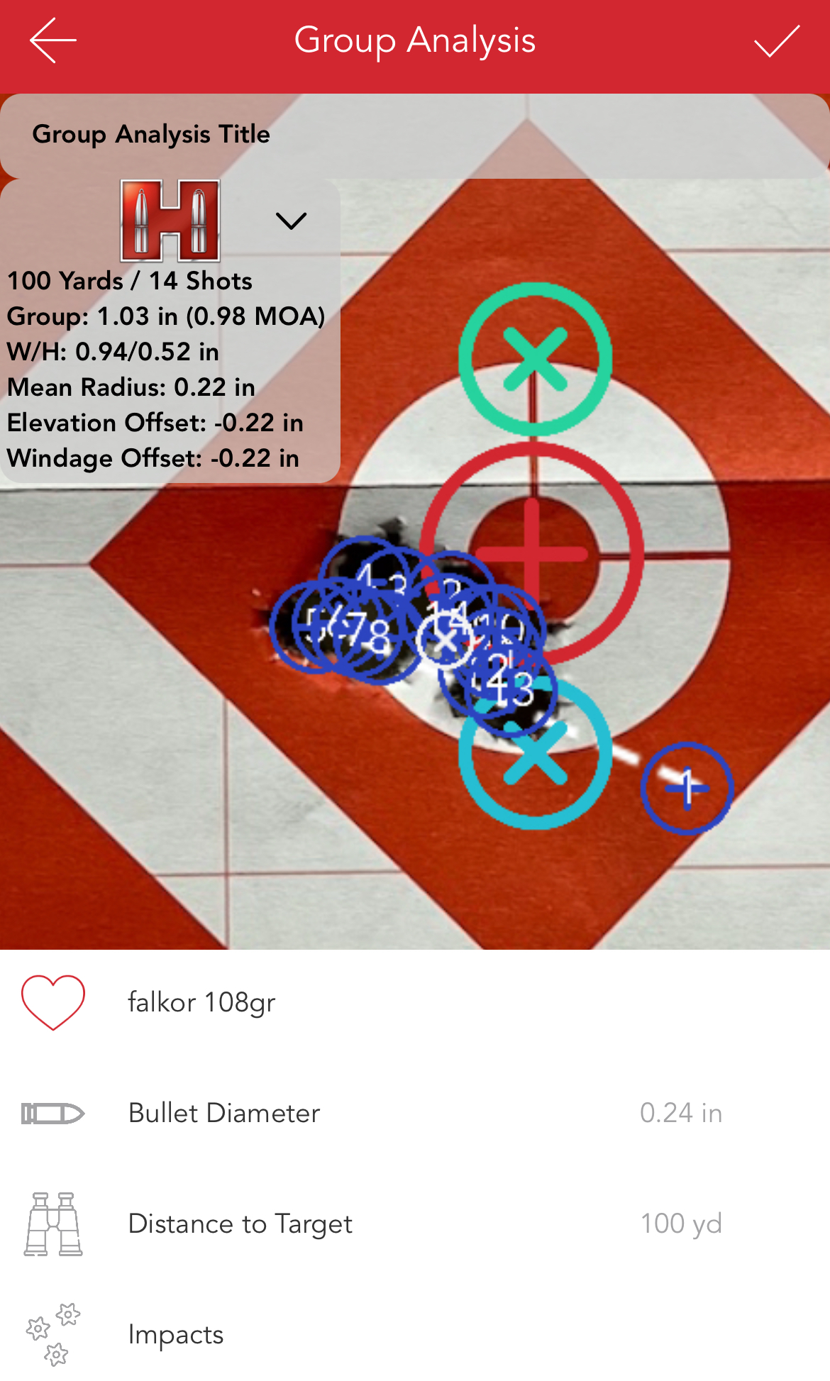

I’m using the Measure Impact Location feature in the app and a picture of a 14 shot group. It was shot at 100yds indoor so i left the wind values at zero.
Typically when i zero this gun my 3-5 shot groups are less than 1/2 MOA. This 14 shot group (pics attached) widened out to about .9 MOA.
I think I saw in one of their videos that it’s OK not to float and zero the turrets after performing the group analysis because the app knows where your POA was in relation to your impacts. Is this the case cause it’s messing with my head?
No “zeroing” required. The zero angle will correct for your average group center being .22” left and .22” down. Of course, if you want to to come up and right with your dials, you can and then either shoot another group (five shots should be plenty) and tell the zero angle calculator about the new average group center. Or, if you wanted to, you could adjust the turrets and then just correct the data fed to the zero angle calculator without shooting the group (come up and right 1/4 moa and then tell the app that your average group center is .03” right and .03” high) All the ways will result in something fairly close.

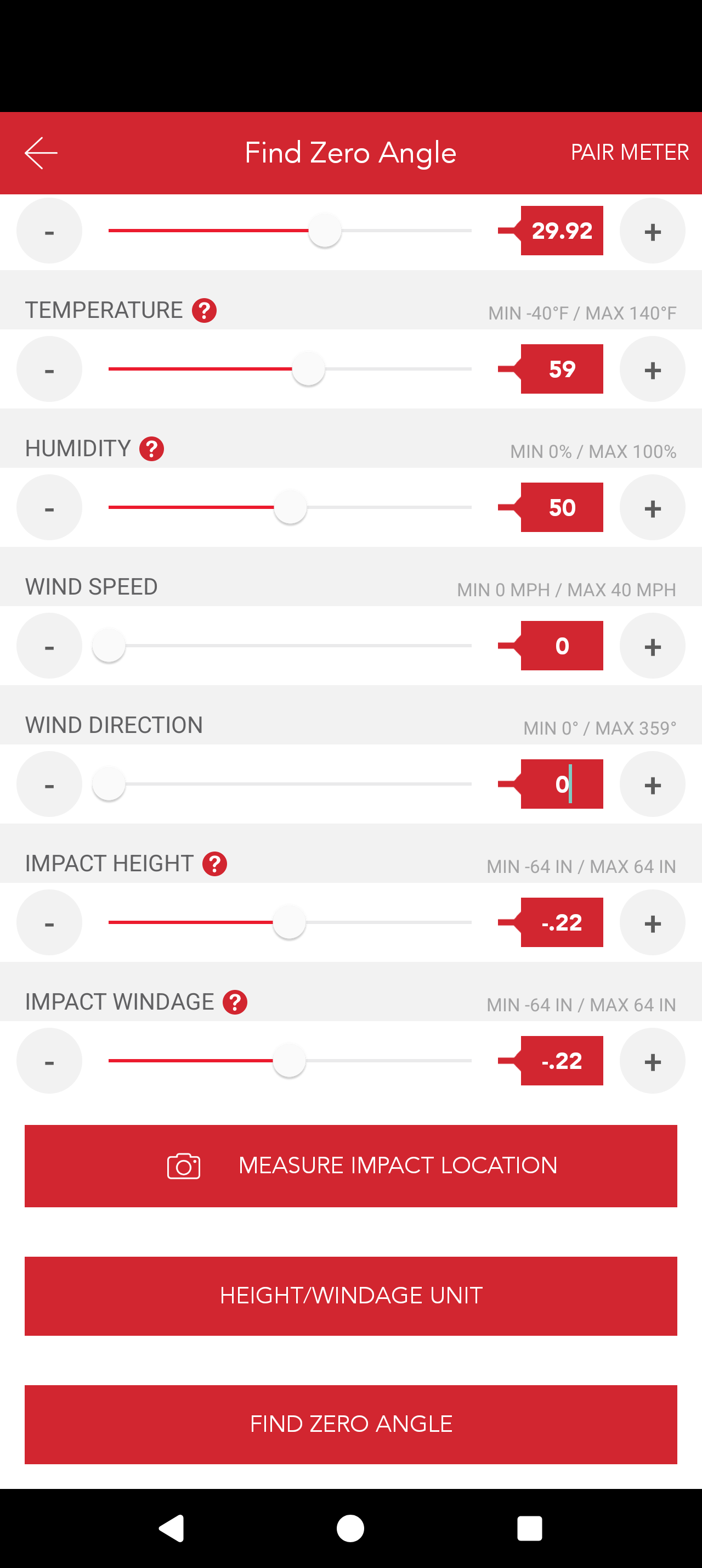

So in the process of setting up a zero angle, it will ask you for all of the environmental conditions, the height of your scope over the bore, MV, twist rate, etc... and most importantly the distance and MPOI impact location. All you have to do is tell the app where you hit (MPOI) and what distance and it will do the math to generate what the muzzle exit vs. optic zero angle had to be. (0.06-0.09 degrees usually).

Based off of your target, here's the inputs in 4dof to find your zero angle. The rest of the stuff above this is unique to your load/rifle and I have generic sea level environment.

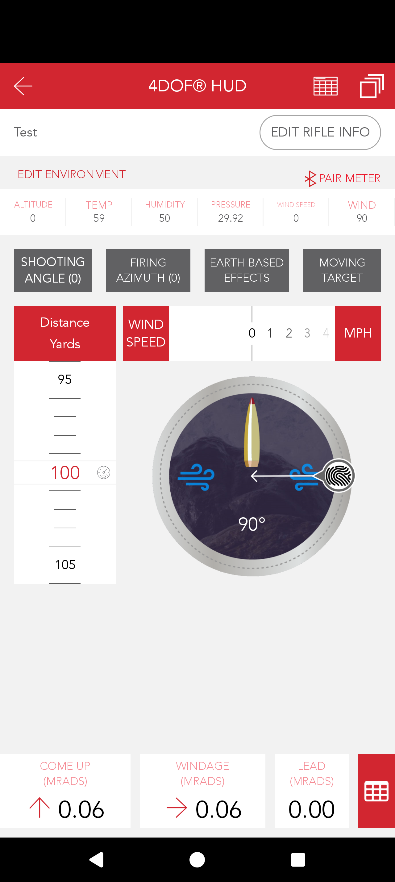

After you do that, you can verify by putting in 100yd, no wind and see what correction it tells you. In this case it says to impact perfectly dead center you need .06 mils (.22" at 100yd) up and right. So this minor deviation in 100yd "zero" will carry through in every down-range calculation you use with this file.
