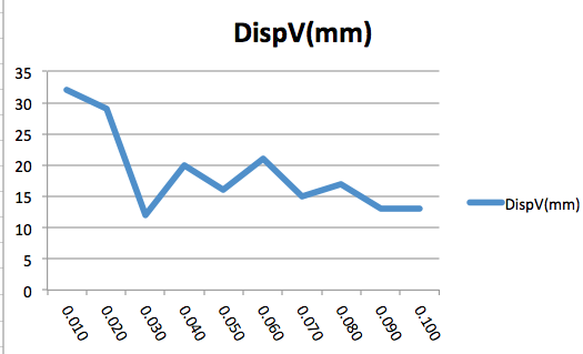

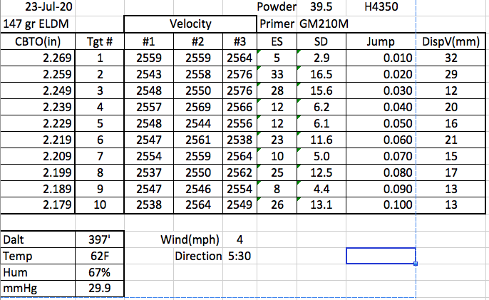

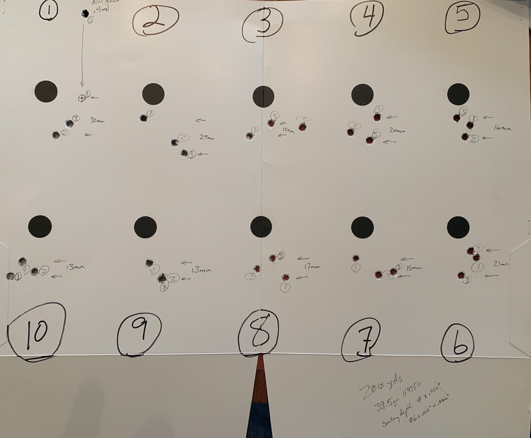

I ended up abandoning the lands chasing. Getting to the lands pushes the OACL to max magazine length. I did a seating depth test also. First time. I’ll throw my data out here. I expect to get pillaged. Haha.
