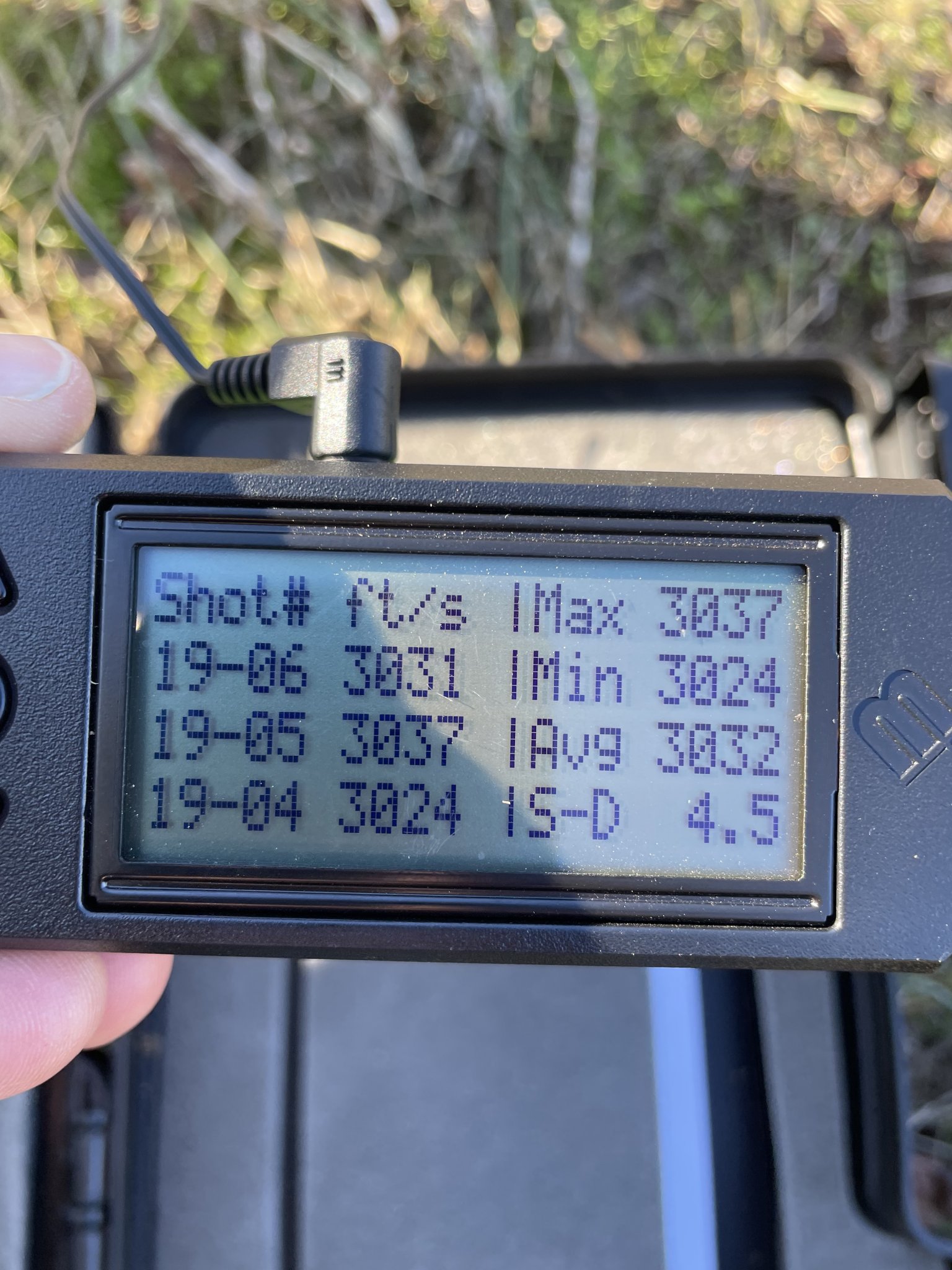

This is on the 3rd firing. 110 Atips H4350
