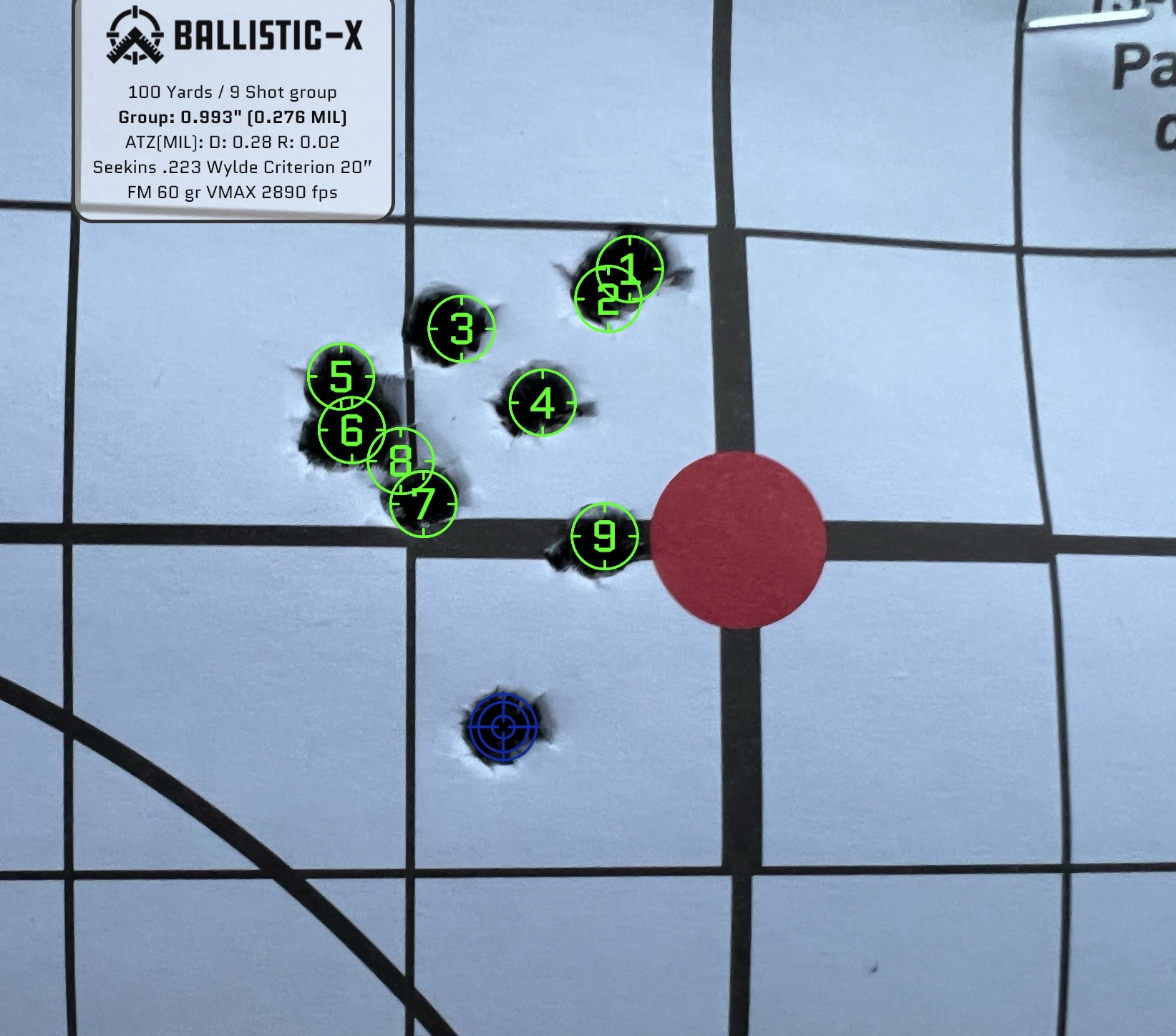

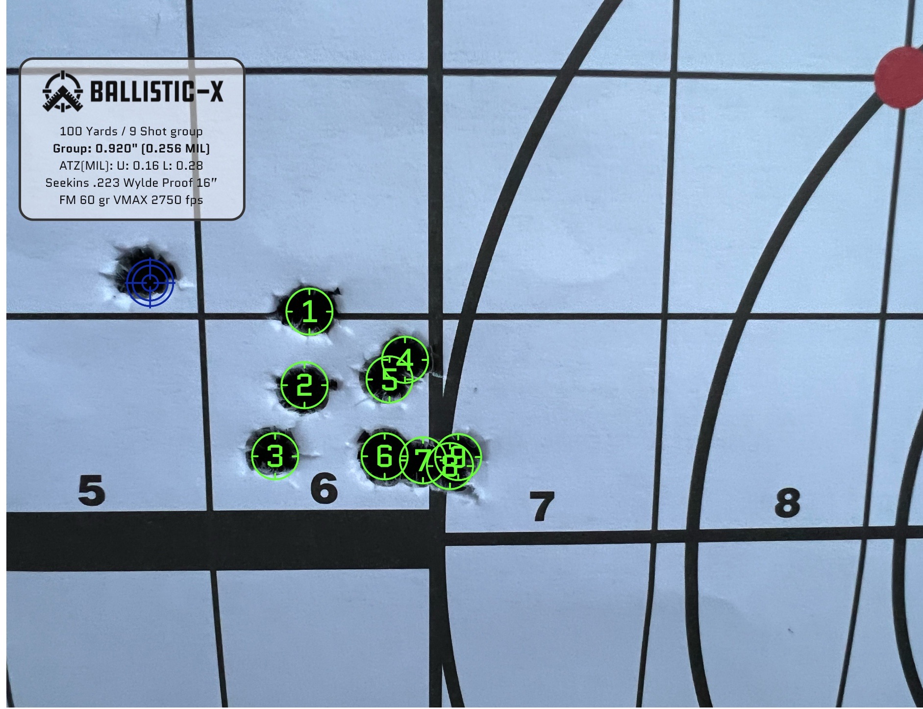

The new 60 VMAX grouped approx 1 MOA x 9 shots. 6 shots were approx 0.7 MOA out of ARs.
I’ll have to look at the reman 60 VMAX brass when I get home since that’s what was actually in question.
