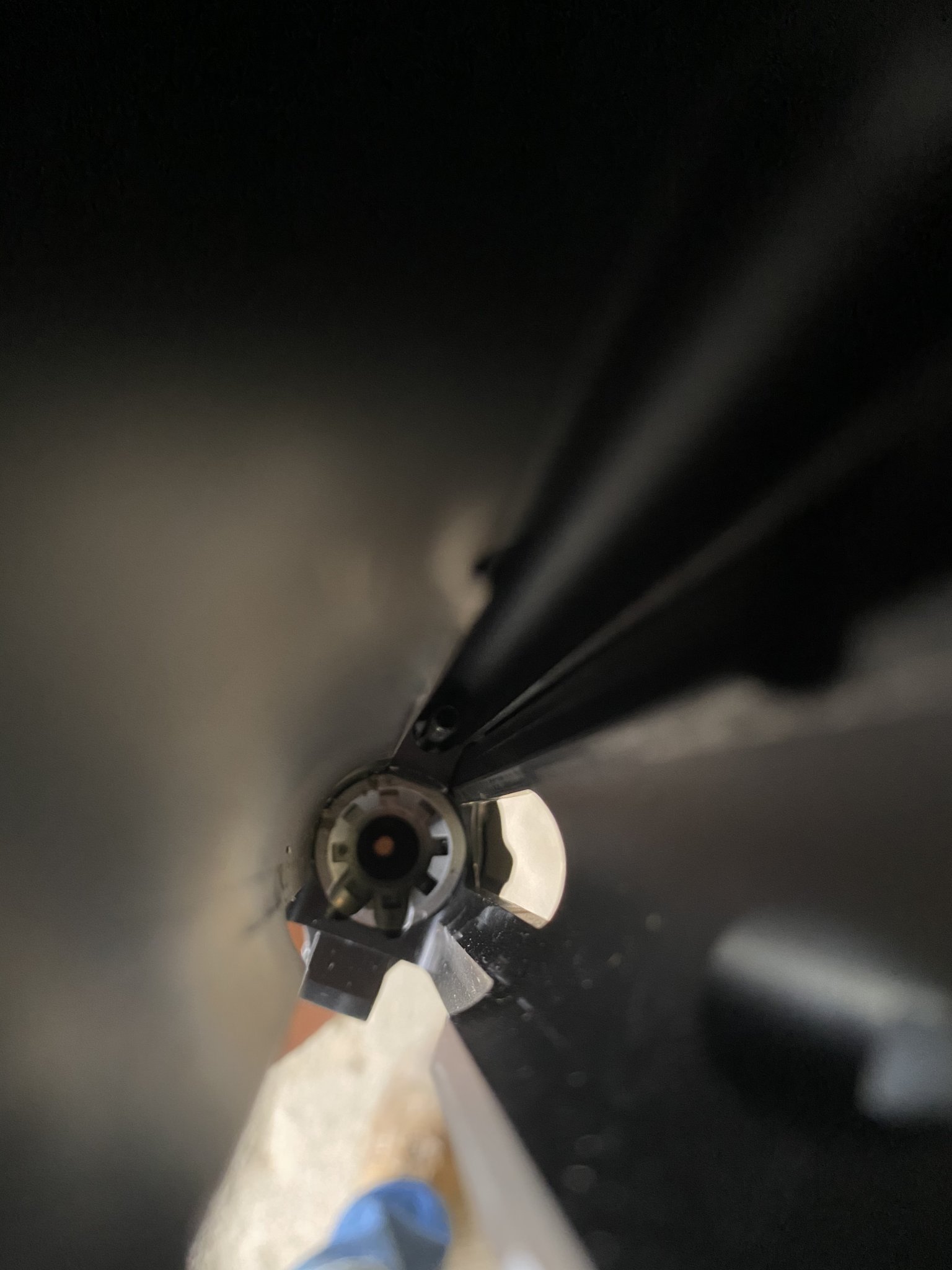

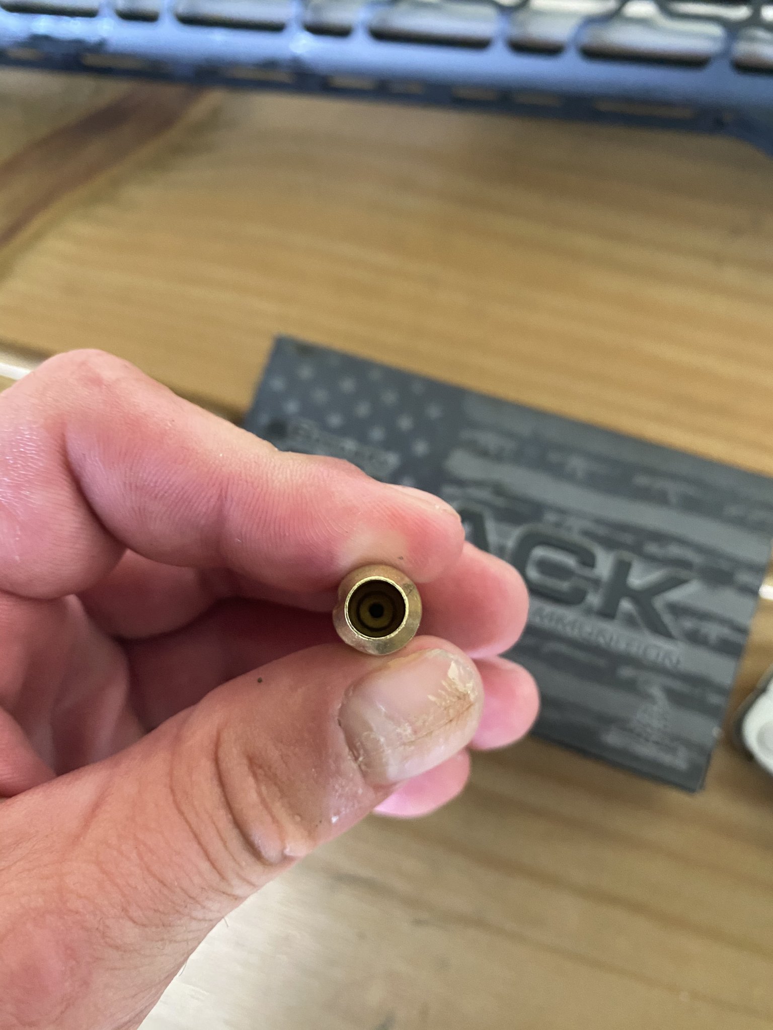

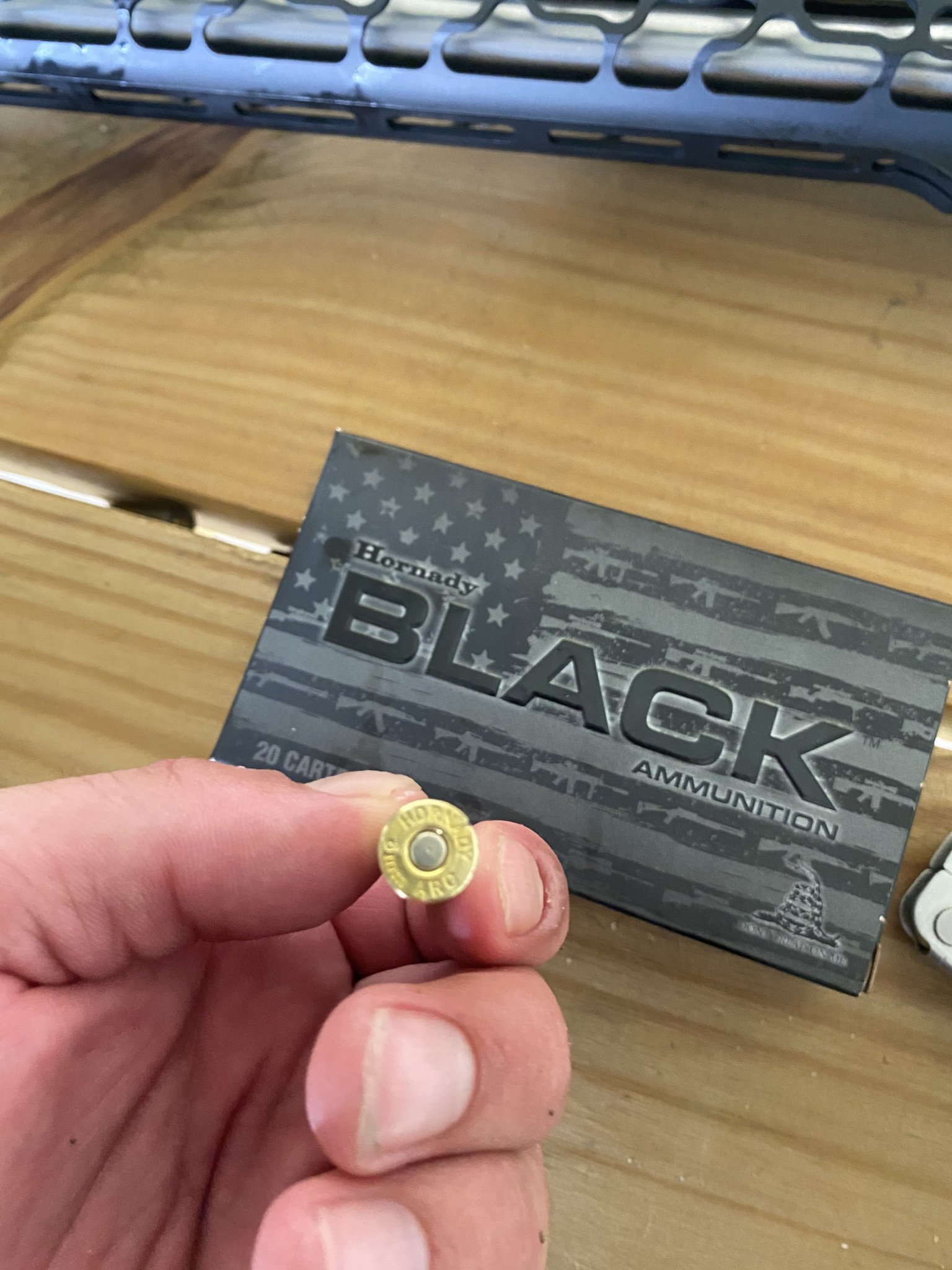

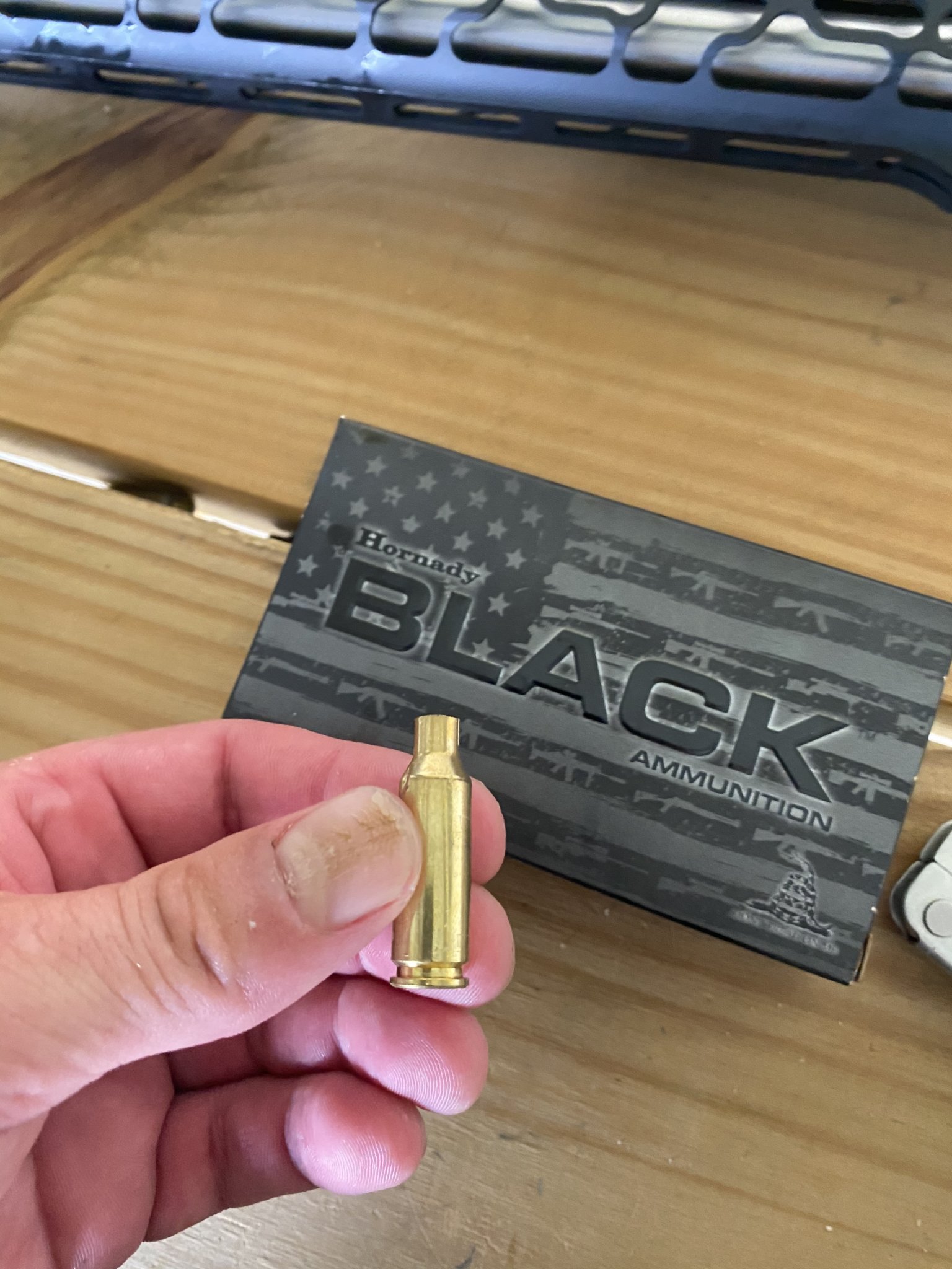

I took my new Odin Works 6mm ARC complete upper out to the Panteo range today to zero and get some initial data on the new cartridge. As I was about 12 rounds in, the range went cold so another shooter could replace and check his target so I safed my rifle and ejected the chambered round. After the range went hot again I tried to chamber a new round but it failed to chamber. I conducted a failure drill and cleared the round and magazine. When I inspected the chamber I saw a projectile lodged in the chamber without a casing behind it. I found the casing and observed an unfired primer, so I knew it was the suspect case that left its projectile lodged in my gun. Below are specs and pictures of the ammo failure:

I don’t know if I would just arbitrarily state this as ammo failure. Need some chamber and loaded round measurements
With all due respect, I didn’t think my report was arbitrary. It’s factory loaded ammunition in a reputable company’s chamber/ barrel specifically made for that round. There are several factors that go into such a failure but I was just reporting facts with picture evidence. Any help or guidance is greatly appreciated, sir.
I’m going to send all the data and pictures to Hornady in the hopes they can help solve the problem and keep improving the round for our guys in harms way. No disrespect was meant to Hornady by posting this report.
At 12 rounds I doubt a carbon ring is the culprit here. What I am wondering is if the chamber job was meant for the 108 ELD and the 105 HPBT is contacting the lands sooner, resulting in a jam.
Have you measure the remaining unfired rounds? Are they with SAAMI spec?
who did the barrel and what reamer freebore did they use?
i have a new 6.5 creed barrel. factory hornady 140 eldm. insert cartridge. eject cartridge. land marks all over the bullet. factory hornady at 2830fps.
do the same with factory Berger 140s and not a scratch. 2890fps
any guess which ammo it was specifically chambered for?
Maybe I missed it, but what happened to the powder? There was powder in the case right?
As others have mentioned, it's just as likely that your barrel has a short throat. It happens. I have a 6.5 barrel that needed to be touched up because the throat was initially too short.
the 105 BTHP ammo is to long. Hornady is aware of it now after one of our customers discovered the issue and we confirmed it along with several other users and manufacturers barrels. You will likely be in the lands and grooves. Your going to have to reseat the 105 to 2.1 COAL from the factory 2.247 or 2.25. This is not a chamber issue, only the first two batches of ammo. The new ammo will be set to 2.22 COAL on any future batches. If you have dies for 6.5 or 6mm you can reseat the ammo and it works fine. Our 24" at 575 yards was doing a .17 MOA, the ammo is good, just to long.
