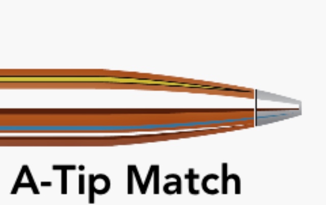

Running the numbers, I don't see enough of a ballistic difference over say a Berger Hybrid to warrant the cost.
If I wanted max BC performance, I would spend just a bit more and get lathe turned solids.
Personally, at their current price point, I don't see advantage to them. I can spend a lot less and get slightly worse BC, or spend not a whole lot more and get much more BC from lathe turned. The $/ballistic advantage just doesn't seem to be there with the A-tips.
If Hornady can get the price down, they will start becoming a much more platable option. Right now they sit in a weird niche spot based on the performance vs price.

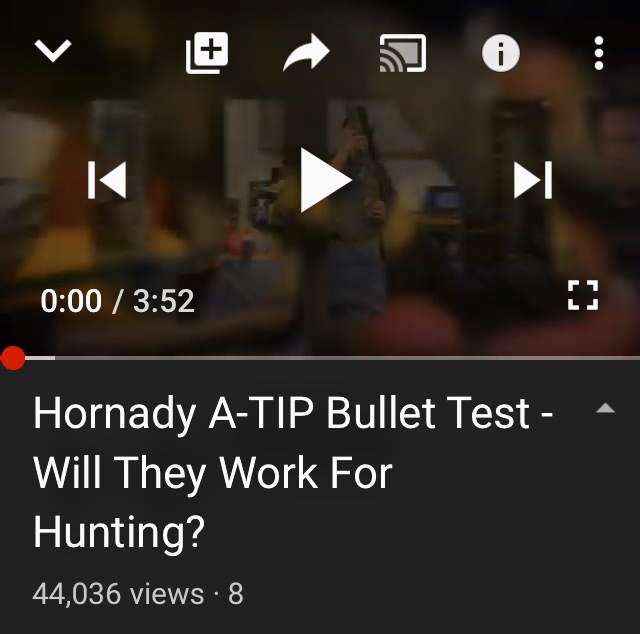

I've seen guys dumping critters with them already. I know guys who have been testing them for the last year and they perform. I just got done doing a ladder at 500yds and my vertical dispersion was crazy small. First 5 rounds were around 1/2", over 15 rounds and over a 3grns of powder were around 2.5" of vertical, maybe. I never did measure. This was with a 6.5 Saum using the 135grn Atip.

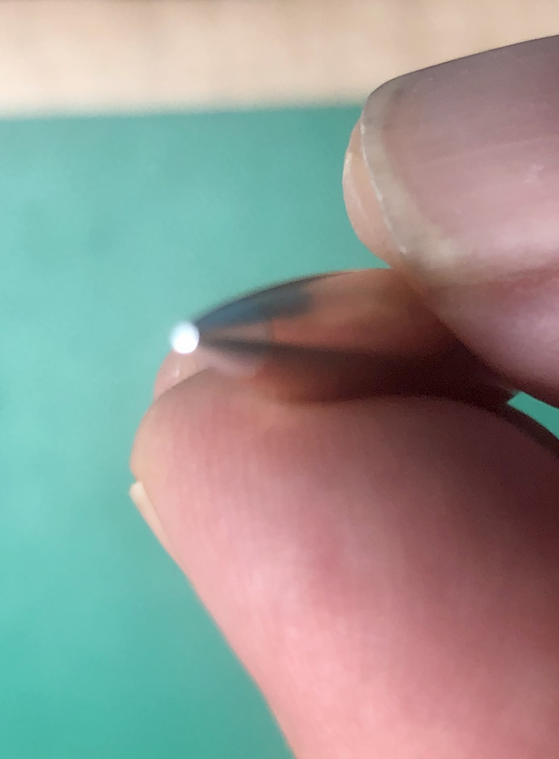

Only issue i have seen so far is that if you drop a loaded round on the tip, it will deform. Tip is quite soft. Handle them with care!

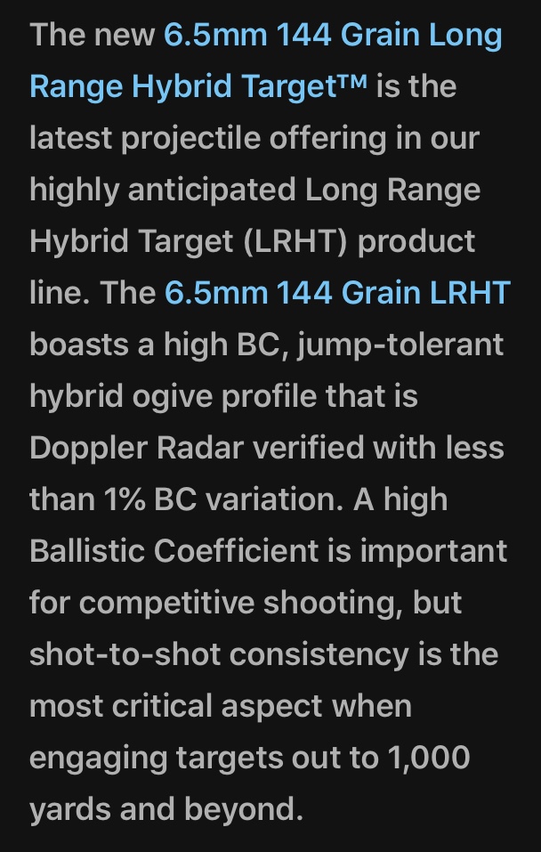

They claim a major improvement in BC variability, but if that does not translate into smaller groups and higher hit percentage at long distance, it won’t matter much.
From the Berger web site, they claim less than 1% BC variation. I vaguely recall other run-of-the-mill bullets have up to 6% variation. See below.

They claim a major improvement in BC variability, but if that does translate into small groups at long distance, it won’t matter much.
NO, they all performed very well at distance. I did get higher BCs than listed after truing. The 144 Berger is running at .354 right now and good to 1083. I have not tested it farther yet. I am sticking with he Bergers now. The added cost for the A-tip is just not worth it, my opinion, and I did not shoot Bergers until last year. I was a Hornady fan.

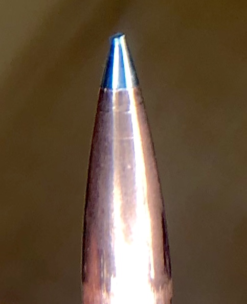

I believe the deformation and melting of the plastic tips caused by aerodynamic heating (air friction) was resolved by using a different type of polymer in the new bullet designs. That affected BC at longer distances, and was found by Hornady via dopler radar testing, which is a solid scientific measurement technique. I think we can believe that to be true. The Amax line of ammo likely had that problem (along with all other manufacturers at that time, who all used the same grade of polymer). The Hornady ELD-M and ELD-X lines use the new polymer tip which is apparently much more heat resistant. So i believe that particular problem was solved some time ago.
However, these injection molded plastic tips are NOT all made exactly the same, and that causes some inconsistency in the actual BC from bullet to bullet. I believe Litz tested that for multiple bullets and found BC differences of around 5% for the worst offenders, if i recall correctly. [Not sure if he ever tested the ELD-M bullets, probably not.] I also know from my own measurements that base to ogive can vary by up to 0.007” between bullets in the same batch, and that is not good for BC consistency or MV.
The A-tip line of ammo has different weights and a slightly different (better) shape, and a longer boat tail. The heaviest ones are very long and set new BC records for their weight class, and they all use machined aluminum tips for better geometric consistency. Hornady claims a BC deviation of around 1%. Presumably a CNC machine does a better job than injection molding. That would make sense. I also suspect they might do a better job on on the base to ogive distance with the A-tip, but that remains to be seen.

These atip defiantly hold up, I can grab a photo of both the 153 atips and the 338 300gr Atips recovered at our 2000 yard target. The tips are 1000% intact on the misses in soft dirt.

Shape differences in 153 A-tip compared to 147 gn ELD-M: Much longer boat tail, longer bearing surface, and a different tip.
BC is only marginally better. Main reason to consider it is the BC consistency claim. That seems to hold true, based on my testing.

Had a good look at the aluminum tips under a magnifying glass, and noticed that they are not rounded like the plastic tips, they are squared off, flat tipped. It seems Hornady thought of the possibility of damage in the magazine due to recoil, and flattened them off in their CNC machines. It also has a fairly large diameter, which gives up a little bit in BC, in exchange for more robustness.
I think there is almost zero chance of damage in the magazine. Yes i would have preferred a slightly harder material, but that probably would have pushed up the price even more. Dropping a loaded round that weighs 79 grains total on its tip from 4 feet on a very hard tile surface is a lot worse abuse than what a metal magazine will inflict under recoil. Hornady has decades of experience manufacturing 50 BMG rounds with similar aluminum tips, and that caliber has more recoil than anything else out there. Run your own test, but i bet you will be happy.

Gunwerks video of a antelope hunt using the 153 gn Atip:
Was a 690 yard shot, buck ran 40 yards or so. Tunnel for an exit wound.
Lethality looks awesome, at least on an animal of this size. Meat damage could perhaps be an issue.

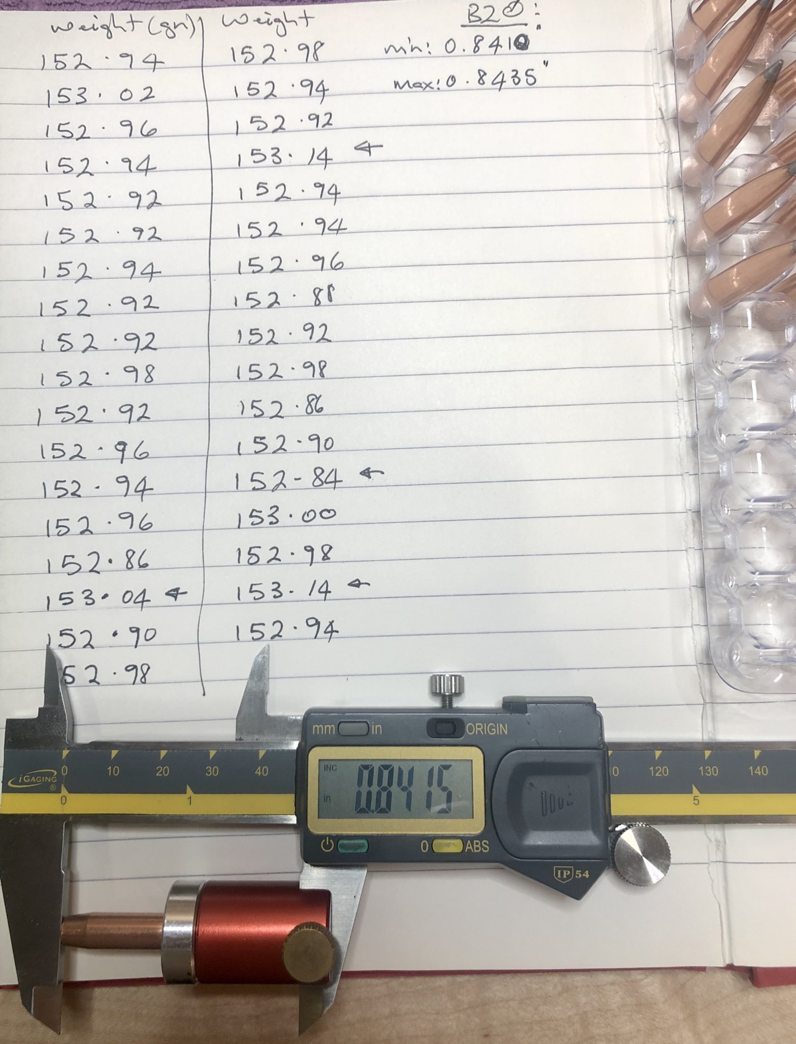

Got some measurements done for the last 34 of the remaining 153 gn Atip bullets:
Small sample, measured on an FX120i which has 0.02 gn resolution.
I got a 0.3 gn weight range, which is adequate but not really exceptional in my experience (for example, when compared to Berger). If i removed the 2 heaviest and 2 lightest bullets, it gets much better. Expect SD is a little better than most bullets. Competitive shooters will likely still want to weight sort. And no I am not planning to do that.
Base to Ogive measurements were very consistent: max was 0.8410”: min was 0.8435”. So ES was 0.0025” (2.5 thou). SD probably closer to 0.5 thou, have not entered numbers into Excel yet. This is a pretty good result.
Checked a total of 40 ELD-M 147 gn bullets: This particular batch was remarkably good. The prior batch was not. Results below.
In terms of bullet weight. An ES of 0.26 grain. Which is good.
Base to ogive gave an ES of 0.0015”, which is very good.
Sadly the ELD-M bullets are not always this consistent, and i have several baggies of rejects that are off by 4 to 7 thou. About 5% did not make the grade. Hopefully the A-tip is better in this regard.
