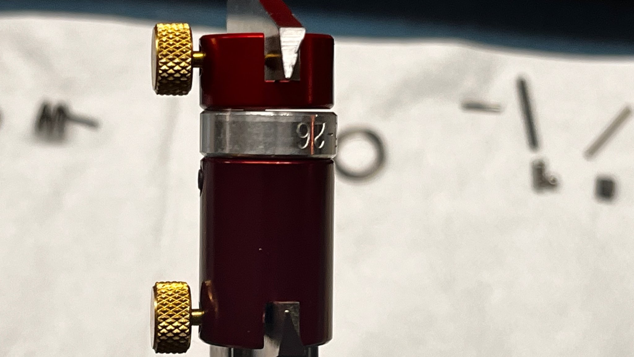

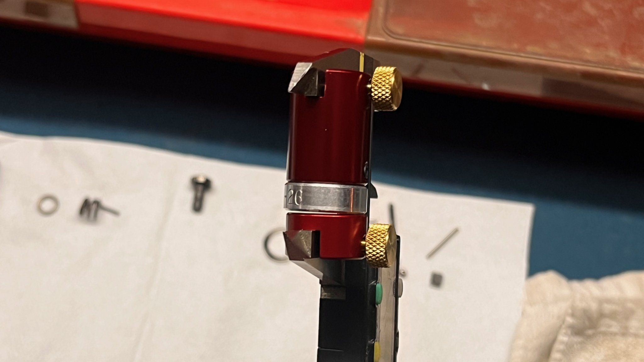

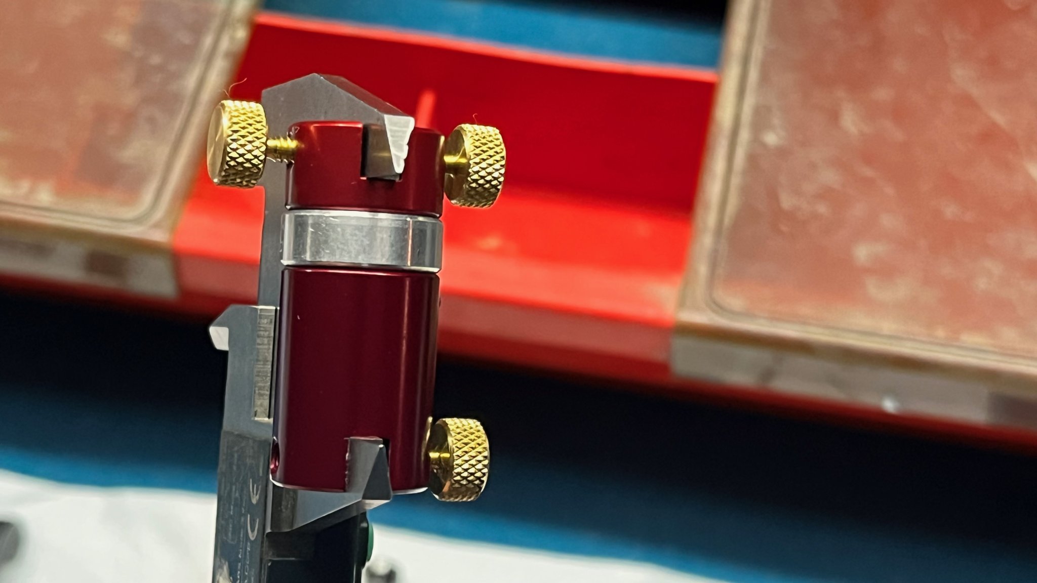

Is anyone else using the Hornady Base Anvil Kit for the non-moving arm/jaw on their calipers? I read that some people were having issues with the anvil not fitting square on the calipers, but I thought that might be due to the Amazon knock-off products out there. I ordered one (on Amazon) that is supposed to be made by Hornady and it came in original Hornady packaging.
The issue is...it does not fit square. No matter what I do, I can't get it square. I even tried to install a small set screw into the opposite side of the anvil, to try and even out the anvil when lightly tightening the hand screw...but no luck. The purpose of this device was to SAVE time with measurements, by having a larger flat surface for the back of the case. I'm messing around with this thing even longer than I work to ensure the back of the case is flat on the jaws of the caliper.
Anyone else have this issue? Is this a quality issue, or am I doing something wrong. Hornady doesn't offer any instructions with the device, so I can't imagine there's a lot to getting it right.
Without the anvil, the comparator is square and flush with the jaws of the calipers.
Thanks!

I tried that. I tried every combination of tightening down the components I could think of. Without fail, when the anvil base is tightened...it skews the orientation. I can tell this, by even the lightest pressure AFTER both components are tightened down, causes the calipers to shift from the zero point. Also, when they are both tight, and I close the calipers, with light pressure on the calipers to close the jaws, when I loosen the hand screw on the anvil base, the anvil "pops" back to a square/flush position. If that makes sense.
Attach both pieces, then clamp the jaws together with light pressure. Loosen the knobs but continue to apply pressure, let the pieces self-align, and tighten the knobs. Zero the calipers. Move on.
This ^^ 100%....if this doesn't work for you, then perhaps you have a defective unit but doing this ^^ has always worked perfectly for me.
Reactions: yo-yo
Without the comparator middle, do the anvil and other side pair nicely?
If you swap it around with screws on the back of the caliper, does the gap follow to the opposite side?
If you swap it to the other jaws and repeat, does it continue to follow that same positioning?
Reactions: yo-yo and Baron23

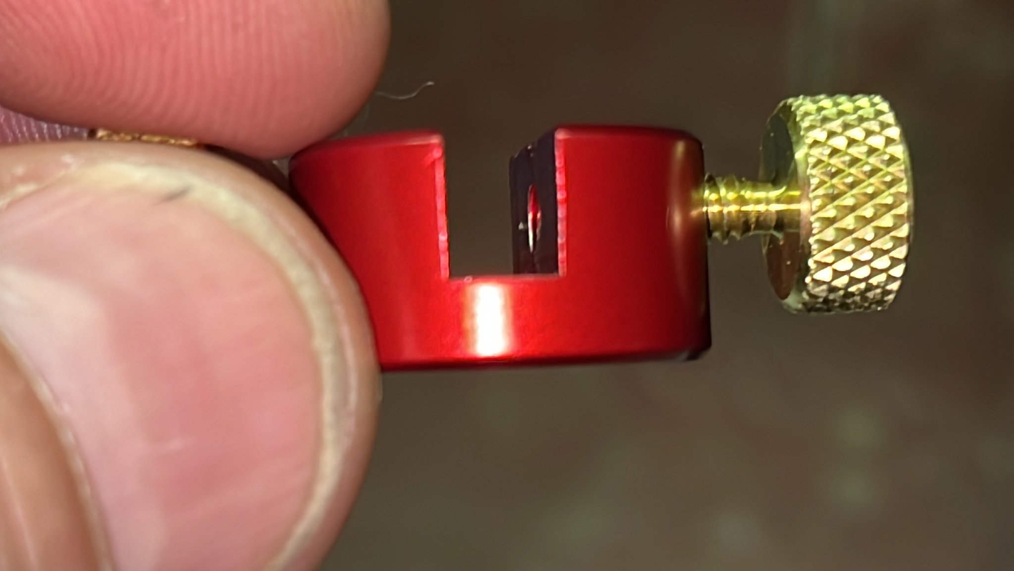

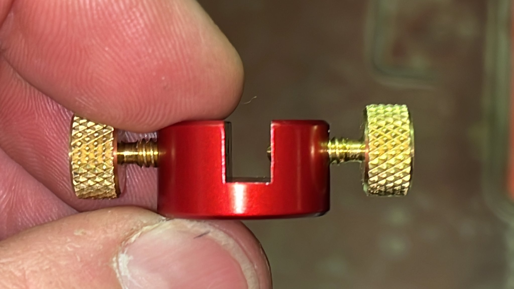

A friend brought me the same problem once.
I found that the detail of the slot on the anvil was poorly done. The very bottom corner had a problem where it became more of a radius than a hard corner. That defect prevented the anvil from having clearance to the corner of the caliper blade and the anvil would rock on that corner instead of going flat along the caliper blade.
The fix was what we call a corner relief cut. This type of cut eliminates any chance of the bottom of the slot from having a radius or chamfer that prevents the caliper blade from tilting. The issue is that it requires a machine shop level resource to re-cut the slot in the anvil so that the clamp side of it has this type of corner.
Here is what this type of cut looks like in a section view.
Yeah, that didn't work for me. I tried several other combinations too, but with the same result. Not sure what is happening yet.

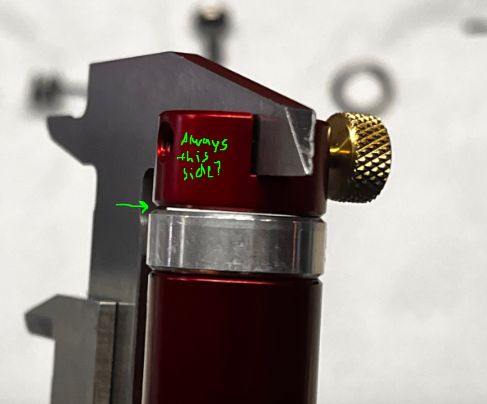

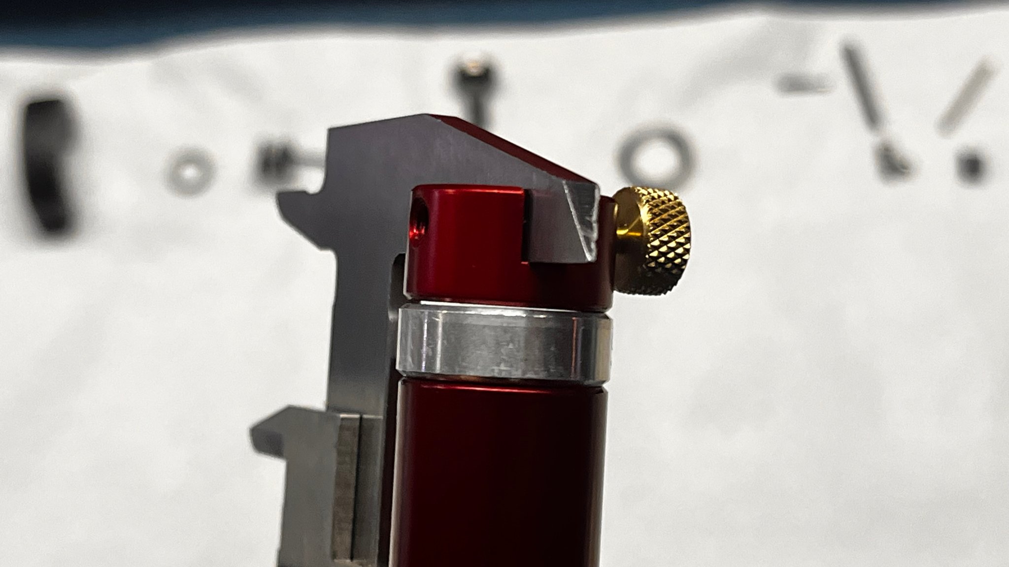

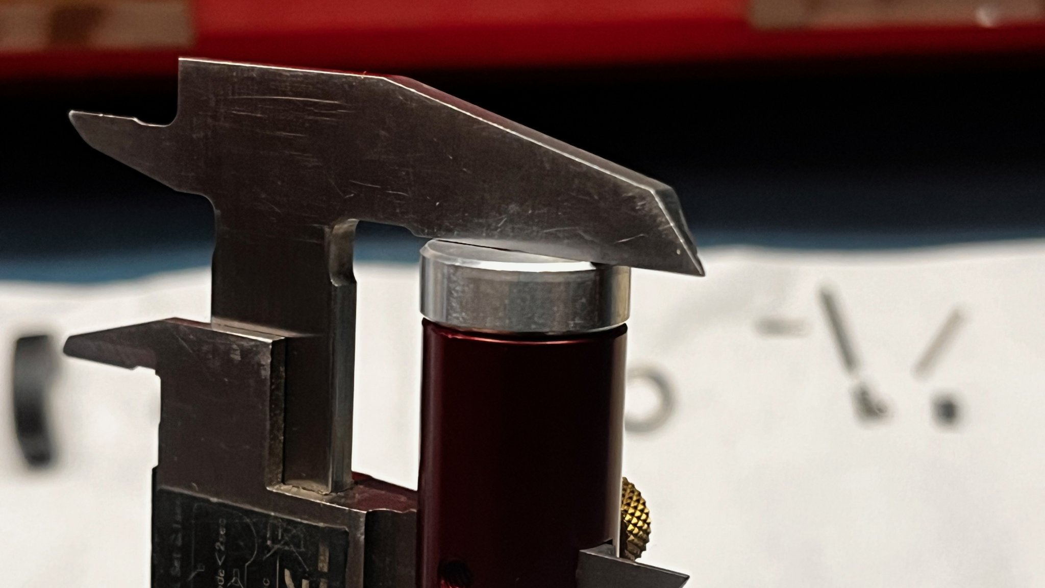

Ah good questions.
Yes, if I swap the hand screws to the backside of the calipers (I have to swap both the lower comparator section and the anvil base together though, because the slots cut in them are cut off-center, so they seem to need to be in the same orientation.
Also, yes, if I swap the anvil base to the "moving" jaw of the calipers and the comparator base to the fixed jaw, the problem follows.
I do, however, think the problem is not that the components aren't cut square...I think the issue is related to the hand screws causing a "twist" of the component on the jaws. I found that if I spend some additional time installing the base with two hand screws (I borrowed one from another device), and making sure the two screws are balanced once set, and started with the set "screw" on the comparator insert loose...it did even it out.
Having said that...I was trying to save time with this device, however the setup time costs more time than it takes me to use the thinner fixed jaw of the calipers without the anvil base.

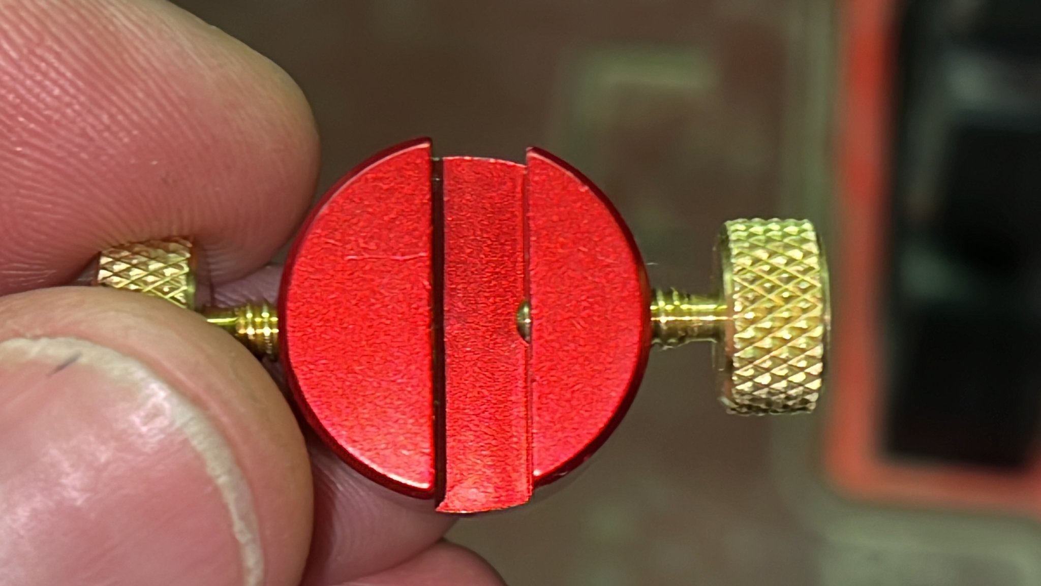

Ah, yeah, good catch! I took a look at mine and I think it's pretty square, without a radius cut.
You can also see here, how off-set the cut of that slot is in the anvil base.

What brand of caliper is that? In this pic, the side of the upper jaw that the screw tightens against doesn't appear to be square to the top surface (or, parallel to the vertical axis). It might just be the angle of the pic though...
Reactions: yo-yo

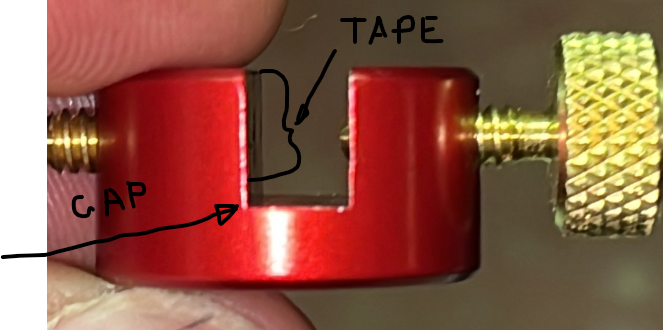

The offset is intentional as it accounts for the idea that the caliper jaws are side by side to some degree.
Also, that corner isn't cut sharp enough on either the anvil or the other part of the tool, so part of the tilt can come from either or both sides.
To see if the corner radius is bad or if the whole thing is cut at an angle, place two layers of Scotch Tape on the side opposite the screw and leave a tiny gap above the corner of at least 0.020" to simulate a relief cut. do this on both tools and clamp the screws very lightly just to see if the corner is the problem.
If that makes the tools mate better, then the corners are the problem. If it doesn't then one or both are cut at an angle.
Good Luck.
Reactions: yo-yo
It's a Mitutoyo brand (Absolute model). It's a higher grade tool, compared to a lot of them on the market. It's probably the funny angle of the pics. I did check them closely, to see if there was an issue, but then are consistent with measurements without the Hornady Anvil base add-on.
Good Luck.
Ok. Thanks for the detailed annotation. I will give this a shot and report back. Thanks!!
