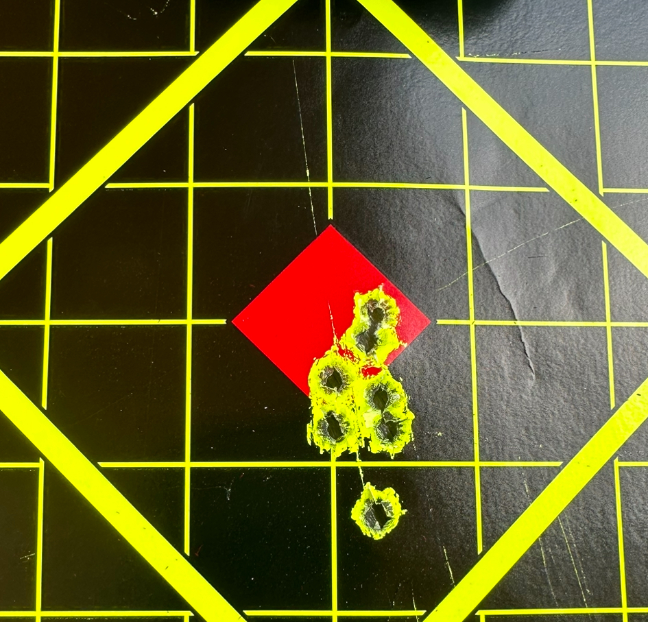

I mean not perfect and changed some components and will reshoot in a few days it seems ok in my bolt gun
