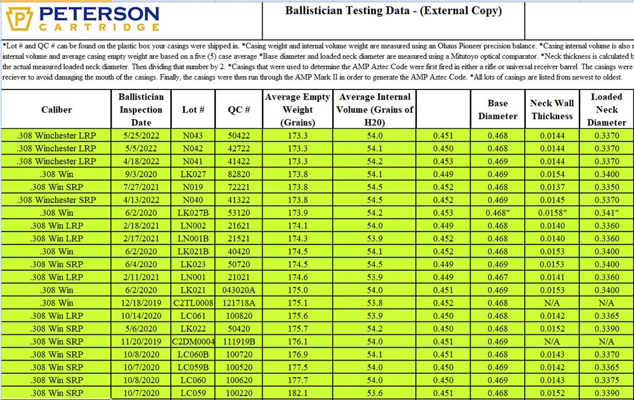

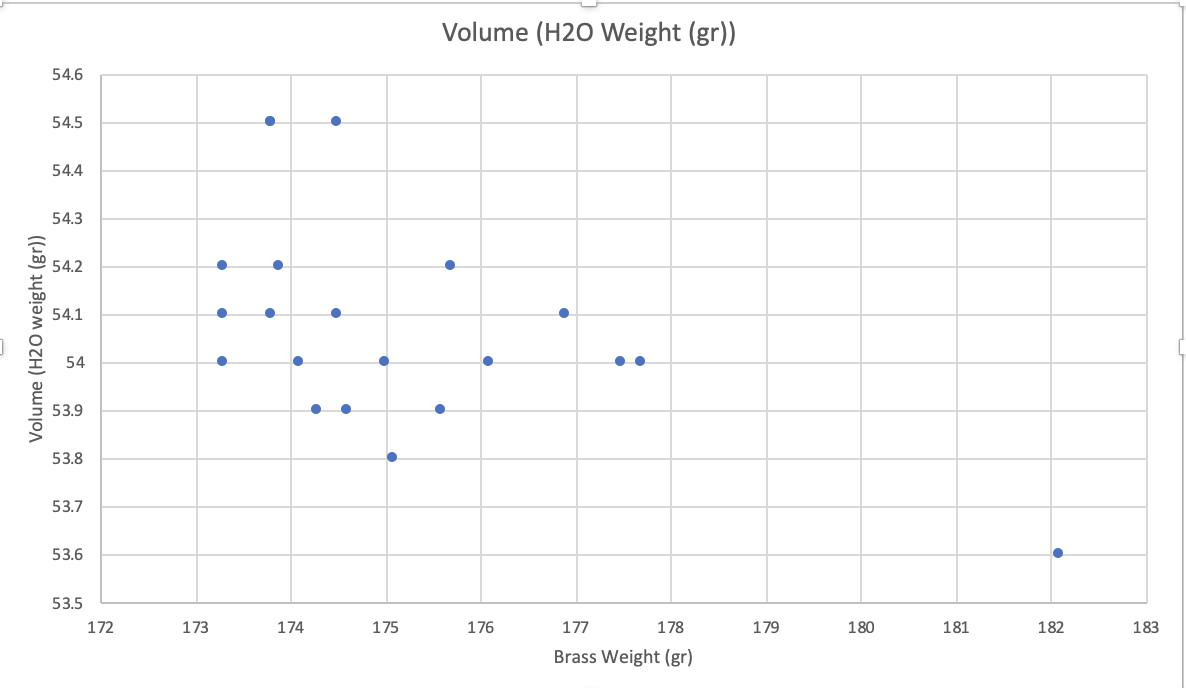

I don't know if there's really any difference in Hornady's cases from their regular brass to the "Match ammo" brass. I had the same question regarding Federal's brass and called them to find out; they confirmed there was no difference. Whether that's true with Hornady . . . 🤷‍♂️
I'm sure you'll find that within any manufacturing process there are variances from one run to another and why there are quality control people to keep an eye out. Just like with bullets, cases can have variance from one lot to another. To illustrate this, here some testing data I found for Peterson Cartridge Co. that might convince you that it'd be a good idea to sort your cases:
Reactions: 338dude

What I get from this is that (with the exception of lot LC059) weight sorting Peterson brass as a surrogate for volume determination is a waste of time...
Since it's "average" weight to "average" volume, I don't think one can draw any conclusions with this data regarding sorting within a given lot. The data simply shows me variations from lot to lot. So, one should not assume that a good load developed for one lot of brass is necessarily going to work the same in another. And mixing lots can produce a wider variation than just using a particular lot.
