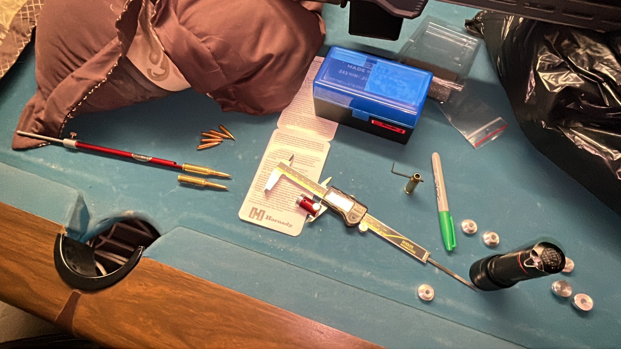

I went through a process of trying to find my lands, building some dummy cartridges the other night, by turning up the bullet seating die micrometer tool, and testing each one in the gun (locking down the bolt). I tested the overall length of the cartridge before and after inserting into the chamber and locking down the bolt. I did this until I reached the point at which a cartridge became shorter by locking down the bolt, signifying it had jammed into the lands and locking down the bolt forced the bullet deeper into the case. I created a model cartridge that I felt best represented the OAL that would insert into the barrel and just touch the lands.
There were a few cartridges that did not repeat the overall length, after seating the bullet into the case with the micrometer die, and the overall length was as much as .015" short, when measuring the OAL. I figured this method could not account for the variation in the tips of the bullets or something, and I wanted to do better, so I bought the Hornady OAL Gauge Tool and the Bullet Comparator with a modified case for my 6.5CM.
I set everything up and inserted the modified case/OAL tool into the barrel and locked it down, and then pulled the cartridge out and measure it (to the 0give this time) with the Bullet Comparator tool. I then compared that cartridge to my model cartridge, and the Hornady modified case cartridge was .053" shorter than my model case. Whether I measure the OAL of the cartridge (head to tip) or I use Bullet Comparator Tool in my calipers, I still end up .050" shorter with the Hornady tools than I do with my model cartridge I created to just touch the lands.
What could be happening here?

View attachment 8559468I went through a process of trying to find my lands, building some dummy cartridges the other night, by turning up the bullet seating die micrometer tool, and testing each one in the gun (locking down the bolt). I tested the overall length of the cartridge before and after inserting into the chamber and locking down the bolt. I did this until I reached the point at which a cartridge became shorter by locking down the bolt, signifying it had jammed into the lands and locking down the bolt forced the bullet deeper into the case. I created a model cartridge that I felt best represented the OAL that would insert into the barrel and just touch the lands.

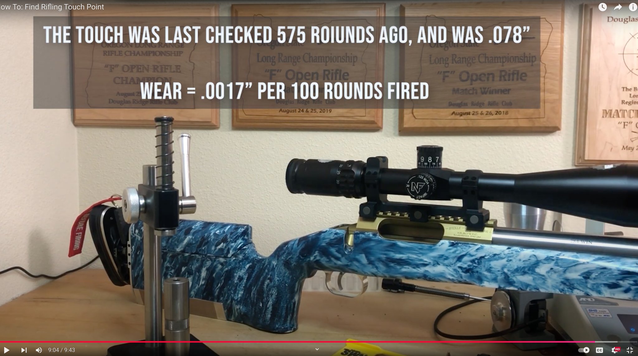

Go here: https://www.wheeleraccuracy.com/videos and scroll down to 'Finding the lands'

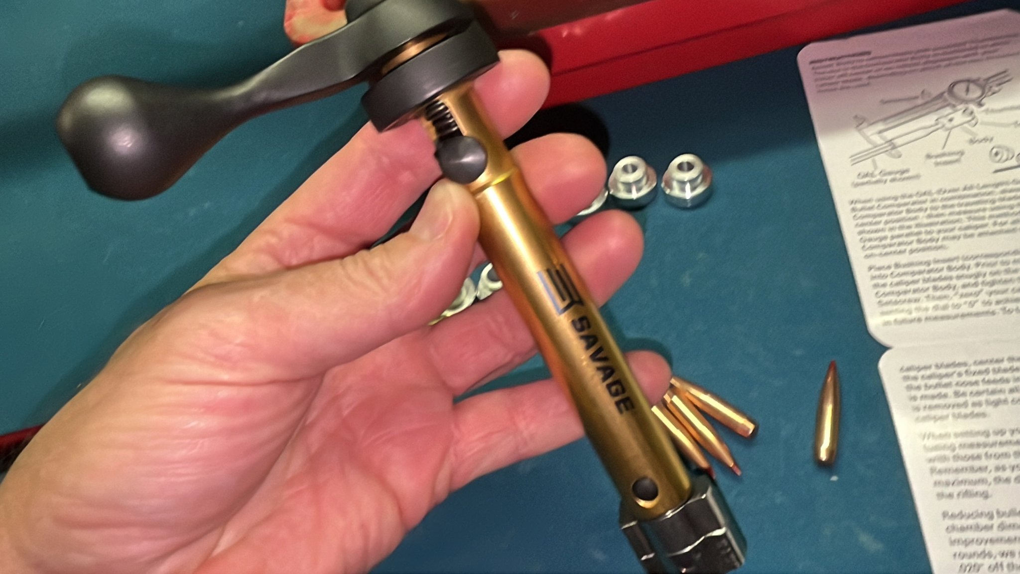

Wow! Thanks. I just started into the bolt disassembly tonight. I appreciate all this, as I was following a video reference that does not break the bolt down for the same reason (and he doesn't reassemble it either). I will read over this carefully as I keep going. I'm certainly learning a lot about the various acronyms and specific vocabulary for these little parts.
I'm almost wondering if I should invest in another "bolt" to perform all this. I was planning to build another bolt for converting this Creedmore to a PRC next year, and it might save me some time now.

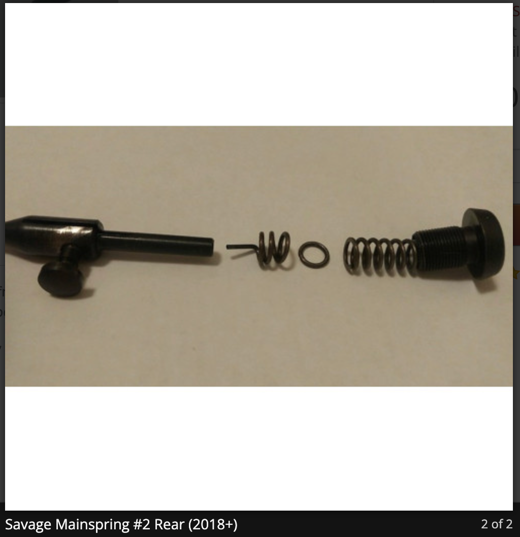

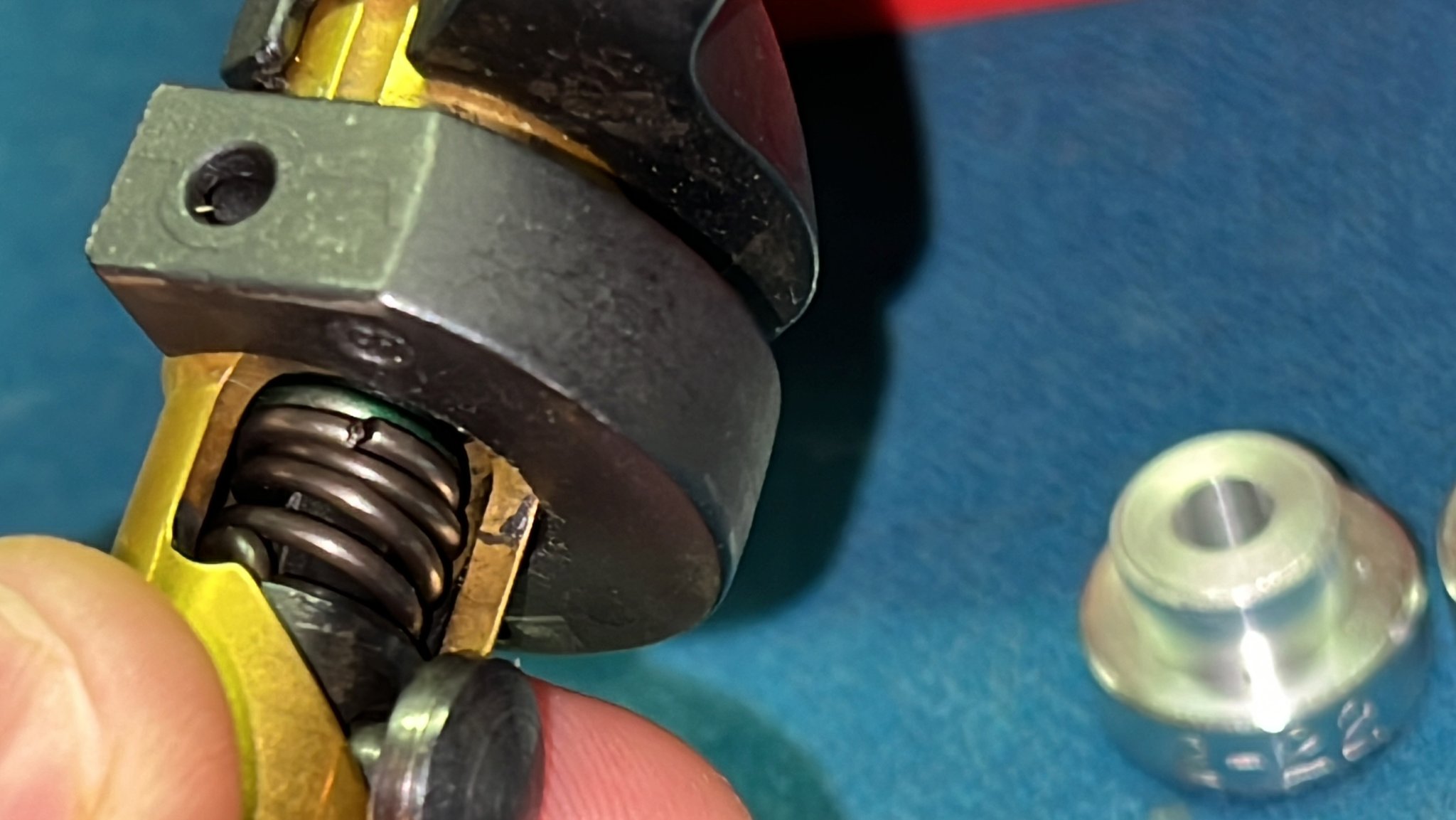

I did however, run into an issue tonight, where I took the pressure off the spring at the back of the bolt (near the handle) and it looks like the spring is actually broken. Does this look broken, or is there two springs in there?
Not sure that's necessary... you should be able to just swap the bolt head, rather than build a whole 'nother bolt. I mean, it'll work, it's just not quite the normal way most people go about it.
Unless they changed some things (Savage has been known over the years to change $hit that didn't need fixin') there should be only one spring in there.
Actually removing the BAS and pulling the cocking sleeve, cam pin and firing pin assembly out will give you a much better view of what you have going on there.
Reactions: yo-yo

Thanks. Yeah, another good representation of the process. I found it interesting you can actually see the barrel wear by rechecking the touch point after several hundred rounds. He saw nearly .010" after 575 rounds through the barrel.
Ok. Yeah, I was just thinking it looks like removing the required components from the Savage bolt is a bit more complicated than typical bolts.
According to the Gun Shack, there appears to be two springs in the (I think), but I don't think they are stacked, so I may have a broken spring. Not sure how mine is still working so well. I would never have seen it if I hadn't released the spring pressure in order to gain access to the BAS.
Yeah, I was going to remove the BAS last night, but it sounds like the BAS is in there VERY VERY tight from the factory. An impact gun with a socketed hex key is required to remove it. I have metric versions of that tool, but I'm not sure yet if Savage is metric or standard. I don't want to strip it out. :). I'll look further into it today.
EDIT: I found the standard size tool. I'll see how hard this is to get apart! :)

I've got my bolt apart, except for the ejector (can't get the little roll pin out yet), so I will be able to test the distance to the lands with the bolt and with the Hornady tool and see how close measurements are from each process and compare them. :)
The short version is this: pull the ejector plunger and spring as with any other action (that uses a spring-loaded ejector). The trick with the Savage setup is that if you pull the entire firing pin assembly out, along with the rear baffle and put the BAS back to hold the handle on, and then take off the bolt head to remove the wave washer and put the head back on... there's nothing left to hold the toggle cross dowel in place. When you insert the bolt in the action, it's initially horizontal. When you close the bolt and lower the handle, that pin is pointing straight *down*, with basically no tension on it. It can - and will - fall out part ways, locking things up. You may 'expand your vocabulary' a bit getting it back *out*. DAMHIKT.
One way to deal with that is to put a strip of clear scotch tape - the thinner the better) over the pin on the side where it would rotate down and fall out. Sometimes the tape itself will get hung up and/or scraped off, depending on clearances. A better way to circumvent the problem is to take the BAS off, and simply remove the cocking *sleeve*, not the whole firing pint assembly. That way the pin stays in the bolt, and keeps the cross-dowel in place naturally. With the cocking sleeve removed, the rear baffle off, and the wave washer behind the head removed there shouldn't be any tension or interference from the cocking system of the bolt. In fact the stripped bolt should fall closed on an empty chamber with a 'thunk'.
Then you need a case that has been sized to where *it* doesn't give you any interference or resistance either. Again, refer to the video list mentioned above for a method to do that also, while you have the bolt stripped down like this. Once you have that, *then* you're ready to find the actual 'touch' point of the bullet to the lands. If you have a couple different bullets you think you'd like to use, I'd suggest testing them all now, while everything is already apart. None of this is exactly 'hard', but if you don't have to take things apart and put them back together again multiple times for the exact same purpose, it's a little more efficient.
Be sure to lay out a clean blue shop towel to give you a clean, uncluttered place to put all the small parts so you don't lose any of them!
