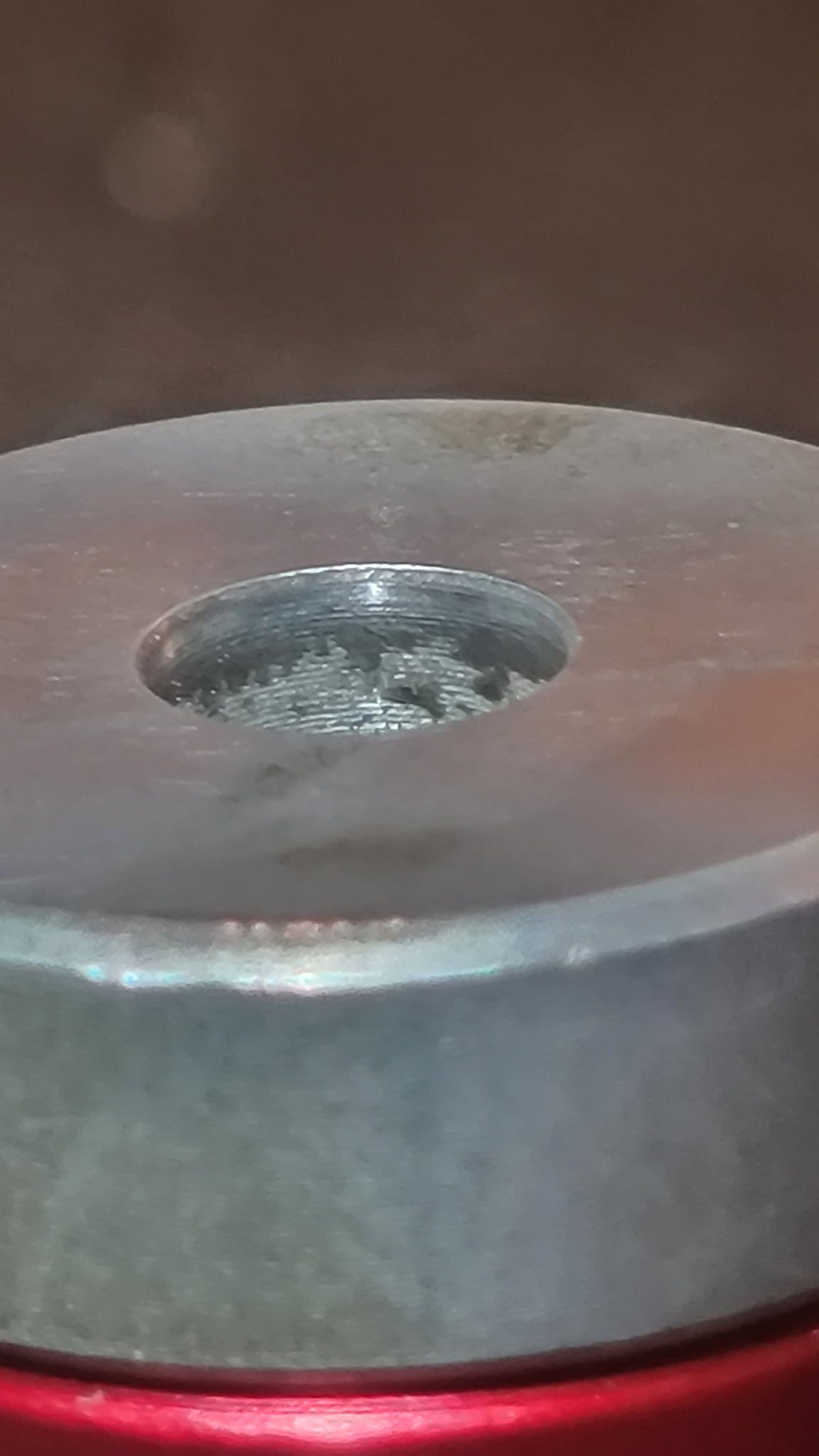

Ok starting sorting bullets with the hornady bullet comparator. After watching tv I noticed my measurements were changing. I would got back to pile and they were all different. I had the anvil/bushing on lower caliper jaw then close they jaw till the base of the bullet touched the upper jaw. The spin the bullet till it sat flat on the jaw. So i guess its wearing it out being aluminum and be making rookie mistakes. Is this a common issue and keep going till it makes a nice seating spot. Its frustrating because all my piles are off. F@$K IT load them up to the max and send it lol.

You might be using too much pressure??? 🤷‍♂️
It's takes some time to develop a good feel for using a caliper to get consistent reading, especially when using a comparator like that. You might try putting the comparator assembly on the upper jaw and no anvil on the bottom jaw.
You didn't say what caliper you're using. If you don't have a good caliper, getting inconsistent measurements would be normal.

Yeah true that. That may be a near future purchase as many people use mitutoyo(msi viking) i believe for best pricing. Gonna try the old lyman calipers I got in a package deal years ago that was a steal. My digital rcbs calpiers are going it the junk drawer.

Were you using it with lead or Moly coated bullets? Looks awful dark.
Unless they took the incredibly cheap step of drilling the bushing after anodizing the surface should be harder than any common projectile.

69gr smk .224 no they didnt drill it was all me with to much pressure. Trying to get used to the anvil on the upper jaw lol.

Sorry dumb question but do you give whatever you're measuring with a caliper/comparator a twist? I give light pressure using the adjustment wheel then roll the case or complete cartridge with my fingers when checking case length, shoulder length, or seating depth.
It seems to me that would cause it settle on the shortest spot and increase consistency but I don't really know. It does make faint marks on my bullet ogive.

A light touch on the caliper closing + a small rotation will usually improve the presentation, and result in more consistent measurements. The key thing is the jaws are hard and the brass/bullts are soft. Don't bite too early before its squared up, and don't over-work the rotation once the presentation is good

IMHO, sounds like you're doing it correctly, as I find doing it that way gives me consistent results. I'm pretty "light" with the pressure and sometimes I do get a faint burnish on the ogive, but for me, that indicates I'm either putting a little too much pressure with the caliper (as light as it is) and/or am twisting such as to wedge the bullet into the comparator too much with my fingers.

Yes i gave them a roll between my fingers to find where it sits flat. I think thats what has caused my issue. I have heavy hands and need practice on a lighter touch.
