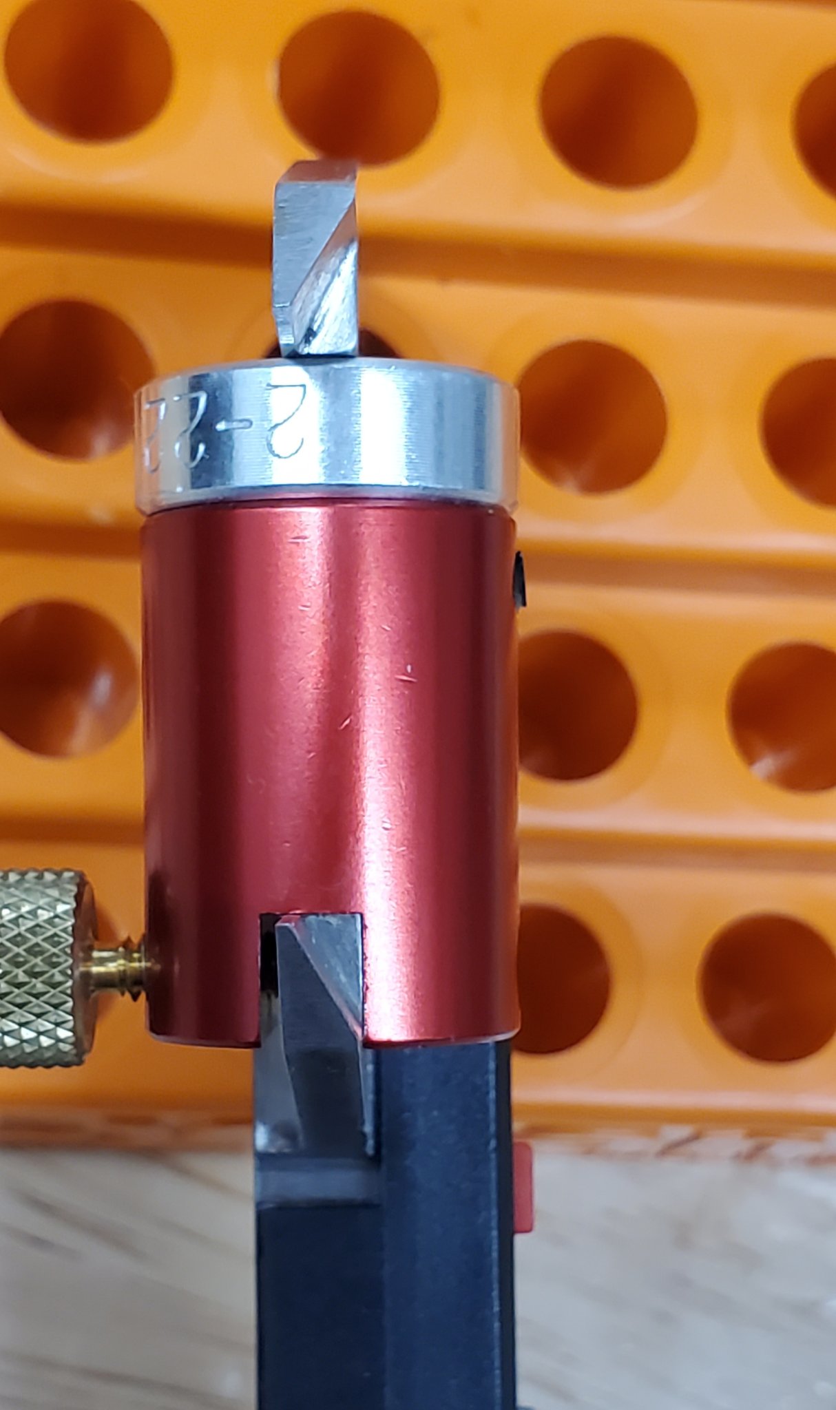

I bought a new 223 Cal rifle and I am using my Hornady Bullet Comparator. As experienced before with other rifles, I am getting different readings repeating the same process.
Attached are the readings and a picture of the comparator with a bullet in it. I am inserting the comparator cartridge into the chamber, making sure the shell seats all the way. After I verify that with a flashlight, I move the bullet gently forward until it stops at the leads. After that I use a cleaning rod that is inserted in the barrel to move the bullet slightly back from the leads and then push the bullet forward against the leads to get the final reading.
All this is done with minimal force to avoid pushing the bullet past the beginning of the leads.
The starting point for the freebore is usually two thousands off the leads, but my readings from the bullet comparator vary by as much as sixteen thousands, making the whole process worthless.
Does anybody have any suggestions as to what I need to do differently in order to get a more acceptable outcome?

I took a second series of readings this morning and got much more consistant readings. This time I applied appox. 15 lbs of pressure on the bullet. I think these numbers are much easier to work with.

Oh, and another tip; Put your comparator/insert on the moveable jaw of your calipers and close the calipers. The bore of the insert should be centered over the fixed jaw of the calipers. Mine weren't, so I always mount my comparator/insert on the moveable jaw with the setscrew on the BACK of the calipers. That way, the bore is centered on the fixed jaw of the calipers when I close them.

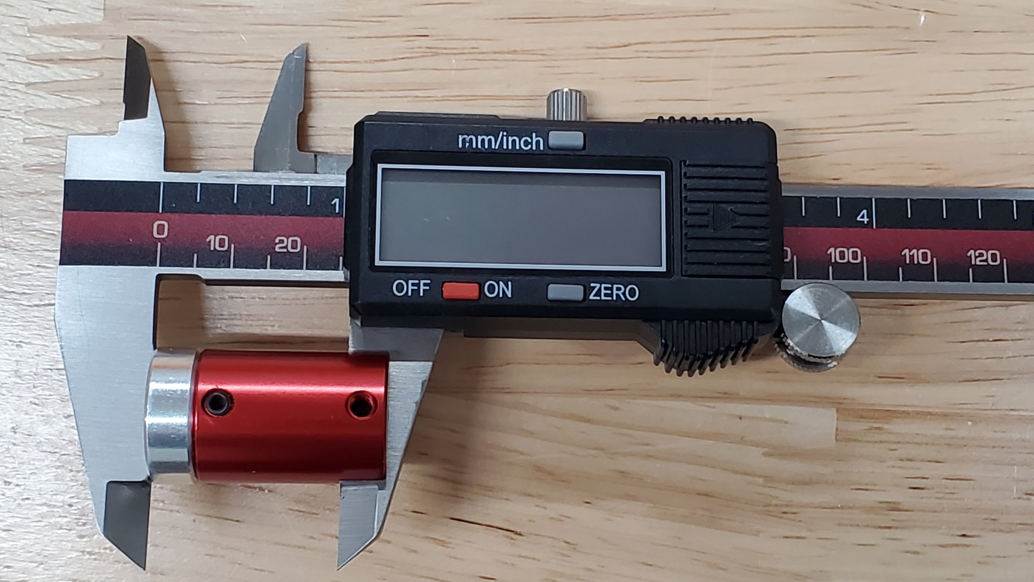

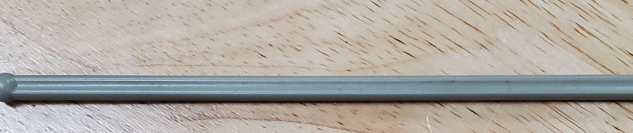

Thanks for the insight. I took three pictures that show how I use the gauge. The shaft does not show a dimple yet but a dark mark on the right side where the screw locks in place. I will not tighten the screw more than needed, just to avoid creating a dimple. Thanks for letting me know. Is the gauge mounted properly?
Something that I had forgotten about........
Stoney Point/Hornady "may" make the Comparator with the slot "offset" from center so that everything lines up properly when using the OAL gauge to take a measurement. It's an easy check.
I know what all my O-H dimensions for each caliber/chamber are and I have all my dies set for that/them. When I use the Comparator anymore, I'm checking loaded rounds as they come off the press. That's when/where I mount the comparator with the setscrew on the backside of the moveable caliper jaw.
Yes, your pics look correct. Pull the setscrew out of the OAL gauge. Is the face flat, or does it maybe have a rubber or plastic tip ? If so, they've address the dimpling problem.

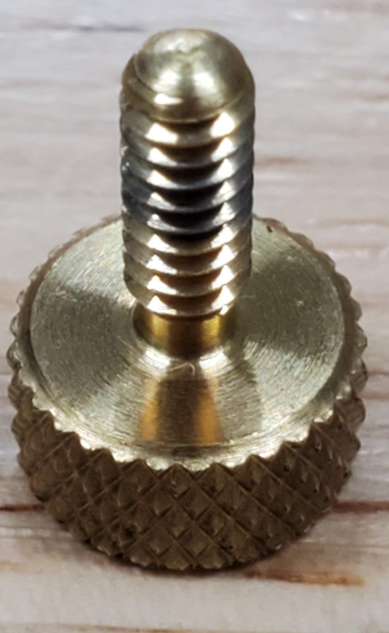

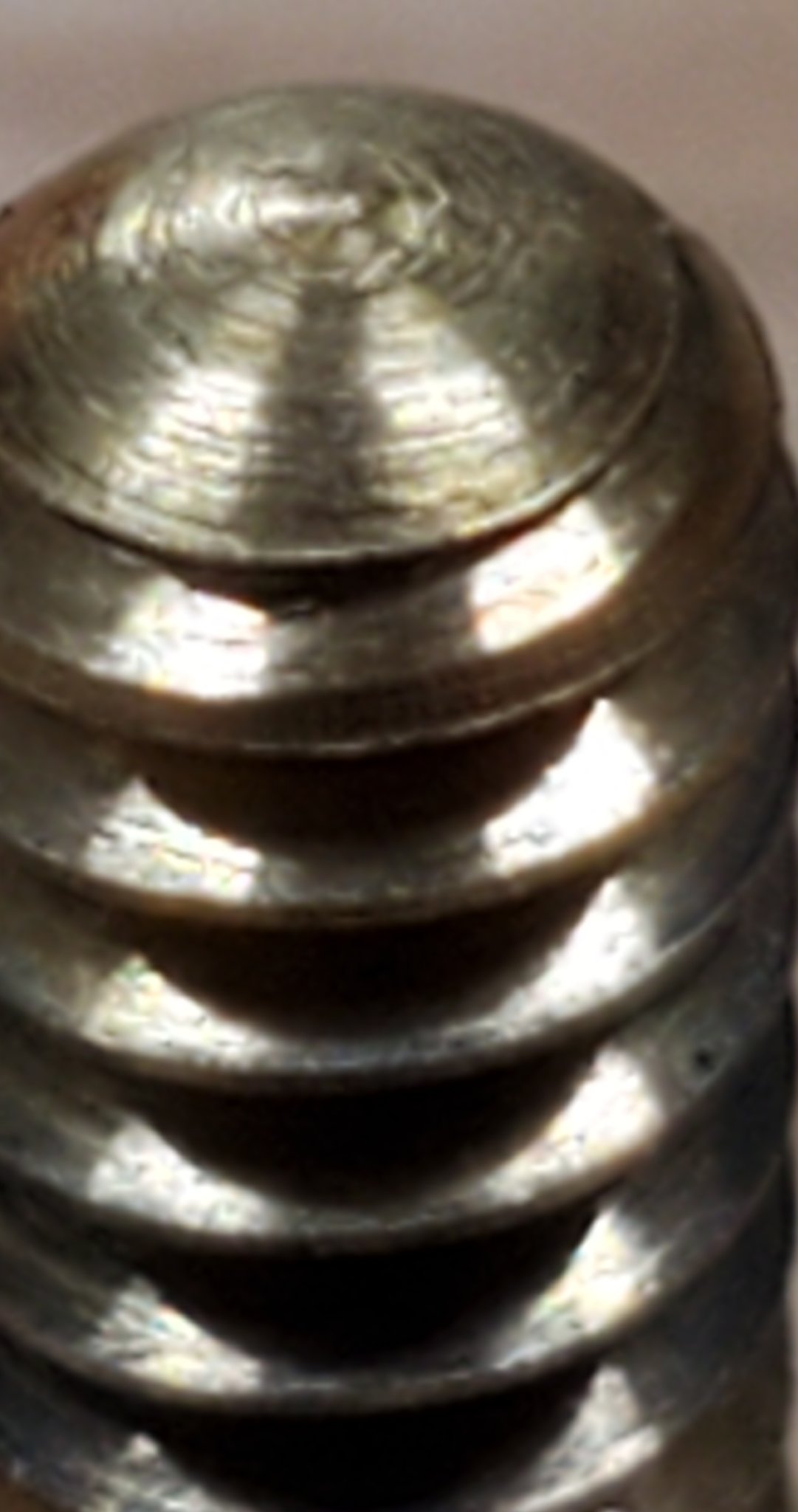

It looks like the tip has a minor recess in the center. There is no spike that would puncture the shaft.
