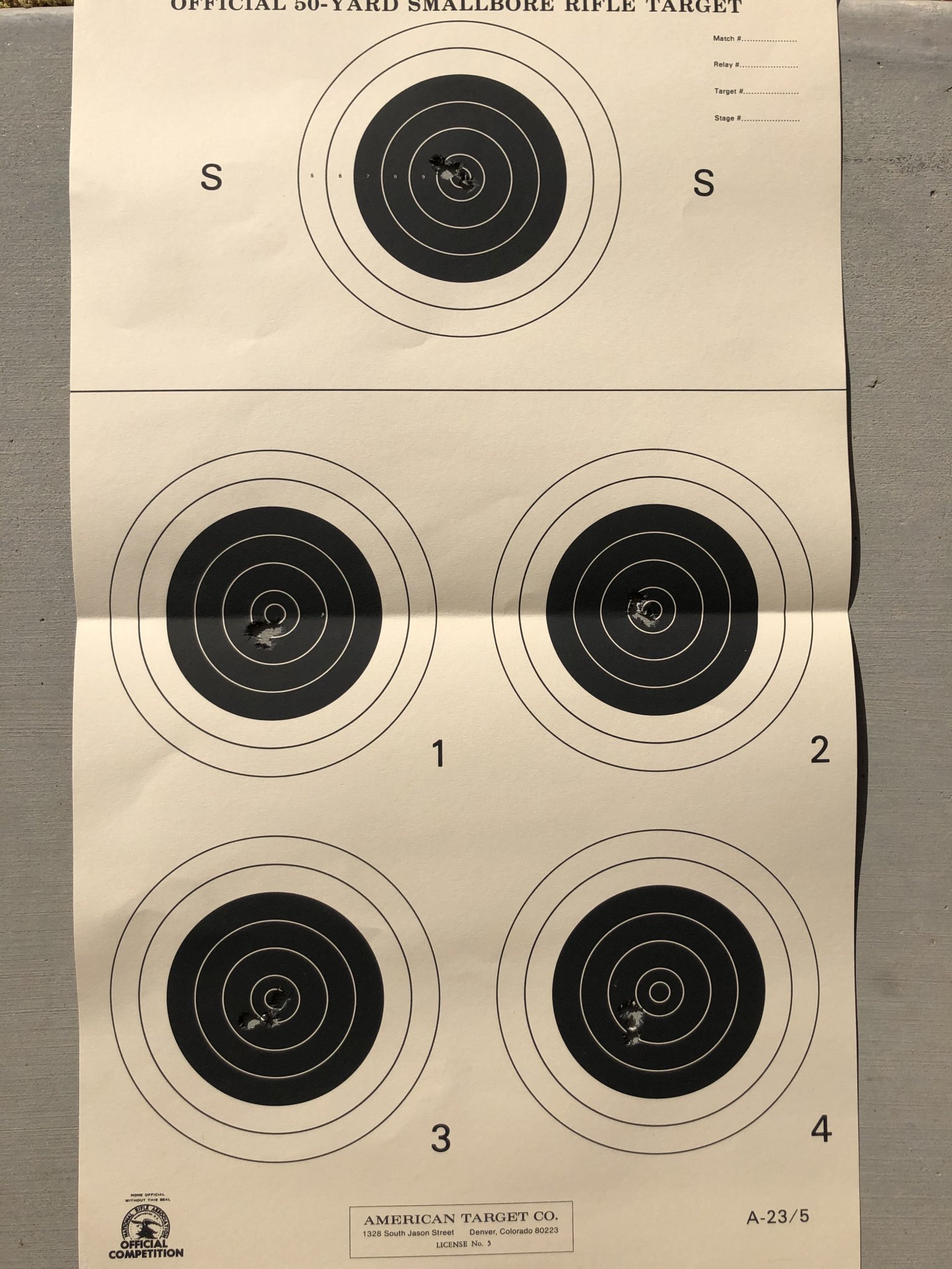

I started reloading pretty much at the same time that I bought my first rifle because I couldn’t find factory ammo worth a damn. I even started a thread last year about this time on Prime ammo and high SD’s. I just moved and haven’t had time to set my reloading bench back up and wanted to go shoot so I picked up a box of Hornady 140 grain ELD-M’s and was very pleasantly surprised by the results.

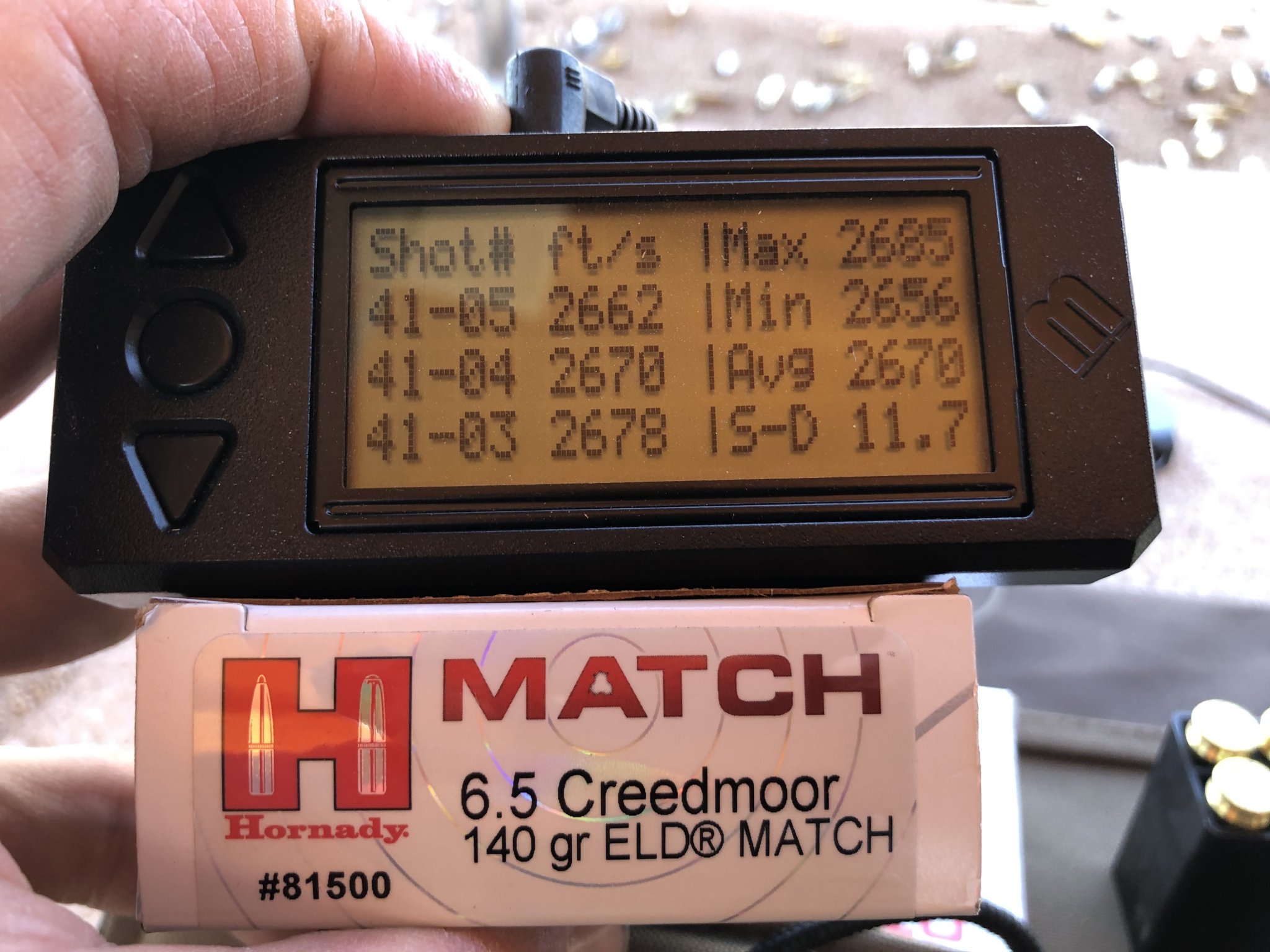

one 5 round group is good, a 5x5 is pretty damn consistent ammo. The two bottom groups were me futzing with windage and elevation. As LowLight and Padom have said before a group size at 100 really doesn’t mean much, the real proof is in a low ES and SD and this is what my MagnetoSpeed had to say about the factory Hornady ammo.
I was very pleasantly surprised, I can and have hand loaded to an SD of 5 so the factory stuff won’t replace my hand loads but will absolutely do out to 7 or 800 yards. I need to get my hands on some Prime from their new non-Norma manufacturer and see how it does.

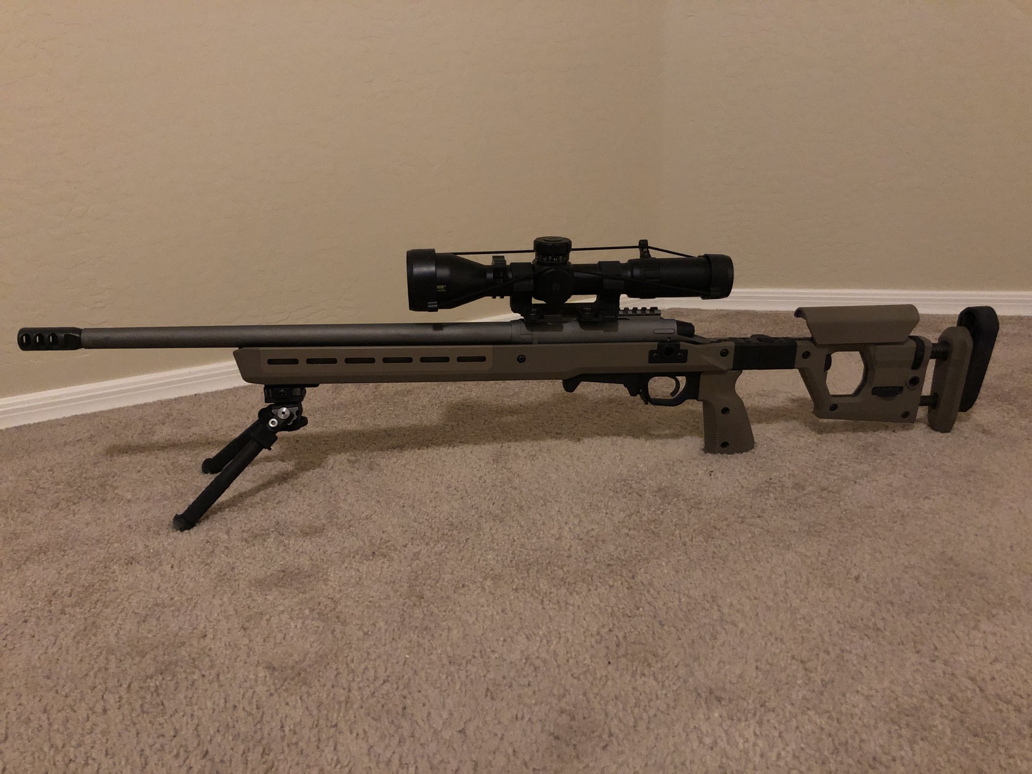

My test mule is a Bighorn TL-2 with a Shilen SelectMatch barrel.
