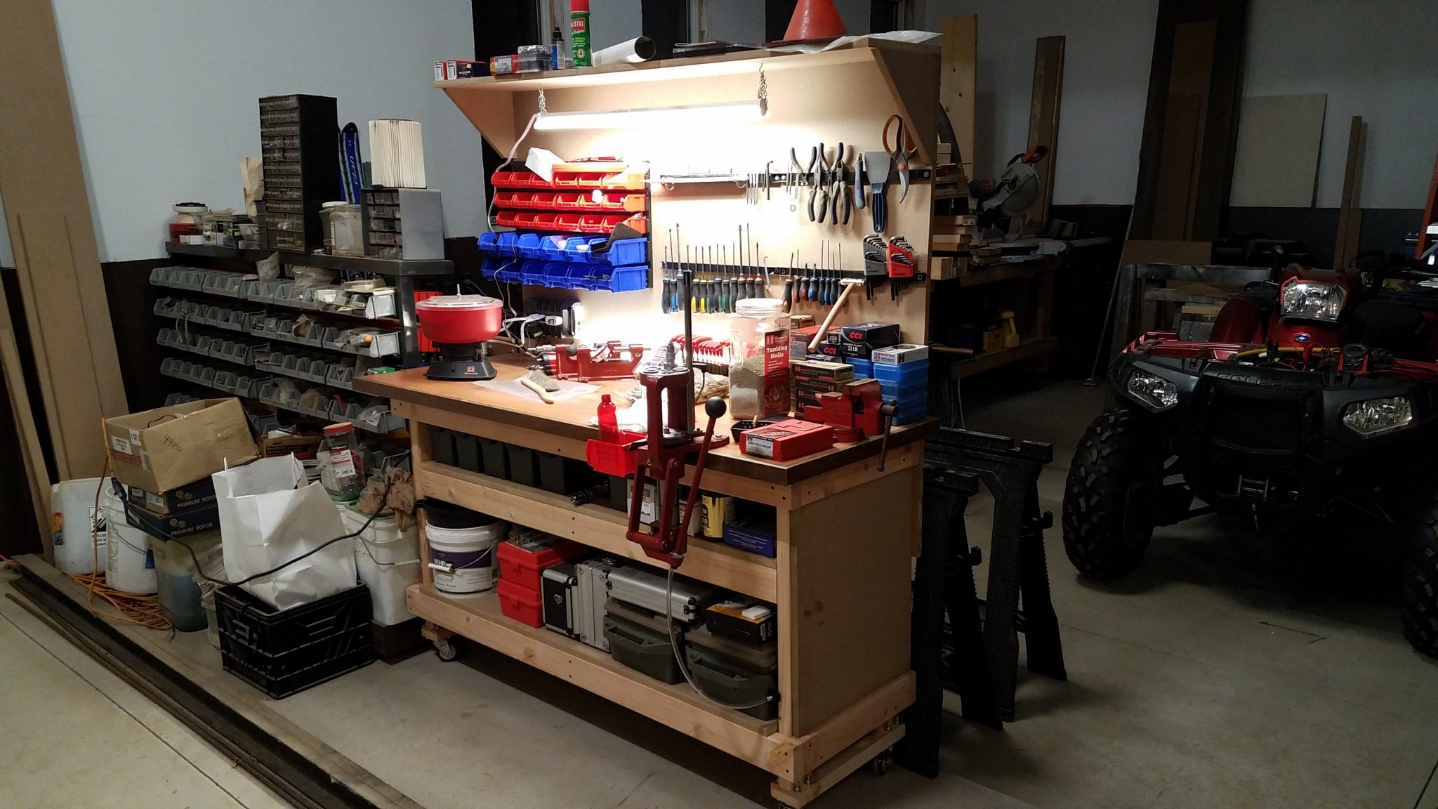

I have one, and began using it when I got into reloading. Operated it as a single stage press, and using only one station at a time. I did use a chargemaster combo and a powder funnel die to use, however I have since went to a single stage for seating bullets.
I do use this press still for brass prep, and can process a lot of brass quickly with this press. I use the AP for decap, resize, priming, full length sizing (without expander ball/pin), and finally finishing up on an expanding mandrel. Have been monitoring runout using this technique and have been able to keep it between .0005 and .002 at the neck/bullet area, so very little runout.
I haven’t setup this press for a full on progressive start to finish reload setup but will eventually. Too many projects for now.

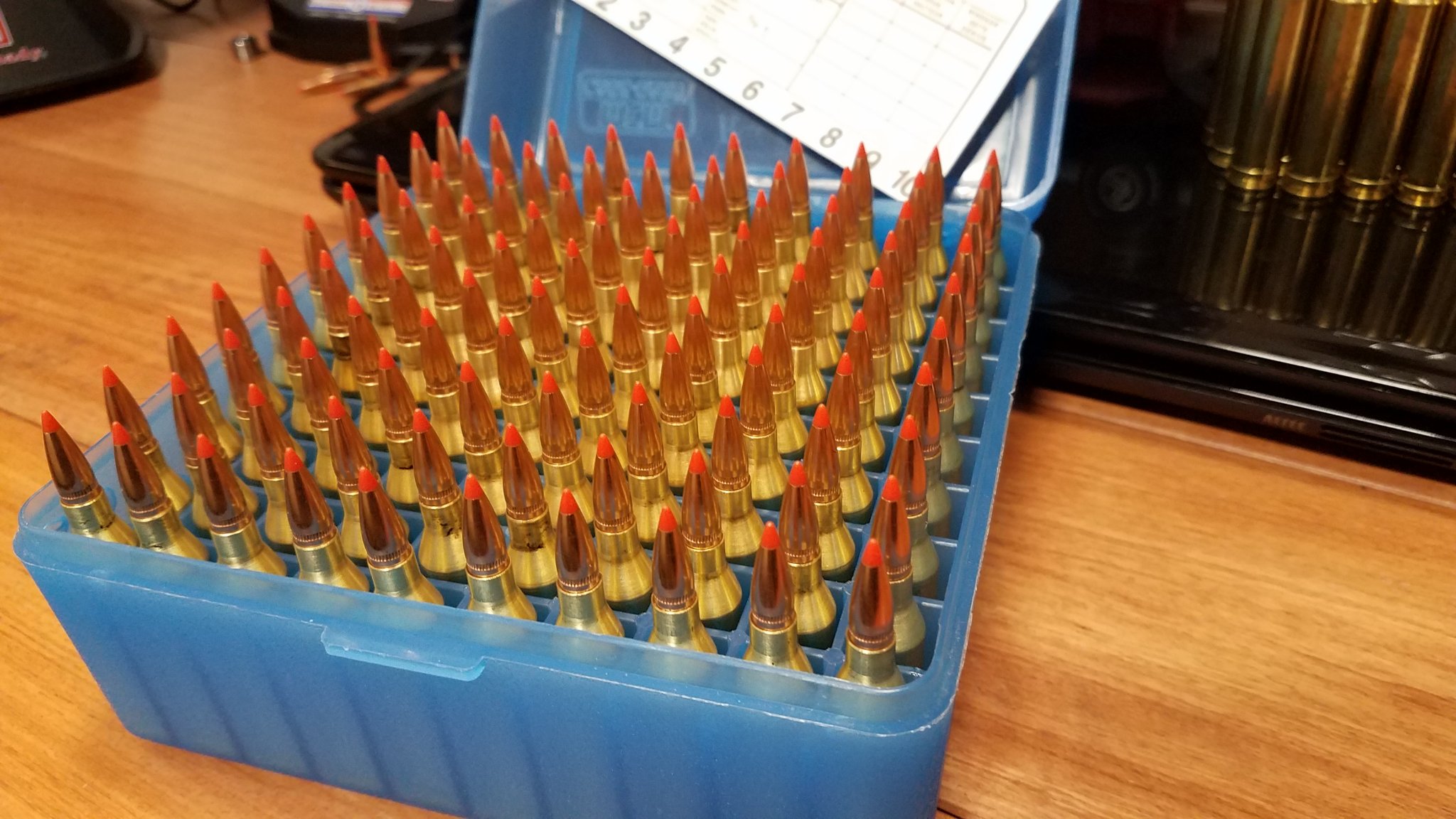

I'm just getting going with reloading. Cant say I have any complaints but I haven't gotten too many rounds loaded yet. I loaded some .243, 6.5 Grendel, and 6.5 Creedmoor. I'd say powder drop is consistant up or down .1g using IMR8208. Seems to seat quite well. Checked concentricity on 6.5 Creeds and run out was .001 or less. Still learning my way around but I have no major complaints thus far.
