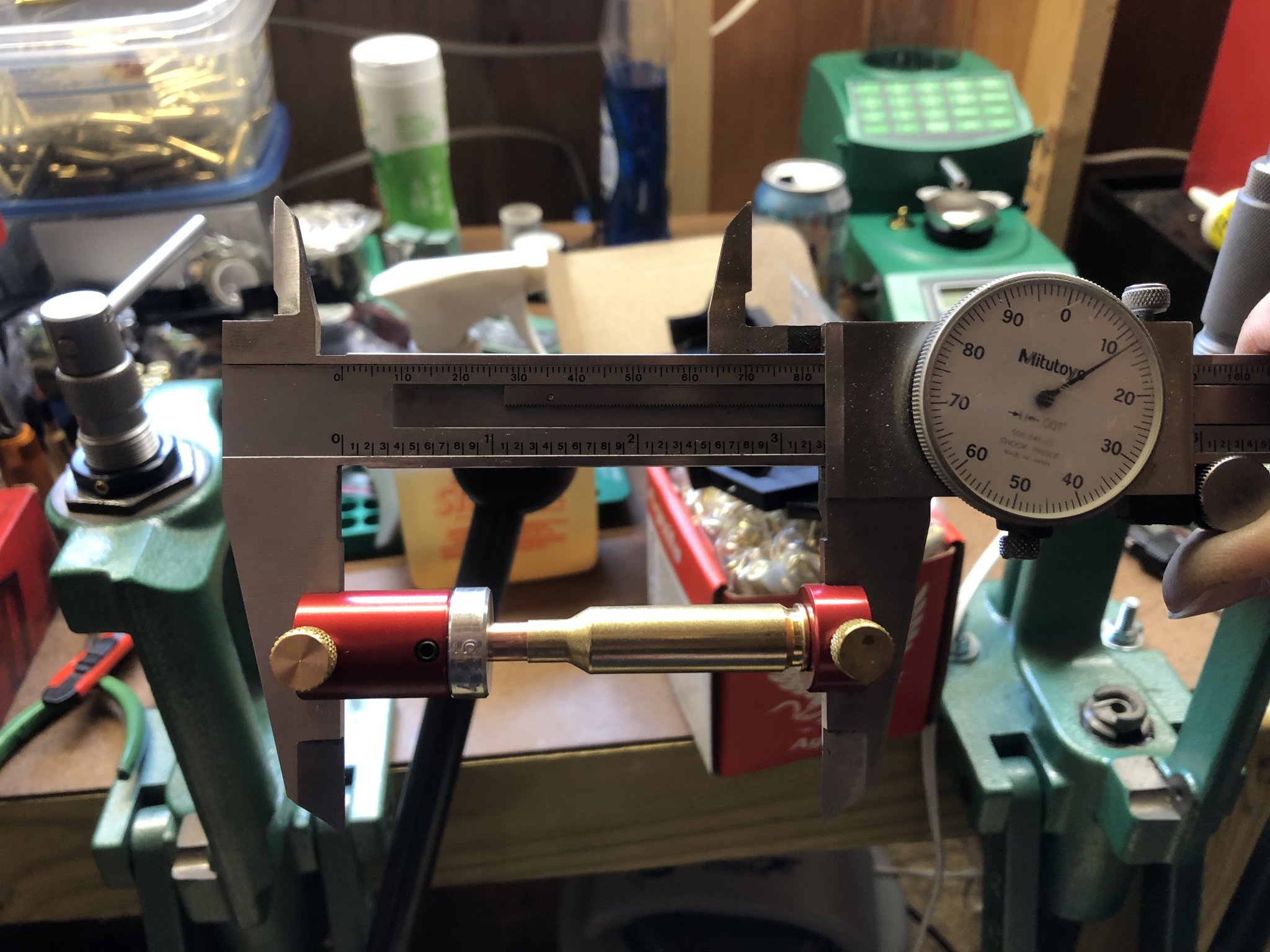

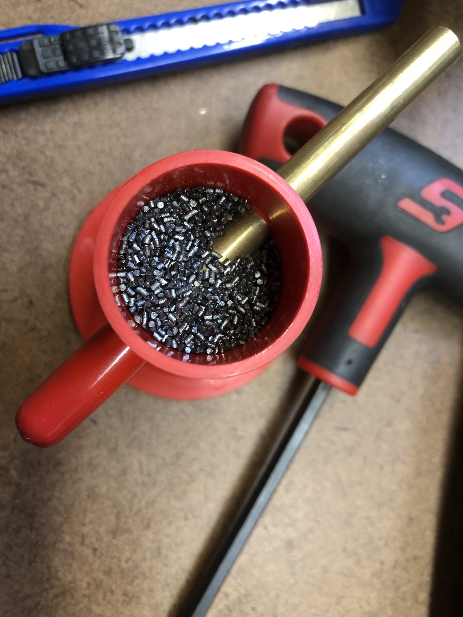

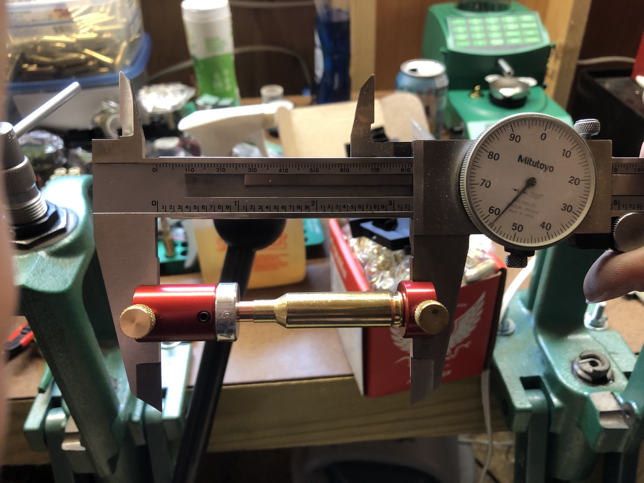

Thanks for all the replies so quick, sorry for the delayed response. I measured the headspace of the factory loaded cases at 1.554 at the fired cases were 1.558 using a Hornady comparator. As far as the distance to the rifling/free bore, I measured that using the bolt method (3.312) and the Hornady comparator and the factory loads (3.257) have a .055 jump to the rifling. I’ll throw some pictures of the powder and the difference between the measured case/bullet and the factory loaded one on here. I guess they’re just hot loads. Thanks everyone!

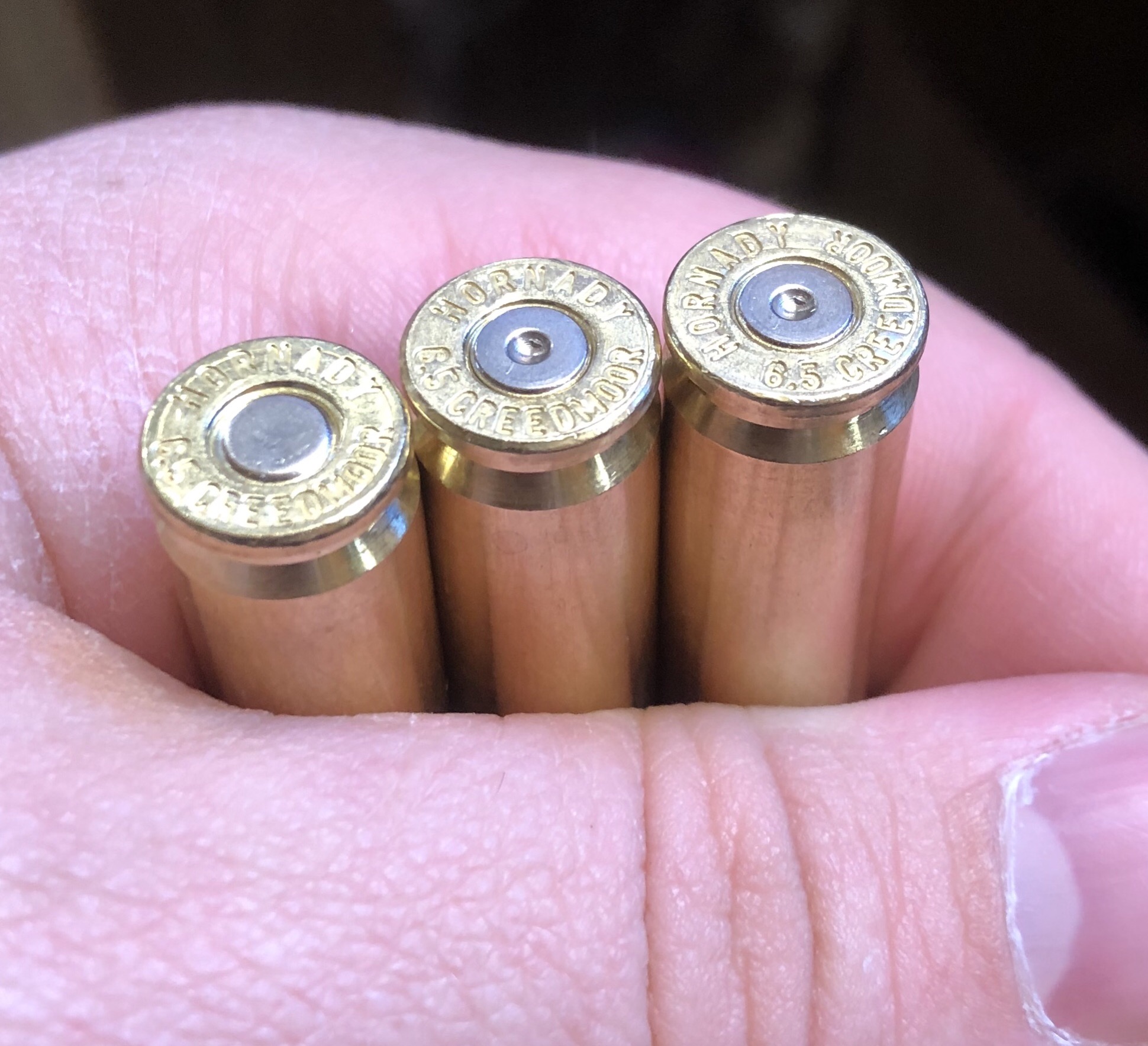

I also have a picture of the two primers I reduced the load in next to a unfired one, and like I said the hard bolt eject was completely gone with these two.
