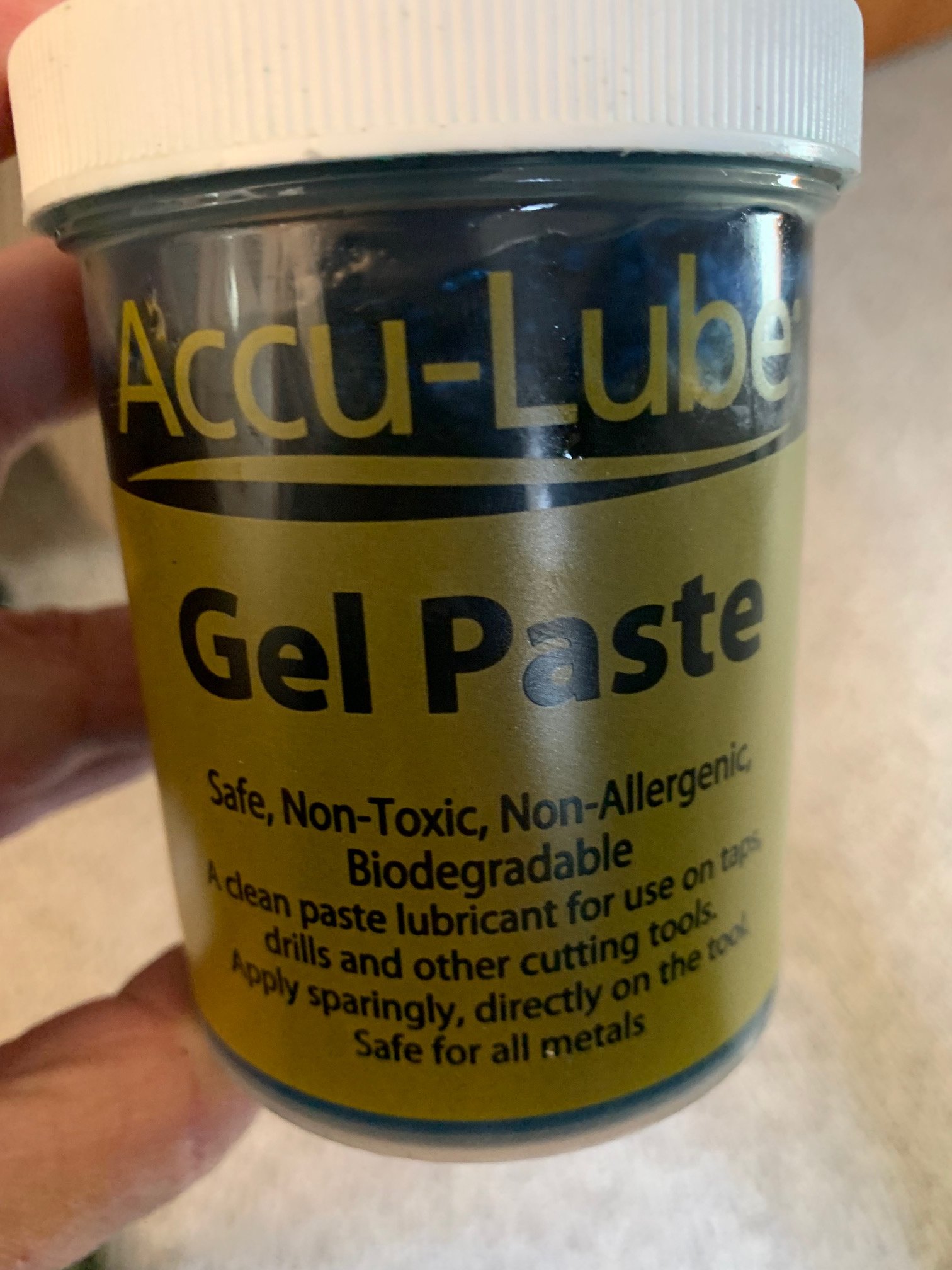

    This really works well for me, and it's not as messy as oil. Throw them in a tumbler for 15 minutes to take the residue out of the necks. I anneal after tumbling, before the first sizing.
