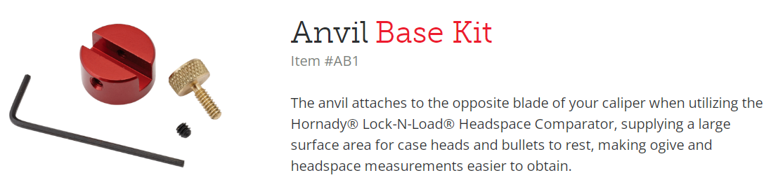

Some of this is due to the jaws of the calipers being offset to each other. There is an anvil that makes that a little less sensitive to technique, but even that tool cannot sit dead flat in line on the calipers.
