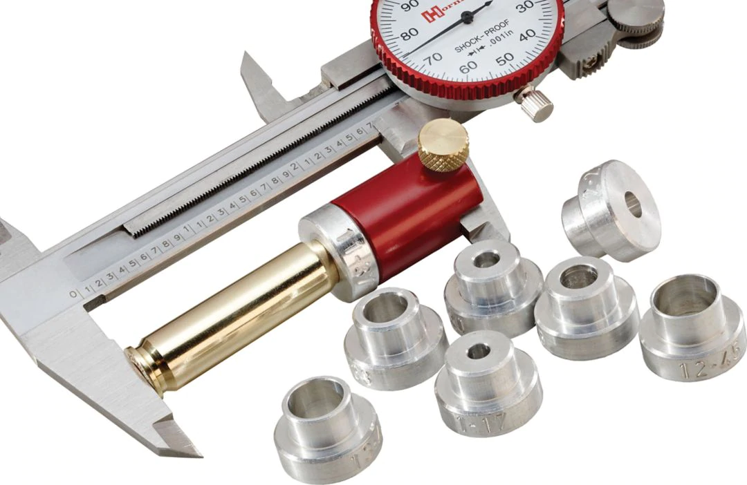

Get a hornady or sinclair case headspace comparator. It serves as a datum which allows you to measure the same spot on the shoulder consistently. You want the shoulder to get sized .003-.004 shorter than fired for an AR. Any more is just over working the brass.

Get a hornady or sinclair case headspace comparator. It serves as a datum which allows you to measure the same spot on the shoulder consistently. You want the shoulder to get sized .003-.004 shorter than fired. Any more is just over working the brass.

Thanks guys, I do use a hornady headspace comparator and just bump the shoulders 3-4 thousandths when I'm working brass that is fired from my own guns. This brass i'm working now is all range brass I bought from a guy locally and is going to be fired out of my AR-15. After this firing on the brass I will just bump the shoulders and call it good.
