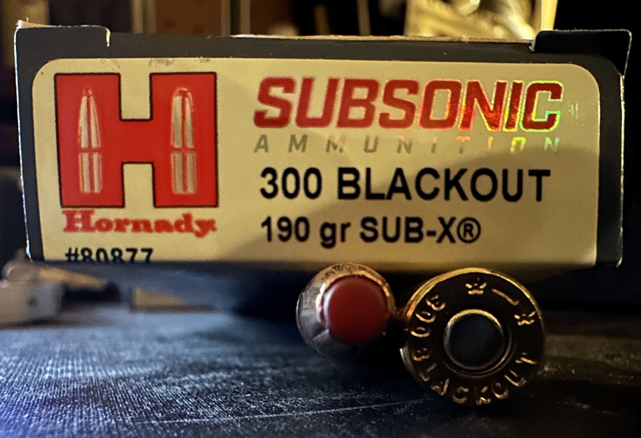

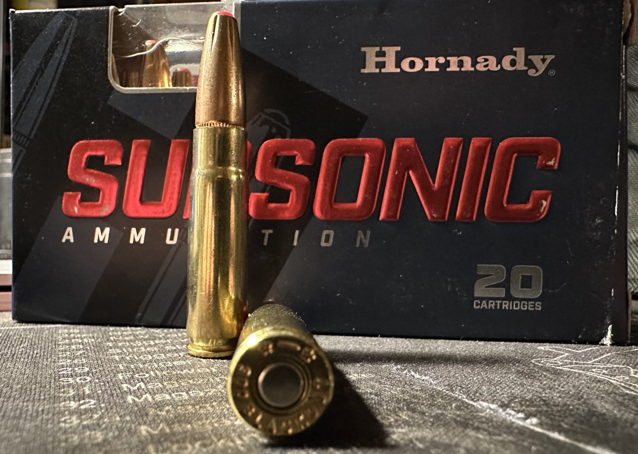

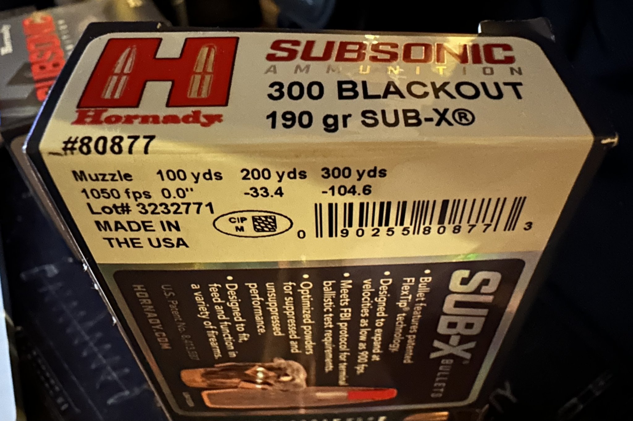

    Has anybody in here recently ordered any of the Hornady Sub-X 190gr .300 BLK factory ammo? Notably the ammo from GunMag Warehouse that they have on sale for $23.99 a box right now? And particularly from Lot #: 3232771.

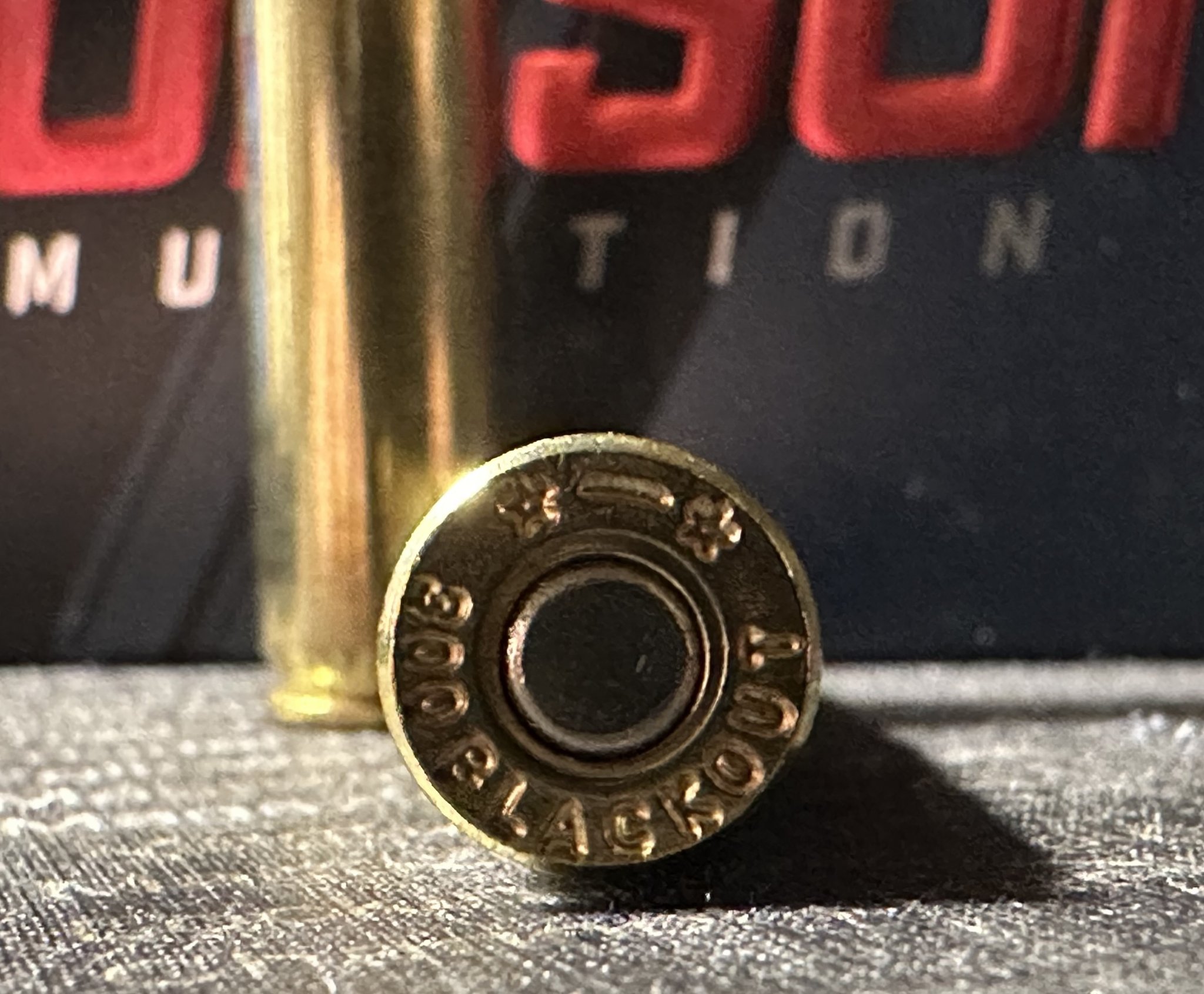

    Mine just came in today, and it was brand new, factory sealed 200rd cases still taped up from Hornady, but I noticed something odd… The ammo is NOT loaded in Hornady brass. It’s loaded in brand new Starline brass… which is widely-considered to be very good quality and consistent brass, versus the reputation that Hornady brass typically gets. Which, despite the Hornady brass typically being a little soft around the primer pocket, and loosening up a few loadings quicker than other brands, I have had pretty good luck with it as far as making consistent reloads, especially in their .308 Win Match brass.
    If anyone else ordered this, or if anyone from Hornady is on this site, I’d love to know what happened, or how this Lot # of ammo came to be loaded into Starline brass from the factory?
    Can anyone else check yours to see if it’s the same way? It’s too late to call GMW or Hornady, but I’ll call them tomorrow to find out what’s up with this. It’s all in brand new unopened boxes, and the 10 box cases were factory taped & sealed from Hornady. The labels on the boxes are not creased from having ever been opened, and it appears to be 100% brand new from the Hornady plant… 🤔🤔🤔
    Here’s a few pics…
    Update… I called Hornady directly, and they looked it up, and that lot was loaded into Starline brass. That’s cool they can look that info up. So, I guess the question is answered…Some Hornady .300 BLK ammo was loaded into Starline brass from the factory. 👍🏼

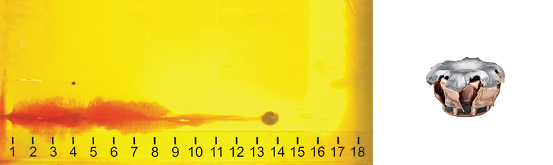

    190 Sub-X, Bare Gel

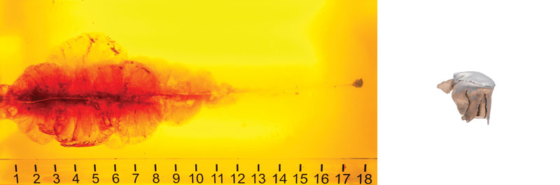

    9mm 135gr Critical Duty, Bare Gel

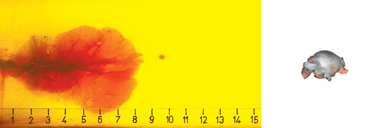

    .45 ACP 220gr Critical Duty, Bare Gel
    Tissue damage is comparable. Temporary and permanent wound cavities are comparable.

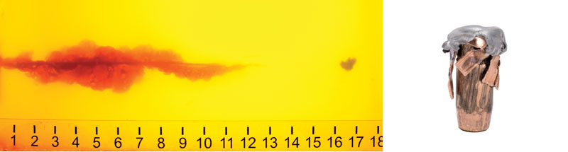

    Now look at some supersonic rifle wound cavities...
    .308 168gr Amax
    6mm ARC 106 TAP
    5.56 60gr TAP Urban
    Lots of damage, lots of tissue bruising and displacement.
